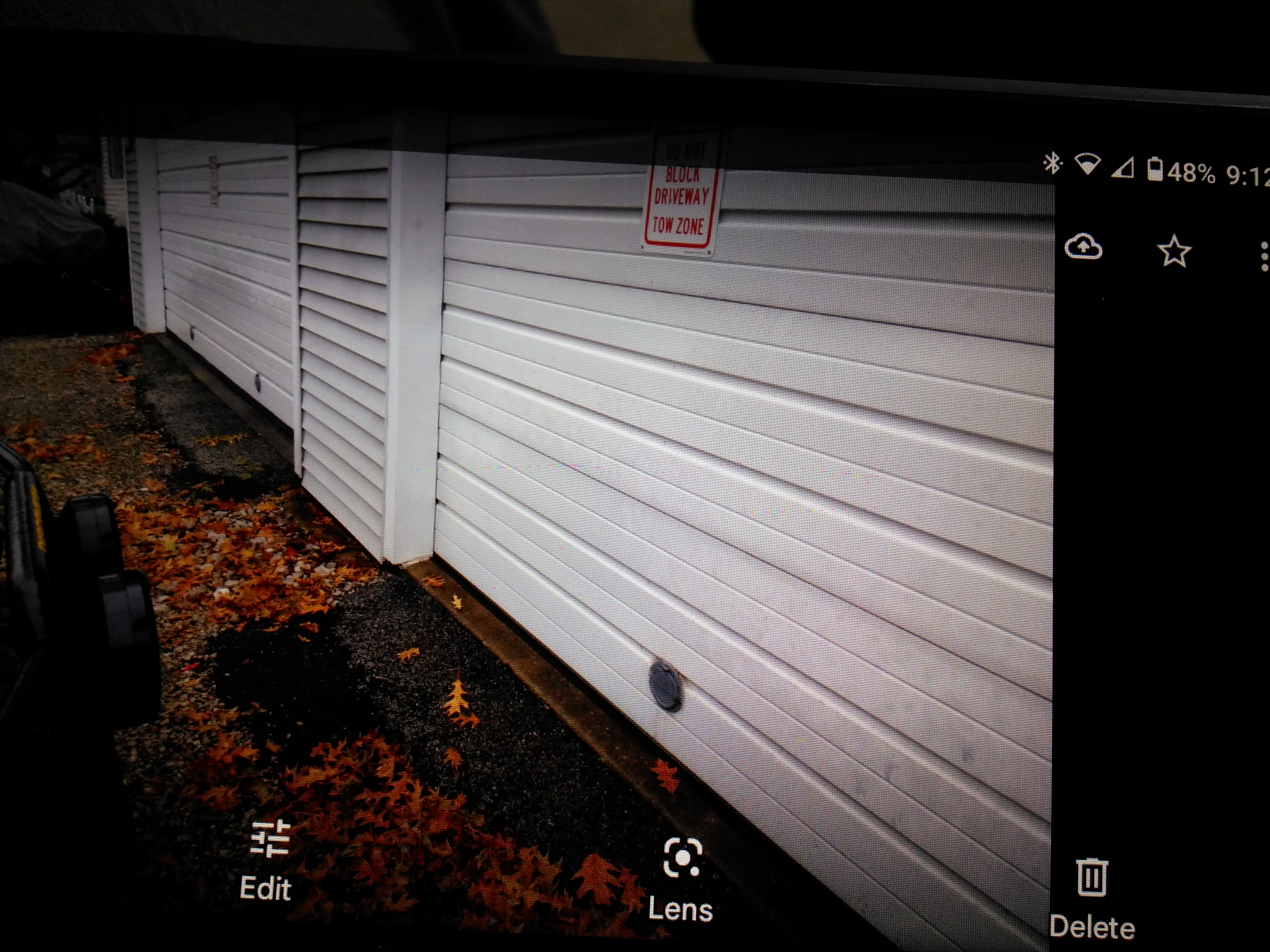

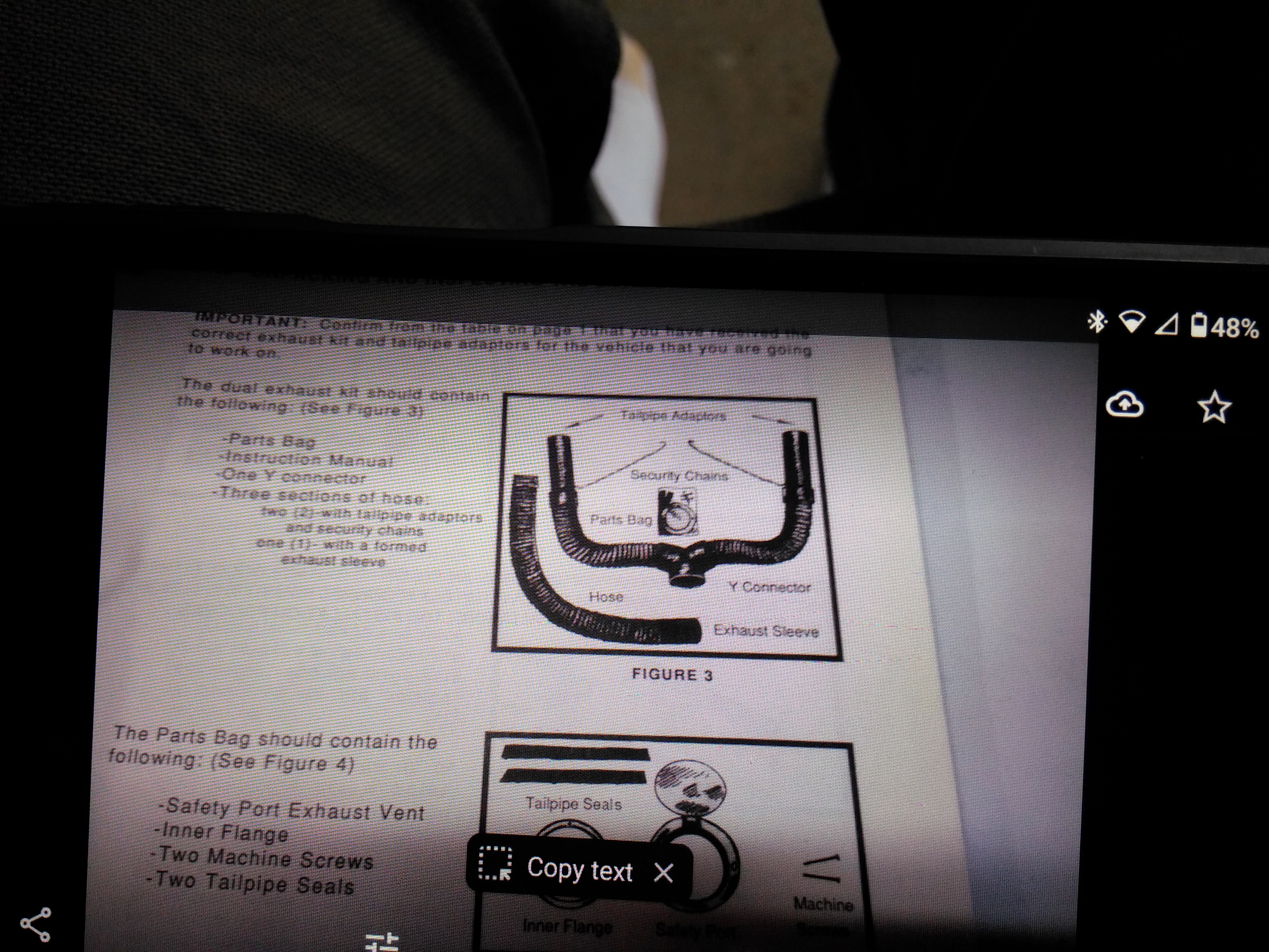

Excuse the bad pictures,but got to it as fast as I could. I believe I got this from JC Whitney in 1993 when I built the garage. Was not real expense but keeps you and the family safe. Seals around exhaust pipe and vents out. So, if the garage is attached to the house is safe to run older vehicle without fuming the house. I do not know if they are still in business, but I know these are still available to commercial shops and can be installed by the diy person. I have the dual pipes and single pipe. Heavy rubber and hangars to attach to vehicle. Dryer hoses and bilge hoses not good, they are for fuel fumes,this will run a sealed exhaust out the door. As I cut the hole thrundoor, I used the foam from the cut to seal inside when not in use.
