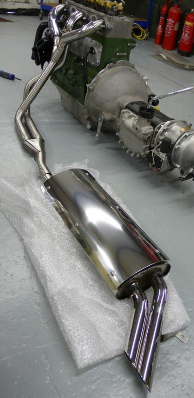

I too have the Moss Tourist Trophy stainless system, I don' t prefer the polished look but the sound is totally Big Healey

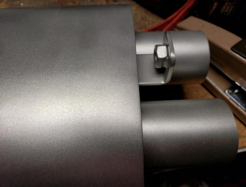

Today I installed a warranty replacement Moss Tourist Trophy muffler. Nice tone and not too loud.
My original one was very loud with a nasty resonance in the 2200 - 2800 rpm range (exactly freeway cruising speed).
Tomorrow, I'll compare the sound to that of a brand-new British mild steel muffler from Healey Surgeons as installed on a friend's car.
Moss had a QA issue with internal failures of the original TT mufflers causing them to quickly eject their packing. Their new version is made by a different supplier and is warranted for 5 years from date of original TT system purchase. It comes with a very nice matte blasted finish.
Steve, is that a replacement for a stainless steel system? Wonder why Moss went with a matte finish vs. the chrome like polished finish for a replacement?
It's the replacement for the shiny Tourist Trophy muffler. The finish is OK with me - I didn't care for the mirror finish anyway. Maybe I'll paint it black later on.
Just burned out a 2nd set of TT mufflers from Moss. Both sets were polished so maybe the 3rd set will be matte. If these burn out I'm going British Stainless Exhaust.
