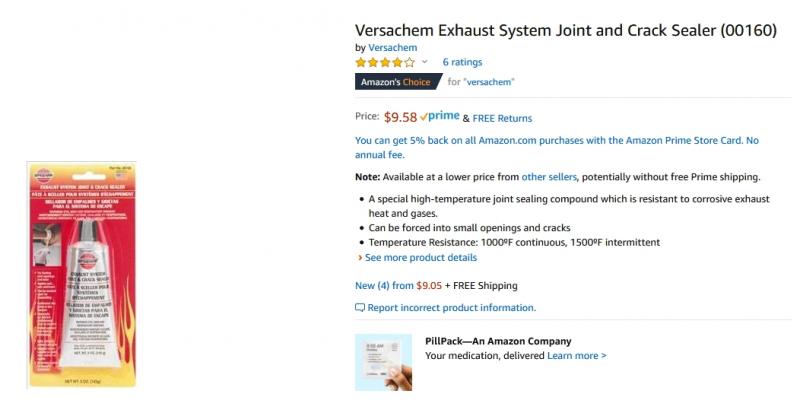

re #3) Versachem works well if you clean the joints first. 1000*F continuous, 1500 intermittent:

Steve, that looks like good stuff, but it has a couple really negative reviews; I guess it worked for you? I'm still searching for the blue stuff Edd China always used on exhaust joints; if it's good enough for Edd ...

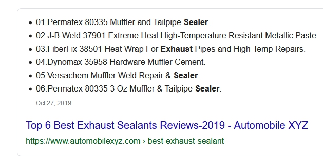

Bob - I'm still looking for the perfect goop. Maybe one of these is better.
Google searched for "best exhaust sealant":
One thing about the Versachem is it comes in a larger tube than the Permatex.

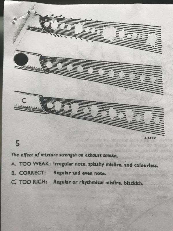

Would having exhaust leaks affect carburetor tuning?
Might air leaks affect this reading?
Leaks will not affect power or gas mileage?
Seems I've never been able to get the mileage other BJ8 owners say they get.
It sure would be swell if low mileage was as simple as addressing exhaust leaks.
