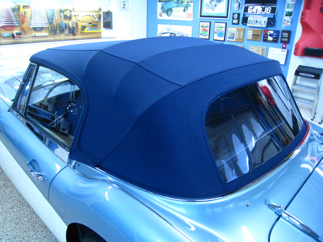

Time to change the original natty top on my 67 BJ8, but torn between the oe everflex and
the stayfast canvas. Original vinyl or improved cloth? The upholstery shops are all favour the
stayfast over the vinyl. Anybody have experience with the stayfast? How does it look?

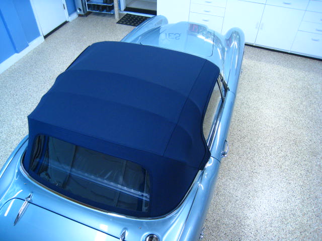

I also have the canvas type. I have not found the maintenance to any different except that I have to clean it less often. Dry microfiber to dust off. Lint brush to remove pollen. I love the look and have a tonneau of the same material. They make cleaners and other products to keep it looking new but I have not needed anything in two years (yet). I think it is quieter when driving, too.
thanks for the great feedback (this is what a good forum is all about).
Chose the canvas type .........now the fun starts.
