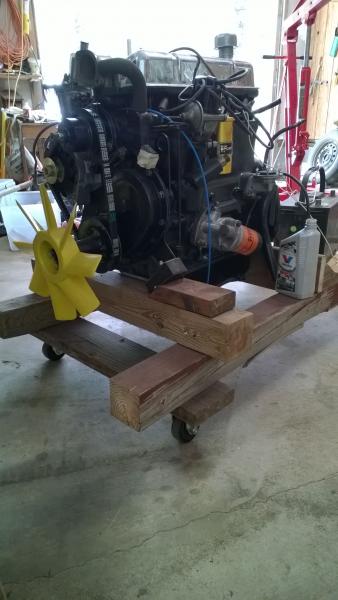

This is probable over kill for a trip across town. I built this stand so that I could run the engine and also have the gearbox attached. It makes it easier to move it ariund as I work on the frame and body.
It is built from scrap 4 x 4s
