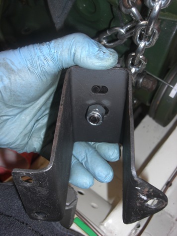

Another tip, is do not reverse the mounts side to side and up side down. The bolt for the motor mount is on the bottom, and there is a notch on the front side for the steering shaft for both right and left hand drive. The photo shows a mount for the driver's side (left-american).
