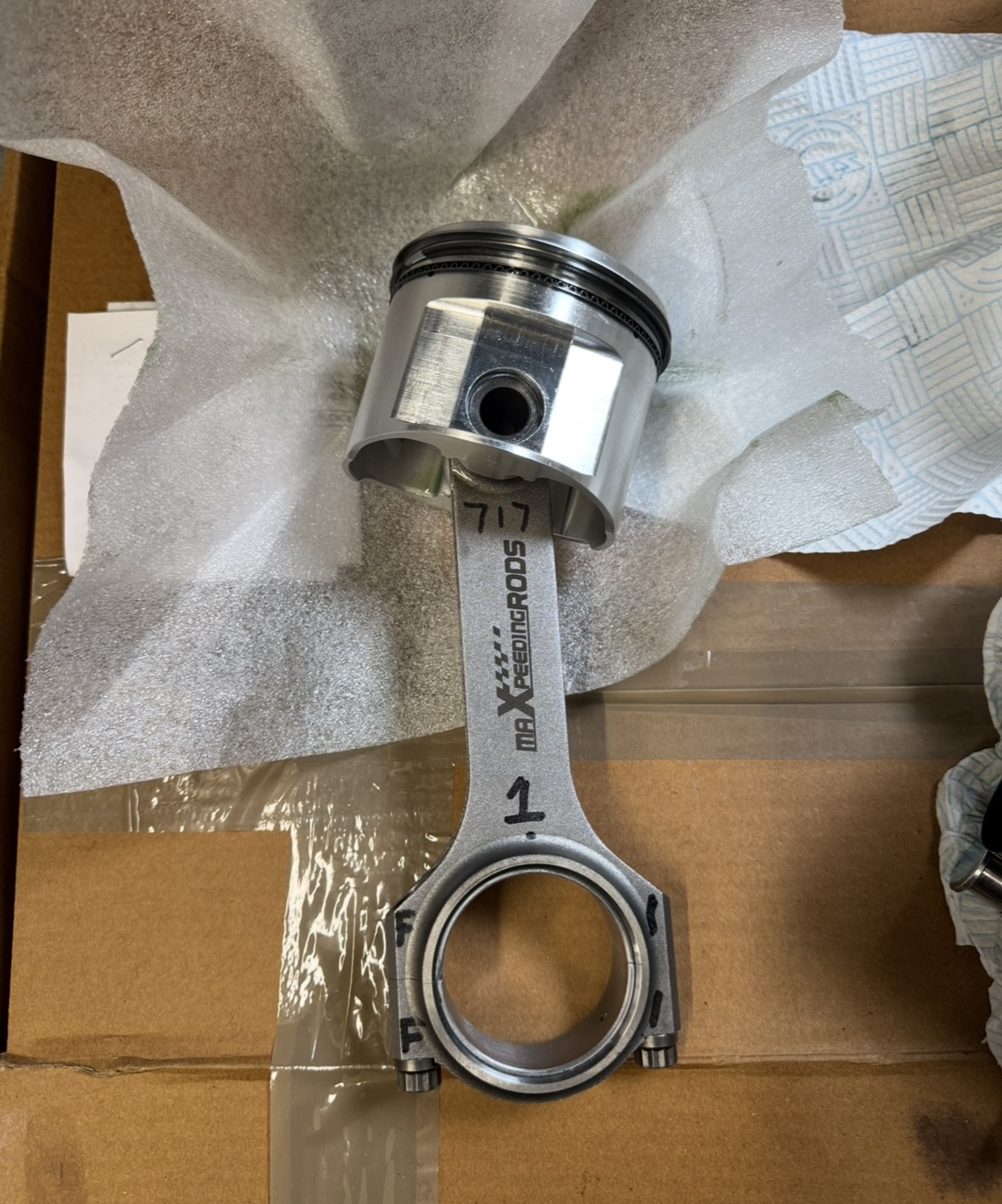

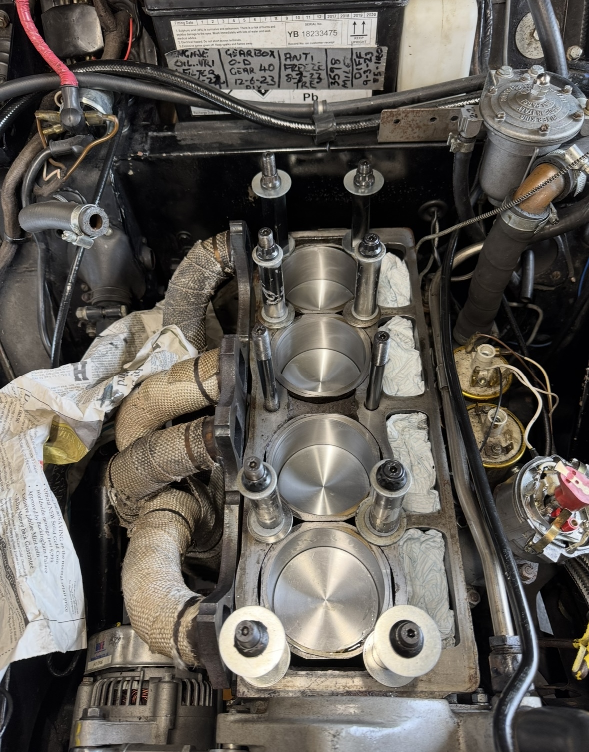

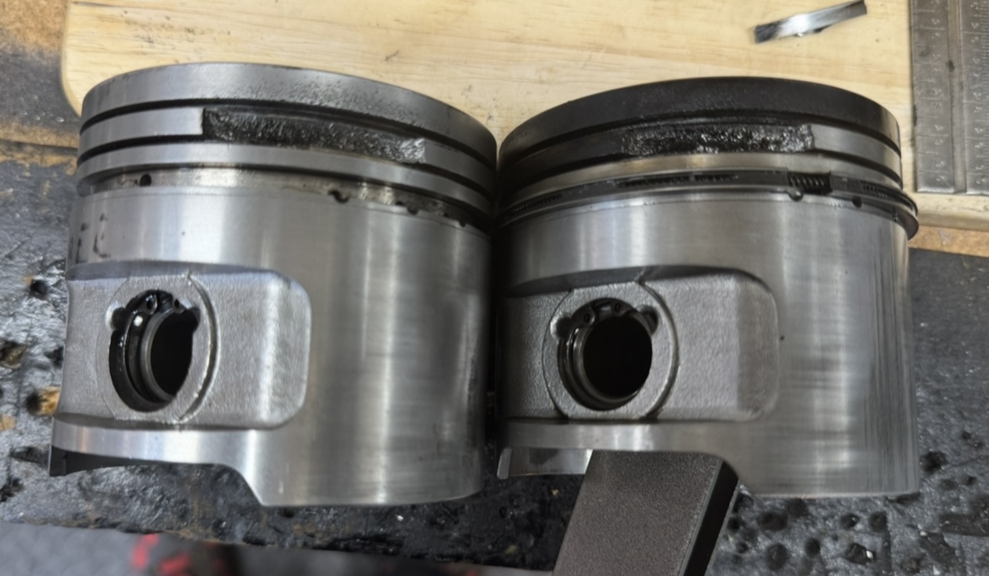

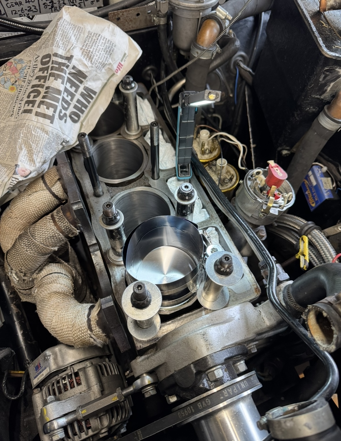

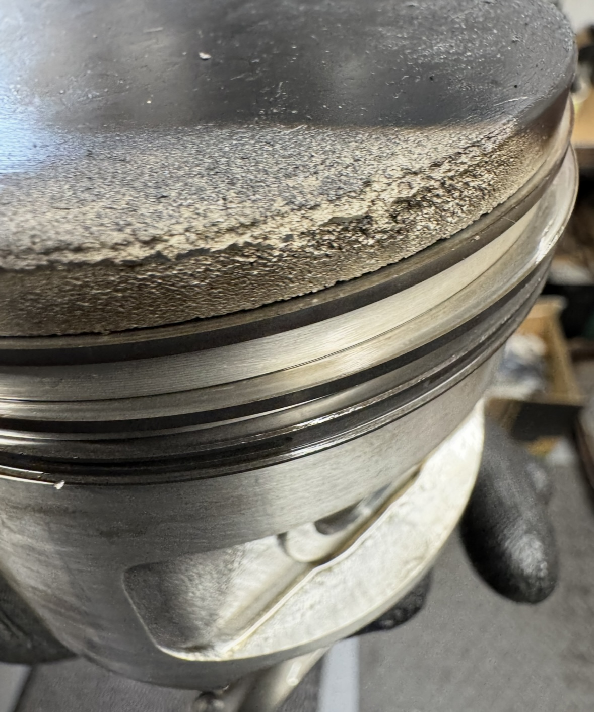

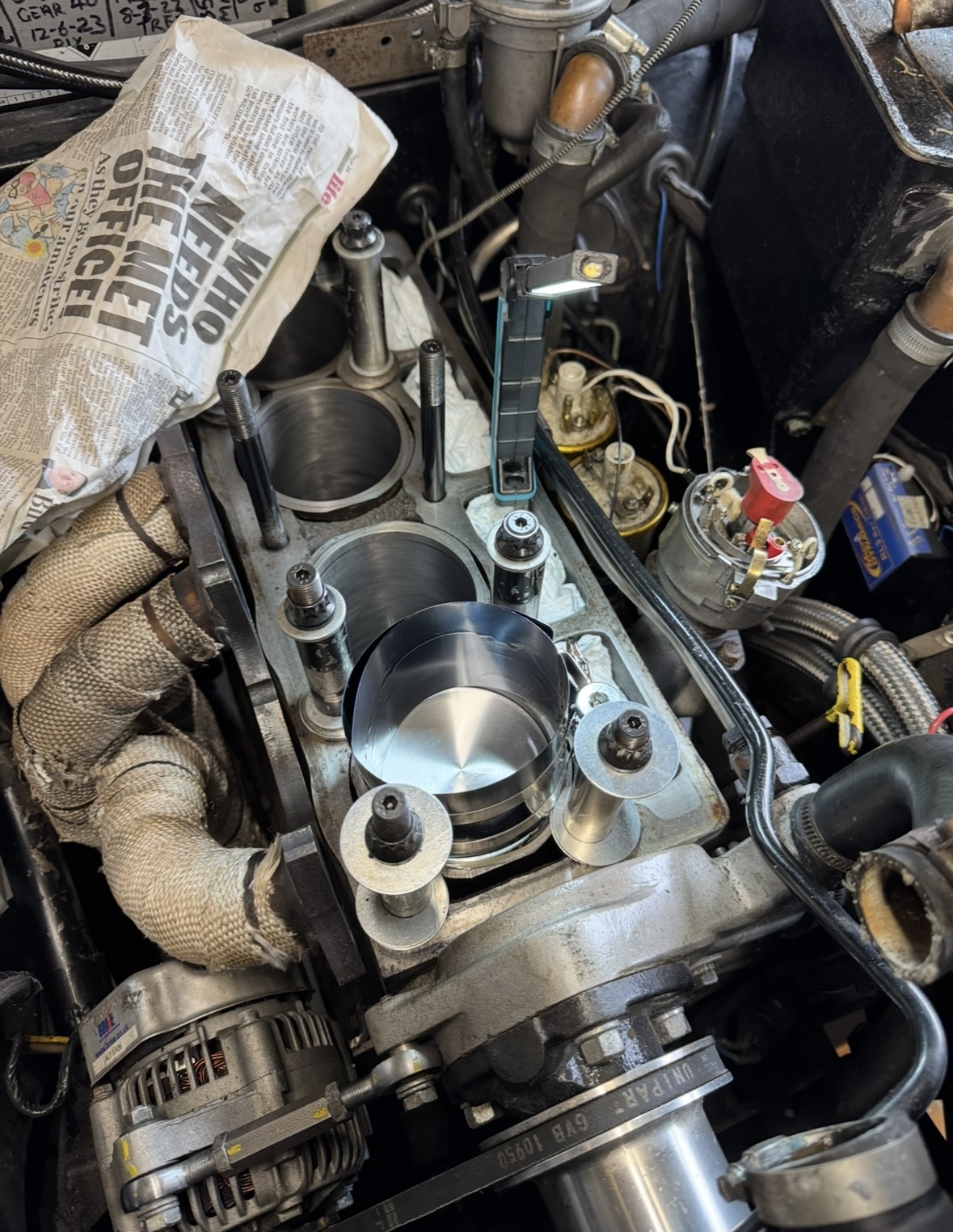

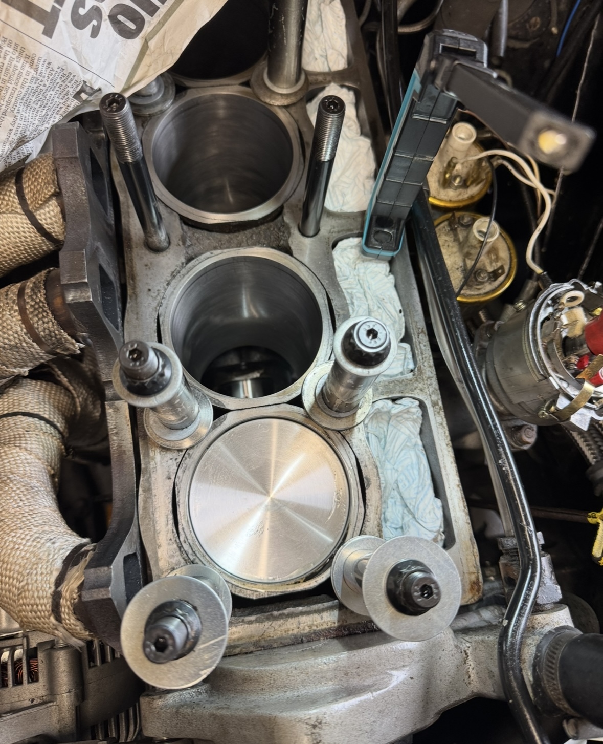

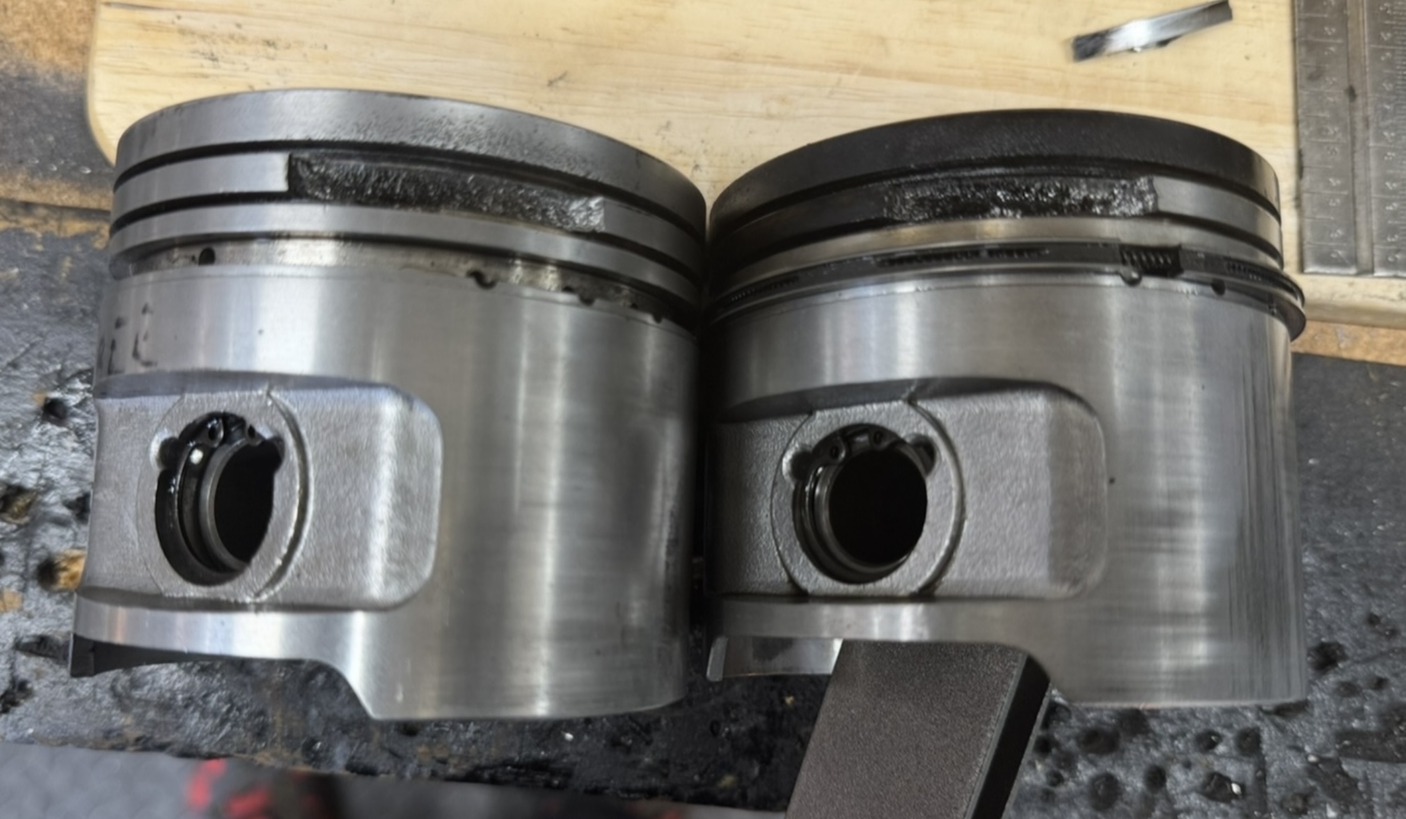

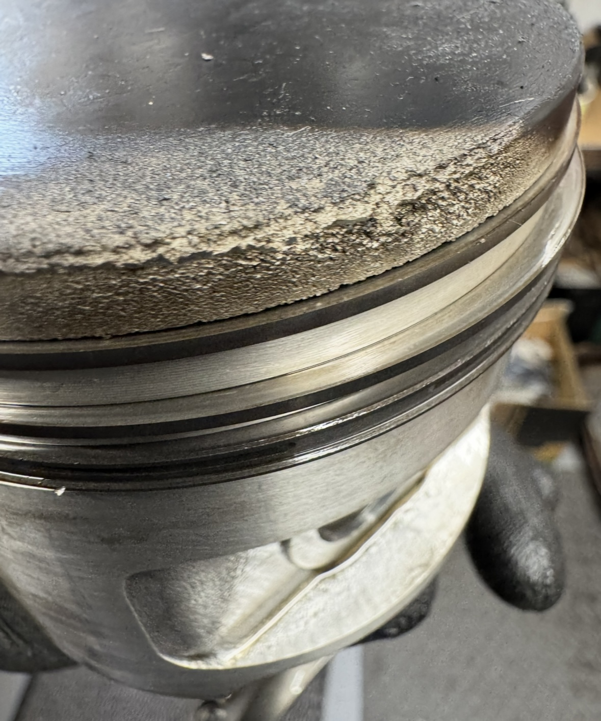

After a couple pistons decided to break up a few months apart I have decided to replace them. The conrod are now 3 years old and have performed very well.

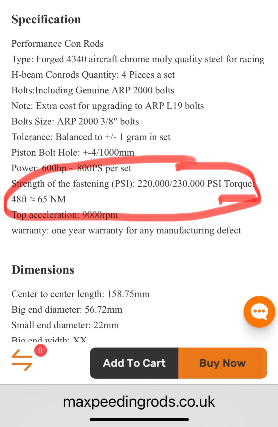

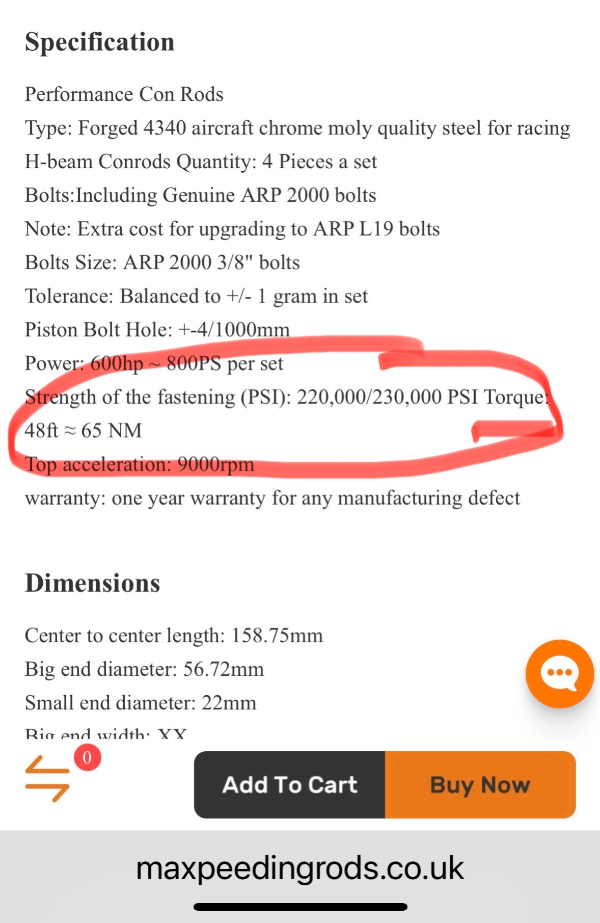

Glad its just the piston lands and no further damage. Can you tell me what torque you use on the conrods? MaxSpeeding rods don't have the best documentation.
Thanks! The TR6 rods use 5/16" so torque is quite a bit less - also scary for me as I don't have a strain gauge, don't want the bolts too loose and don't want them too tight! I've settled on 29 ftlbs, less than 32 ftlbs which ARP quotes but more than 26-28 which is what I found on the MaxSpeeding rods website.

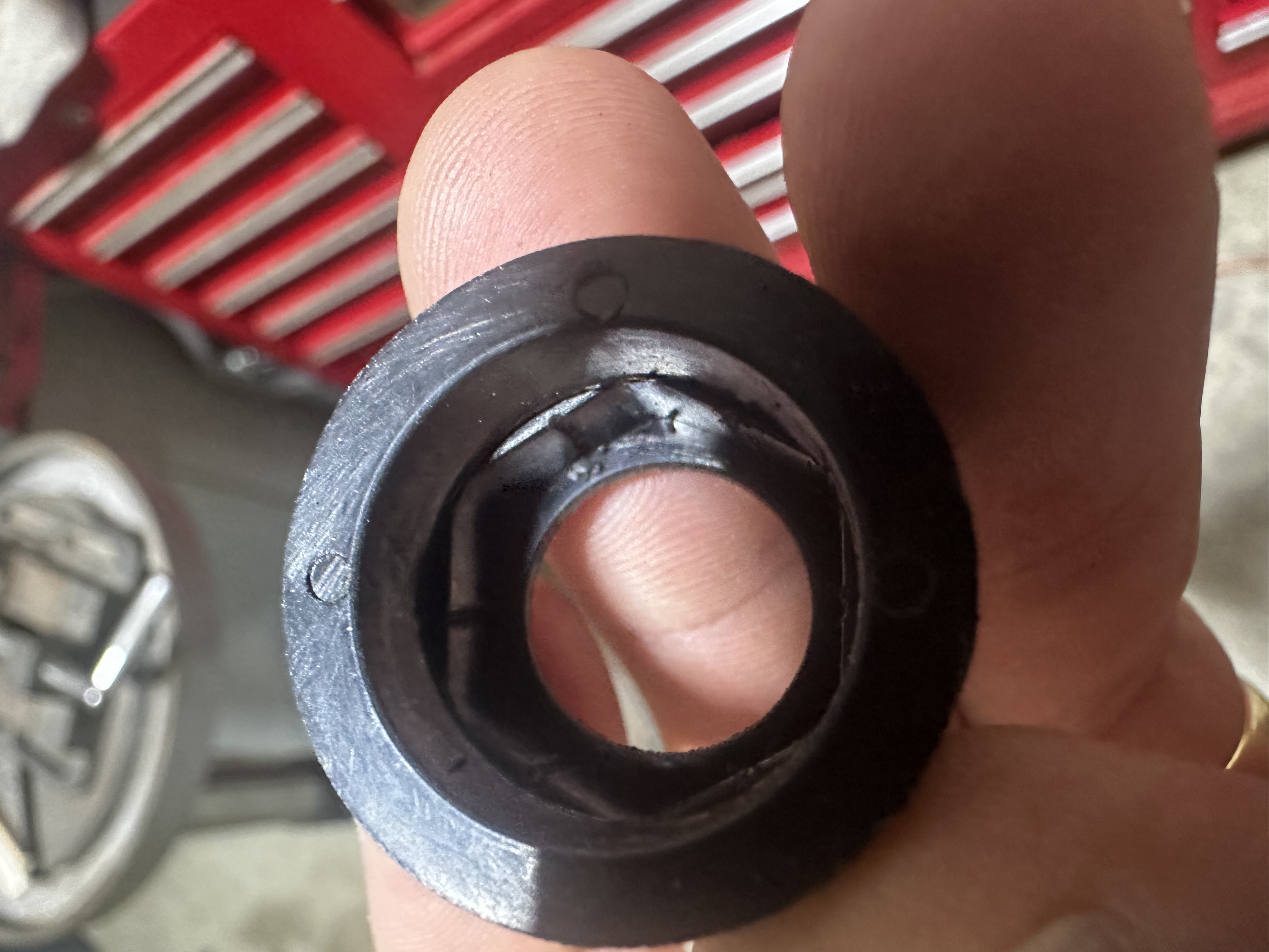

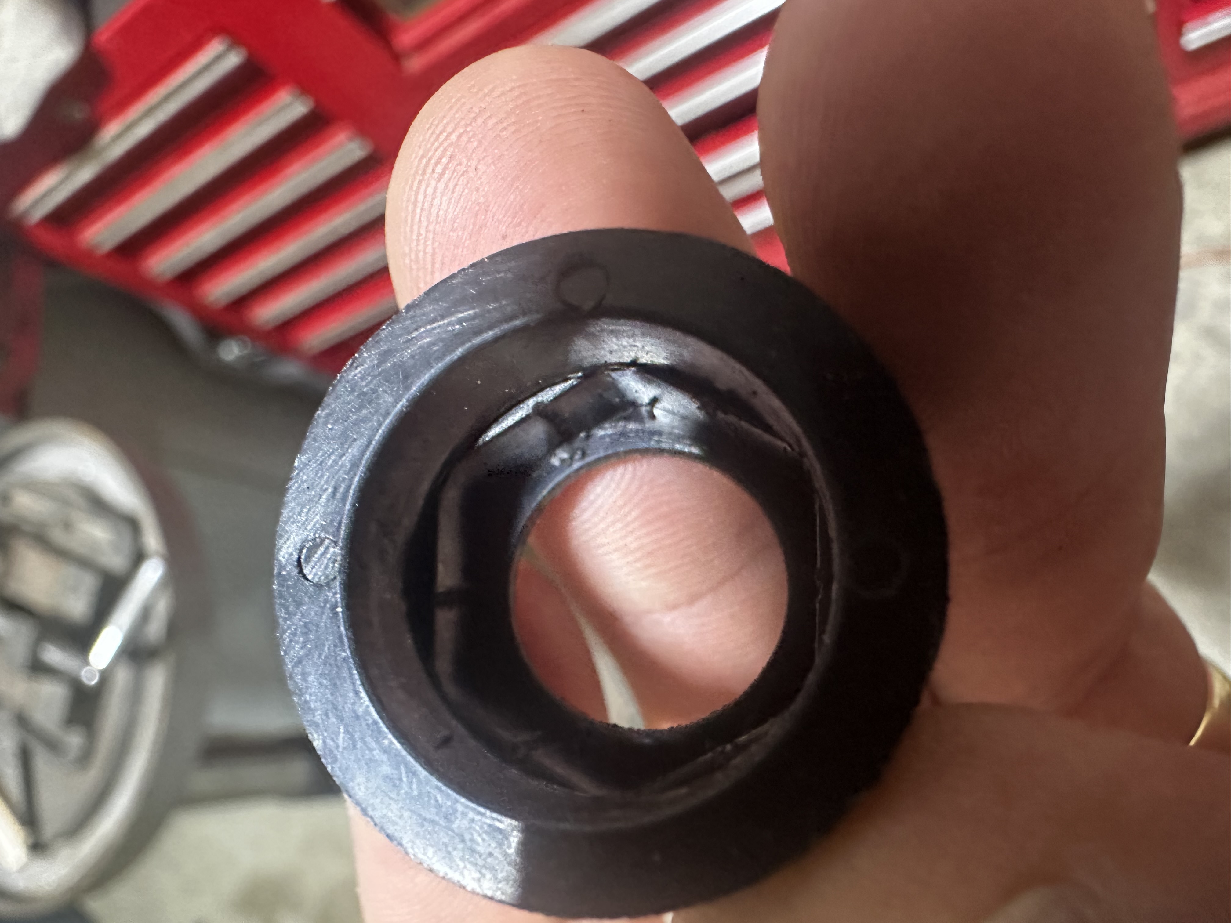

I dug this one out of my spares - you can see on the one I have the nibs at the center of each hex face are flush or nearly flush. Yours aren't. I'm guess that is why you can't push it all the way home

Nice Picks Hamish. Leaving the crank in is the beauty of these cars. I have done it that way and the engine came back to life just fine. I have no insight of why the piston broke, and I am looking forward to hear what is said.

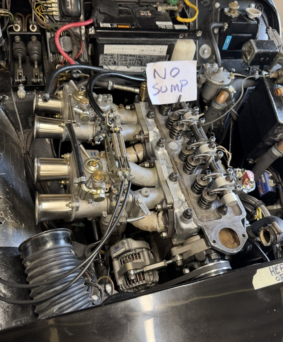

Do I see 2 coils? Is the one coil a spare? Moreover, are the larger hoses for water circulation?

The conclusion from wiser people than I on the piston break is
A. Over revved (6250rpm Rev limiter
B. Rings too tight ( not sure on this as they did 3+ seasons
C. Just used up the strength and durability capacity on what are essentially road tune pistons
I think it’s a combination of A and C

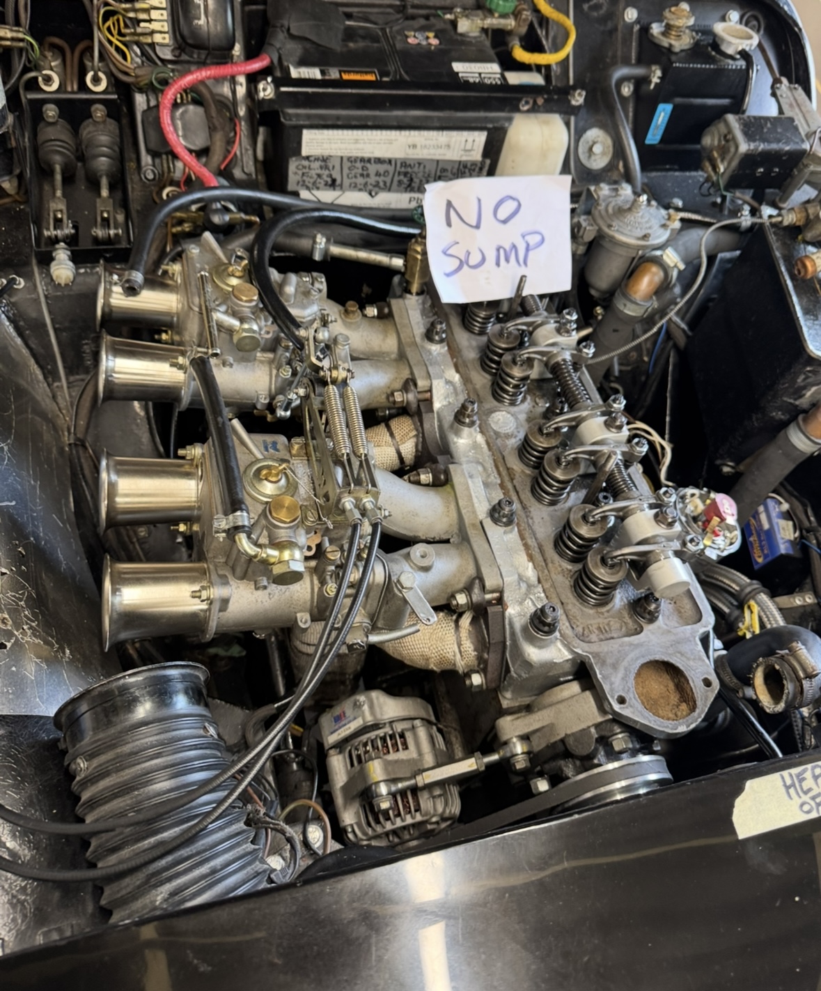

Yes 2 coils - one is a spare
Big pipe on left (with copper bends) are my crank case breather into an oil catch tank and a vent out of this tank. There is a smaller bore breather from the rocker cover.

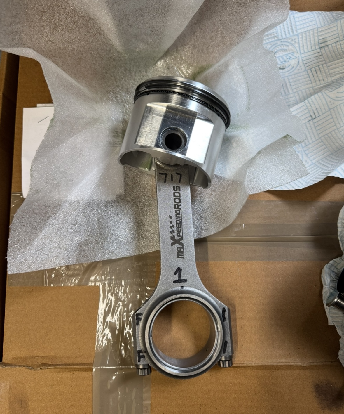

Certainly use the MaXpeeding rods they are great. New big end shells and the little end shouldn’t have much wear so the wrist pins should fit.

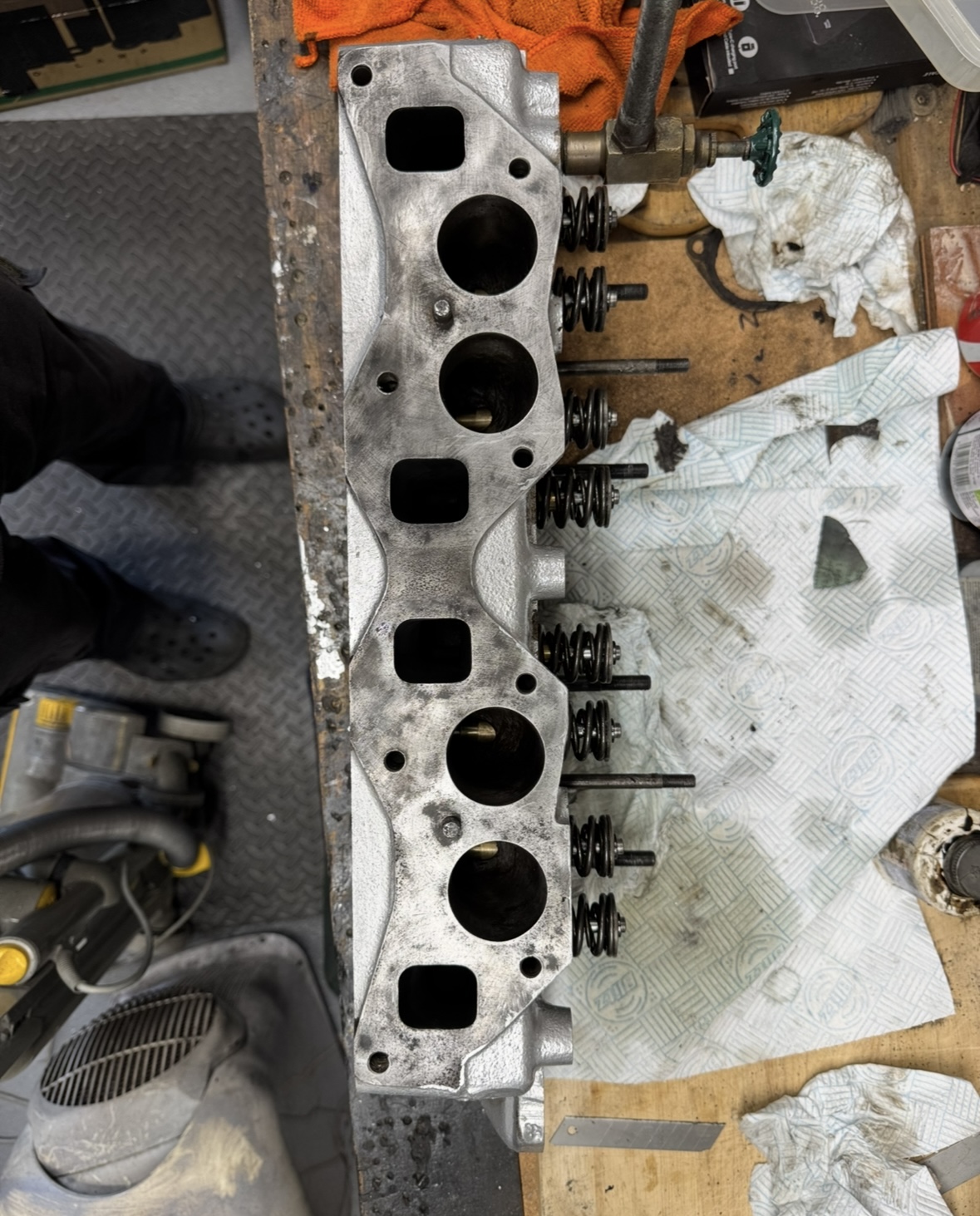

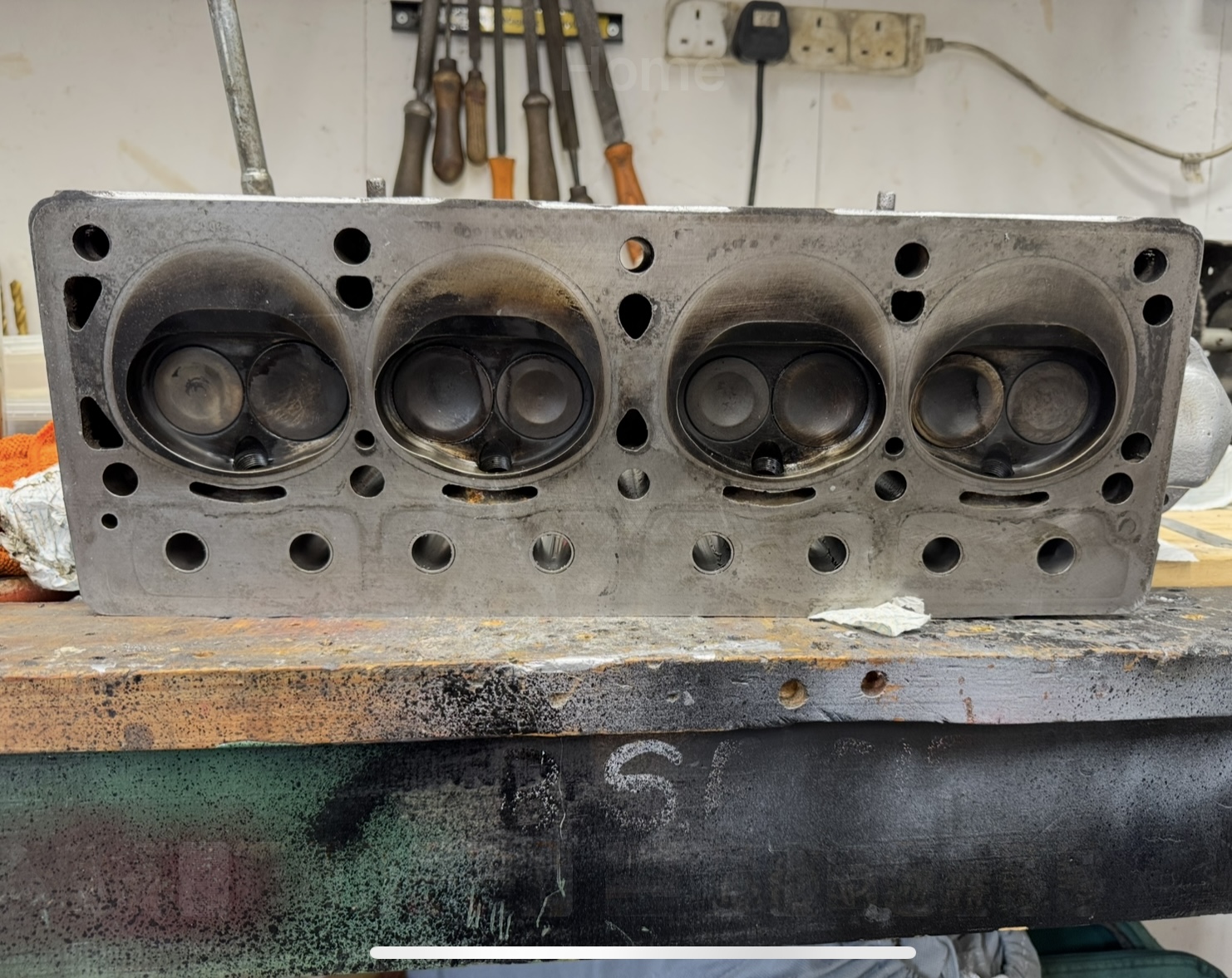

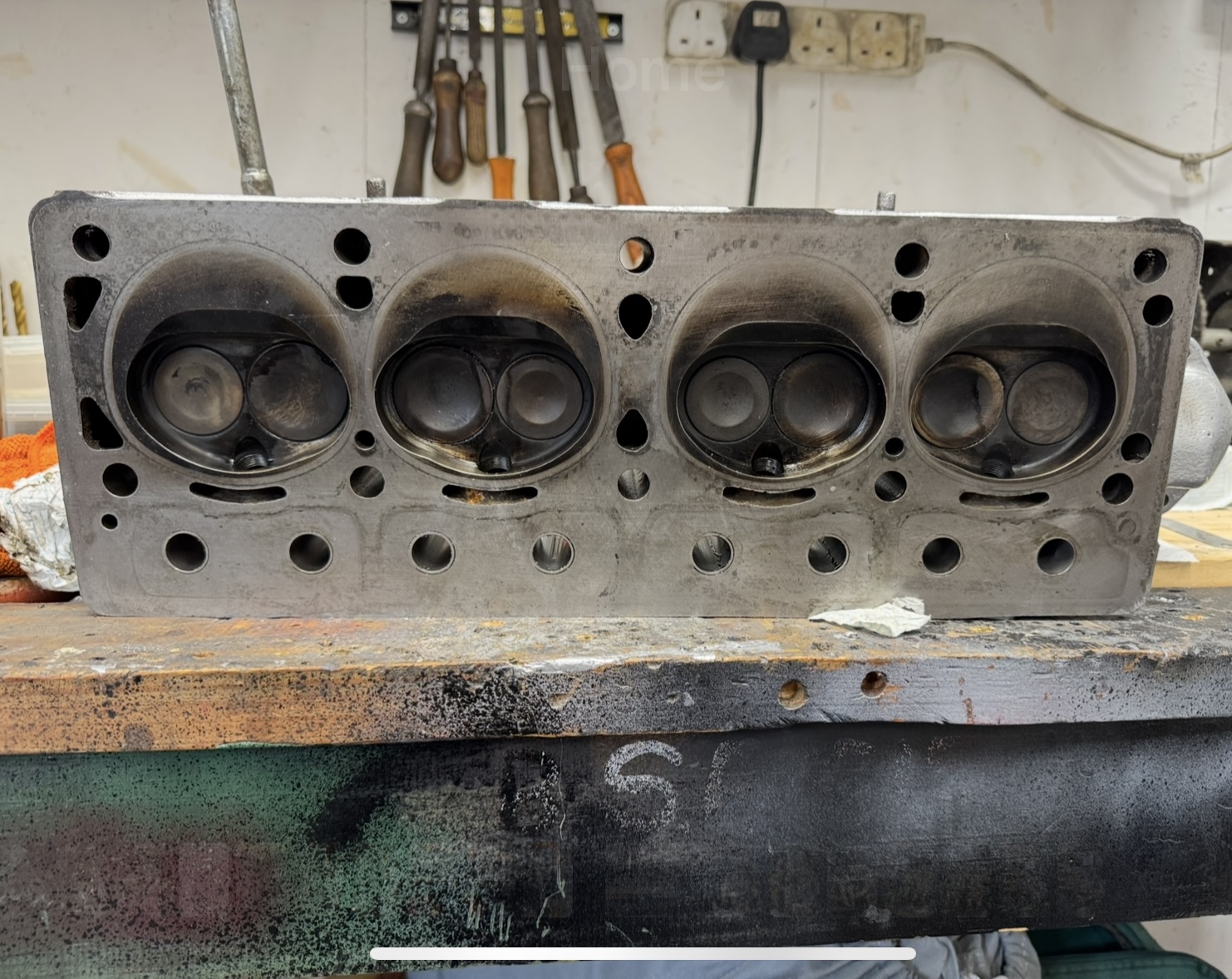

My head has been worked on for gas flow with bigger valves and ported.

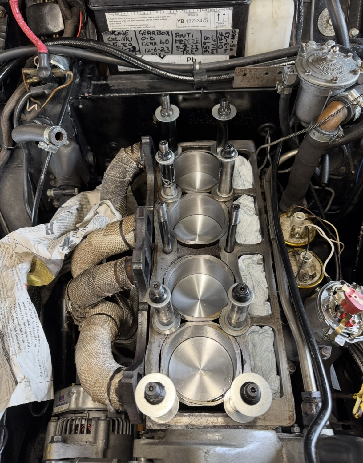

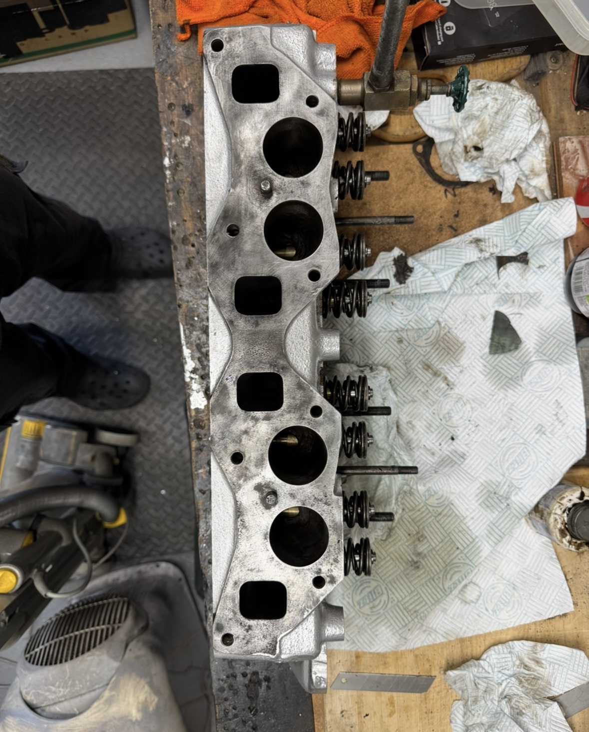

I take the inlet and exhaust studs out to aid head removal as my sports exhaust manifold won’t move clear of them. To aid stud refitting I put a simple cut across the end do I can screw them back in with a screw driver. With a little copper grease on the threads.
This is later on with the exhaust and carbs fitted.
Yet to fit sump and set tappets/valves and fill with oil and coolant.

If the rings were set to tight, you would have noticed a loss of power and increase in engine heat as you warmed up on the long straights. Also would have caused worse problems shortly after installation...so not likely this far down the road.
I doubt the overspeed hurt the lands, so my money would be cast pistons and occasional detonation. Forged would survive a bit longer, but same result eventually.
I have skimmed the pistons an extra 5thou to reduce compression a bit. And I’ll check timing.
But I’m sure the ring landing went first and then the detonation started as the only piston damage from detonation is only on the one with ring landing damage.
No pinking or any signs eg smoke but perhaps that one pot was running like a 2 stroke ?
It ran very well with the piston landing damage just like the end of last year
