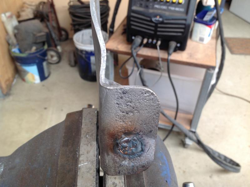

Is the front engine plate completely flat. Mine is slightly bent at the right hand engine mount. (Viewed from the front of the car) Could be damaged from a collision because it looks like the bend extends into the area where the timing cover bolts on. Looks easy enough to press flat if that is how it is supposed to be.

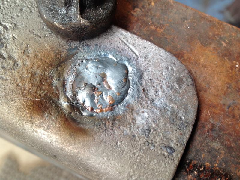

As an aside, someone has previously enlarged the holes fot the engine mounts with an oxy acetylene torch. Had to refill them with the tig, grind back with a flapper disc and redrill the holes.

Yes I believe they are flat also. There is a spot where the timing chain tensioner rides and in that area a grove is often cut. The fix is what you did with the holes in that you fill it in and grind it flat. Plus many times the little hole for the stud that holds the timing tensioner is striped. I think it has like 3 threads and the stud should sit perpendicular to the front plate or it could rub the tensioner uneven. Those tensioners can be fickle and when they act up the repair is a deep dive to fix them.

Thanks for the confirmations gentlemen. I will just put the plate on the press and should be able to iron the wrinkle out.
Aluminium sounds nice Randall, but this is definitely low budget work and very little new stuff other than absolutely necessary or what I can repair or fabricate myself is being used.
