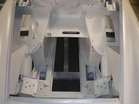

I cleaned up the garage enough to make room for the hoist.
The motor and tranny are coming out to be replaced with a 5-speed.
While I'm in there......
What else should / could I be doing?
The motor is in fine shape, so I don't need to worry about that lump, I was figuring replacing the motor mounts, but can't believe I'm coming out of this too easily, there must be something else?
TIA!

Well.....
Baz said:
I'll be more than happy to fill that beautiful engine bay up Tony; as long as I can keep it..... :jester:
Wait'll you see it with red paint!
But, it answers the basic question.
