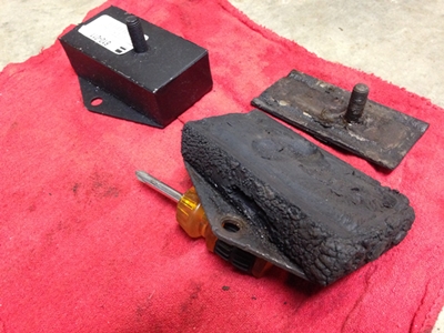

I used these "uprated" mounts (from Moss I think
In comparison to the old ones, (which may have been original) the new ones are not nearly as durable.
in particular the mounting base plates were about 2/3 the thickness of the originals. They fit just fine, but I don't think the next owners will get 50+ years out of them.
