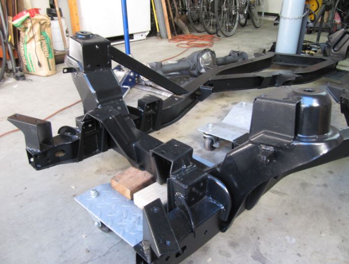

A couple simple questions:
1. In the TR4A frame, there are two holes where the engine mounts could be installed. When I tore down my TR4A, the mounts were in the rearmost set of holes. Is that correct?
I ask because there were some indications that the engine was too far back--but if it were, I think the holes in the transmission wouldn't line up with those in the trans mount, correct?
2. I noticed there are two mounts used in TR4s and 4As: a round one and a square one. My car had the round mount, which I assume was the correct one. When were the square ones used?
In other news, my frame is now finished and I have started mounting parts on it. That's a milestone, I think!
I believe the rear hole is the correct hole; this is how mine was. I have not put my car back together yet, but am not sure there is enough play in the rear axle, driveshaft and motor to allow the "wrong" hole to be used??
I used the rectangular mount, as that is what I had. Not sure what is original to the car / correct. The spare parts catalog calls for p/n 130985; the round one sold by TRF. Moss claims round is for TR4, square for TR4A, but not sure how correct that statement is, given the spare parts catalog calls out the round.

Thanks for the response. Probably won't get any more, but it's good to have some confirmation on the mount location. As for square vs. round, it is just curiosity; no practical need to know.
