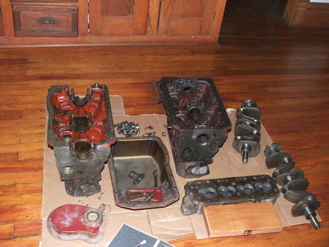

Update....
Going to Waverly Va. next weekend to drop off a bunch of stuff.
Gonna have Steve Ellis build it.

WhatsThatNoise said:
And reclaim my kitchen.

Anyway....Dropped off the blocks, cranks & head at Steve Ellis' place...
8 hrs down & 8 hrs back....What a PITA!
He said (jokingly) "just send me $500.00 a month until I tell you to stop".
Then come down for the dyno run & pick it up.

UPDATE...
Engine builder called...
ENGINE IS DONE!!!!
He E-Mailed me some numbers for the 1622
RPM---------------------- CBHP-----------------------CBT
7----------------------- 119.2----------------------89.4
6.5----------------------121.4----------------------98.1
6-------------------------119.6---------------------104.7
5.5-----------------------119.9---------------------114.5
5-------------------------114.2---------------------119.9
4.5-----------------------104.2----------------------121.6
4---------------------------88.8---------------------116.7
3.5--------------------------73.4---------------------110.1
3-----------------------------51.4--------------------90.0
Remember it is a Auto-X car...
Not a road racer.
