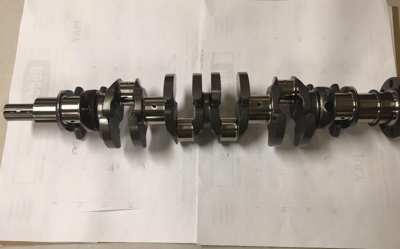

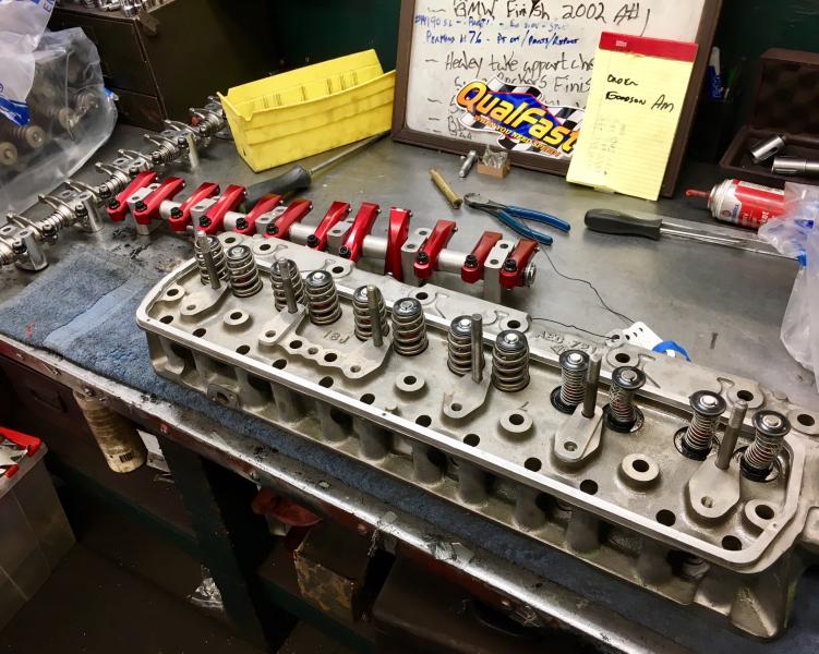

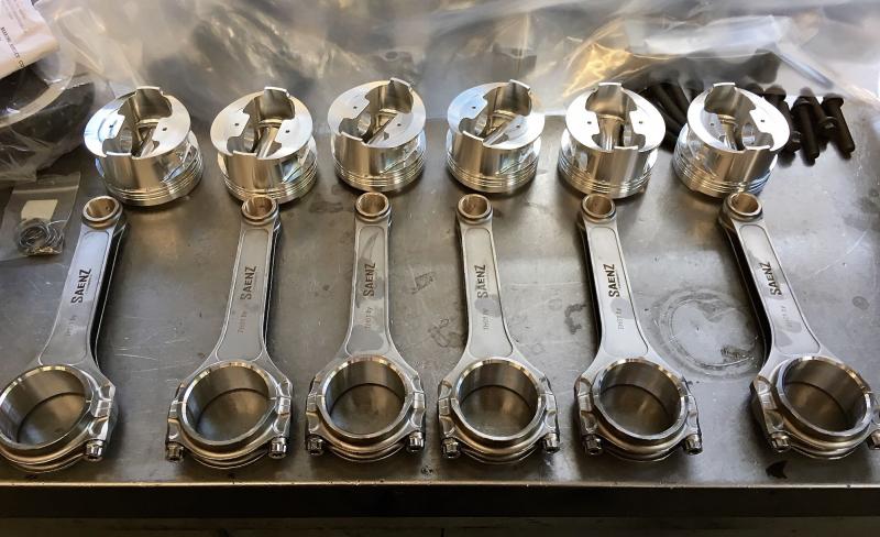

Using mostly bespoke American made internal parts, Comp SBC throughout the head, and AH Spares/Sideways Engineering for misc.

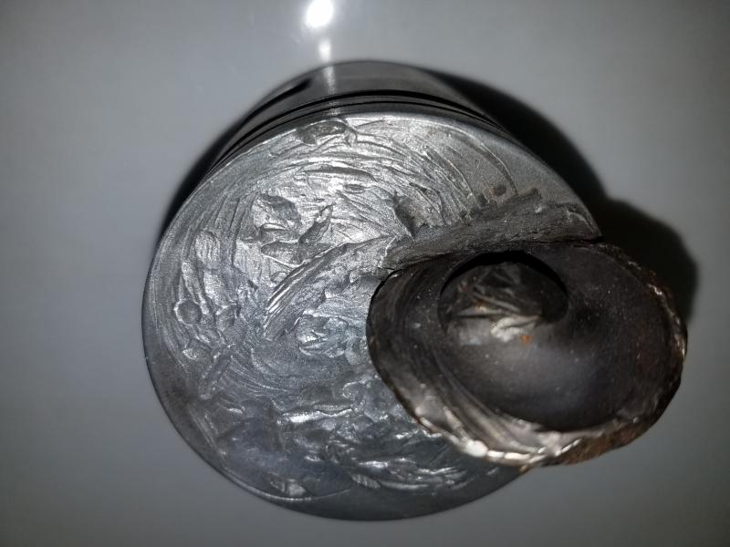

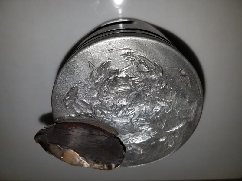

Recently while I was checking valve timing after changing the chain on the 100 I found one broken AL DW keeper. I chose to replace the set with another from DW as mine is not a race engine and the break occurred after about 14 years/60K miles. That said if this were a racing engine I would be using steel keepers and that is what I have on the race engines of both Elvas and the Ginetta.
Here are some pictures of a valve (just the head, luckily) that broke off at the base of the stem on the MGA engine in my Elva Courier. The valve is epoxied into the piston for display purposes. It destroyed the piston and scratched up the bore but I was able to hone it out and go slightly oversized. A new piston and I was, literally, off to the races.
If the valve were to fall into the combustion chamber stem and all due to a broken keeper/collet, etc. the results would not be so minor and a seized engine, broken crank, etc would be a very likely result.
