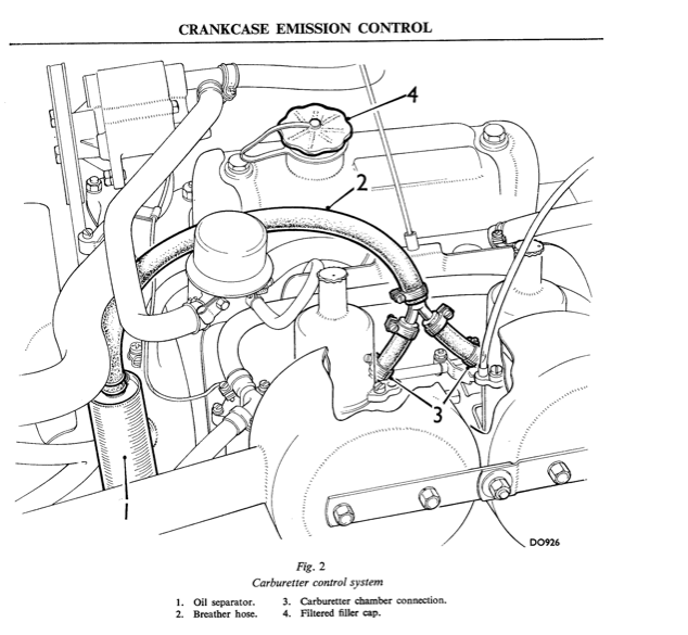

I have a 67 Sprite with a 1275 in it. The 1275 has a breather "port" on the front of the engine on the timing chain cover. It also has a vented cap on the rocker arm cover and a tube for a vent on the rocker arm cover. I am thinking too many vents and one reason why the engine leaks. Should I get a non vented cap. and run the vacuum tube from the front carb to either the vent on the rocker cover or the one on the timing chain cover and block the other vent.Which would be the better vent to use as the suction point?

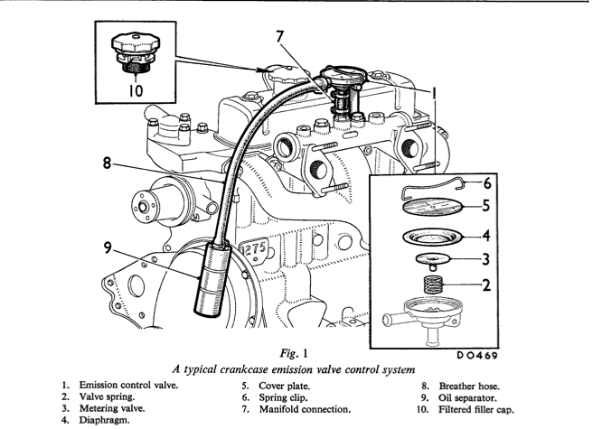

Depends on the carbs you have. Illustrations below should guide you or you can post pictures.
Best results will be with a PCV, but depending on your engine condition, vacuum may or may not help. Success depends largely on the tolerance at the rear main to be wishing limits, and those limits are pretty small. The other option of that fails is rebuilding the engine to restore tolerances or adding an actual rear main seal.

I did use the PCV that Bill (above) gave me and tried it per Gerard's second drawing; but what I found was that the suction from the intake was a tad bit too strong and I'd gulp some oil, and would produce brief smoke. One time it gulped so much I had thick smoke for 5 minutes... so I'm back to the sump simply breathing.

That can be regulated by reducing the size of the orifice. Technically, it should be a 9/64" aperture. Were you using a vented or non-vented cap?
