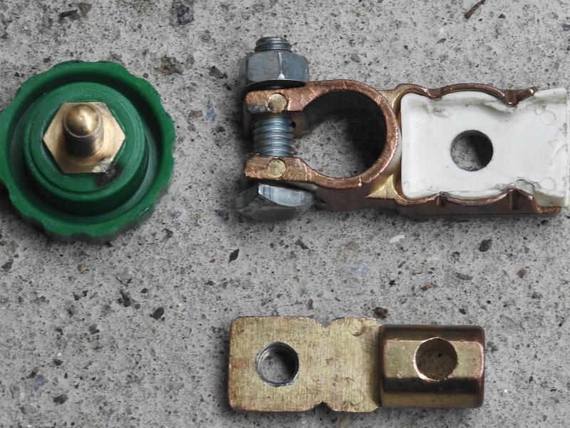

Maybe I'm stupid, but if the green knob bolt is in any way touching the bottom plate attached to the post, it will complete the circuit. Only way to break the connection is to completely screw out the knob and remove, thus separating the two plates. Backing it out a turn or two still leaves it attached to the bottom plate. Unless this unit is defective somehow. Are the two plates supposed to fit together tightly? The green knob does have a flat metal part on the bottom. I'll try to attach a picture. Green Thing.jpg

They way the switch works is that the screw goes into the bottom plate and when tighten down the bottom hexagonal base of the screw makes contact with the top plate completing the connection.
When the screw is loosened, the hexagonal part of the screw (under the green knob) is no longer in contact with the top plate and the connection is lost.
The plastic insulator keeps the screw "centered" in the plastic so it never comes into contact with the top plate until the green knob is tightened down and the hexagonal top of the screw makes contact.

Obviously, the part of the plastic insert that the knob fits into is not doing its job of insulating the two plates so that backing out the knob does no good. Somewhere, its still touching metal. I'm just stubborn enough to keep trying to make the thing work before I'll admit defeat and spend Six Bucks for a new one. Definition of Insanity - doing the same thing over and over again and hoping for a different result. Thanks for the advice.

Maybe I'm stupid, but if the green knob bolt is in any way touching the bottom plate attached to the post, it will complete the circuit. Only way to break the connection is to completely screw out the knob and remove, thus separating the two plates. Backing it out a turn or two still leaves it attached to the bottom plate. Unless this unit is defective somehow. Are the two plates supposed to fit together tightly? The green knob does have a flat metal part on the bottom. I'll try to attach a picture.View attachment 54685
The metal part of the green knob is making contact where that burned spot is on its hex corner. It looks like the green plastic ring around the hex portion should be raised above the metal and squish down when tightened, and keep the metal hex away from the top plate when loosened.

OK. This (I hope) will be the last post on the Green Thing. I FINALLY got the SOB to work! Doc was right as usual. I reversed the plastic insert, thus holding off the bolt. But it looks like...S&%$ so I bit the bullet and for $7.43 - including tax - at Auto Zone, I got a new Green Thing, tried it out and.....it worked, but it still shows .66 volts even when backed off. This thing will not give me complete 100% satisfaction. Why would it show current even when backed out? I'm glad I don't have to do this for a living.
