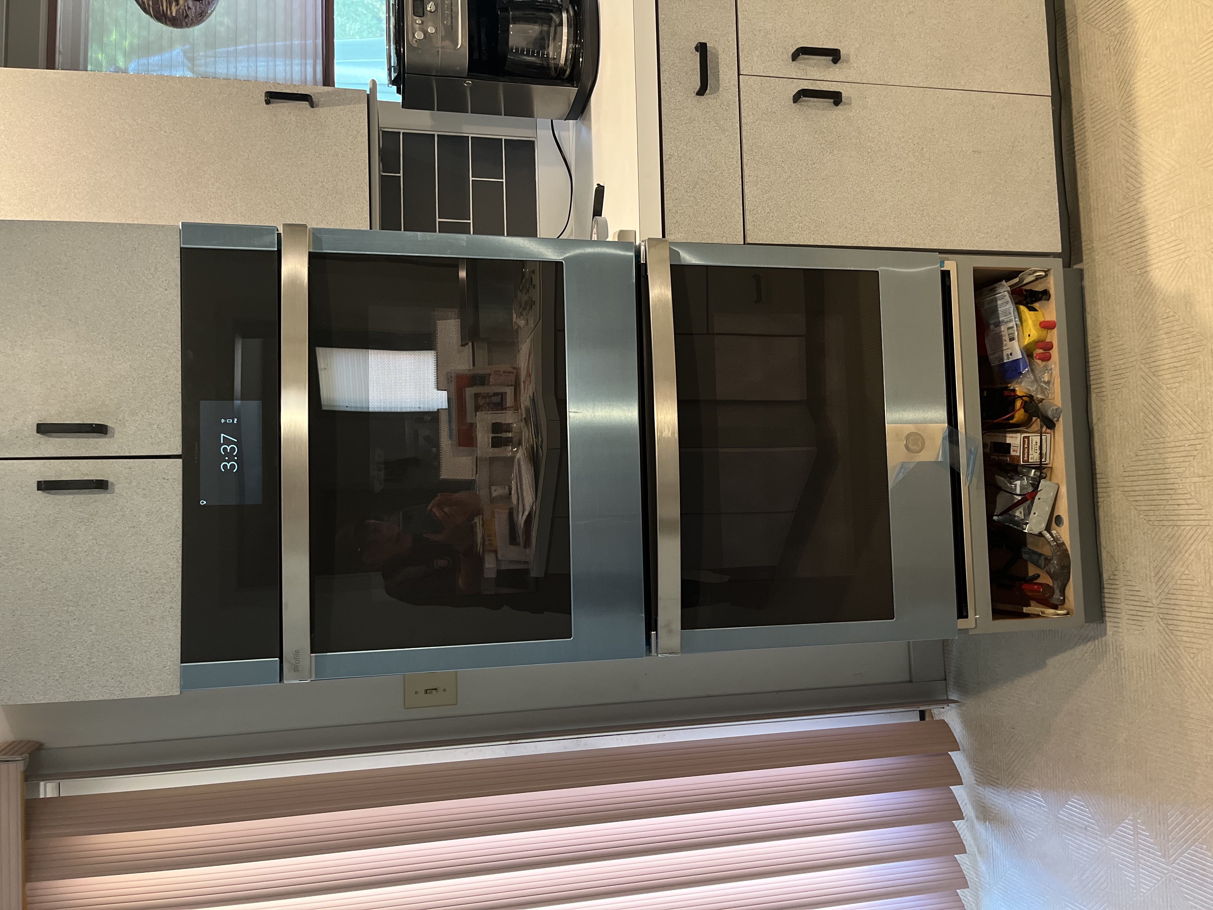

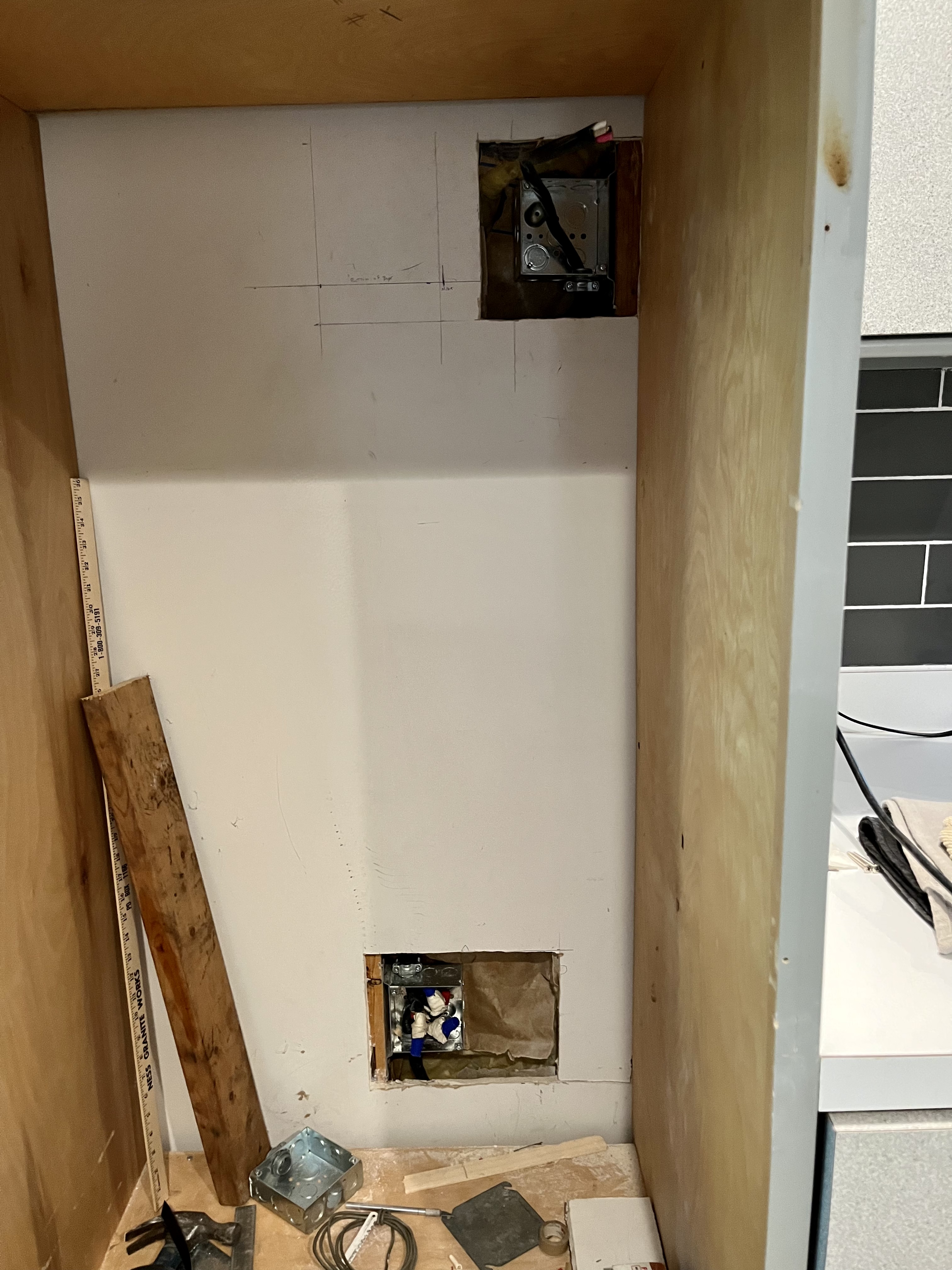

Just last night I installed our new wall oven. Had to add another box and run a 220v line to it.
the blue color on the oven is the protective film that gets peeled off.
