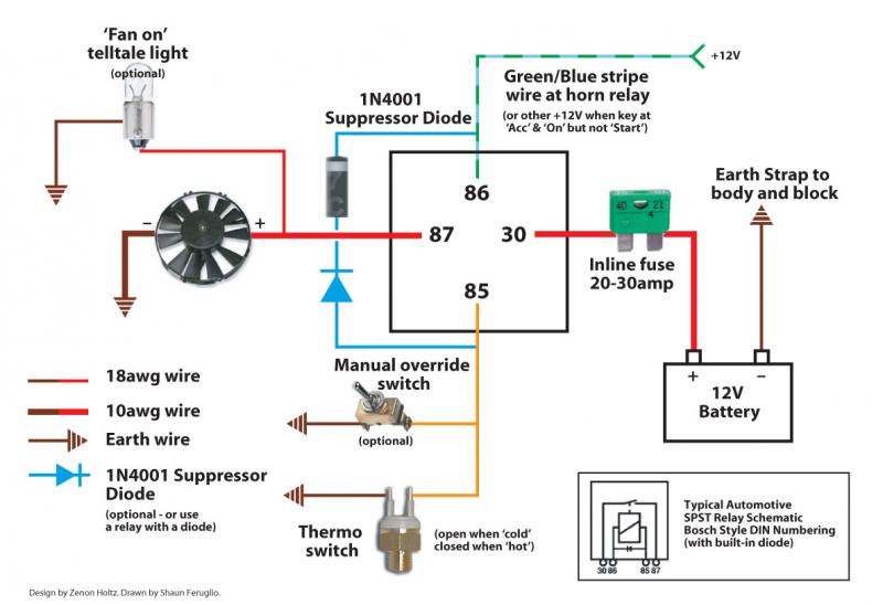

In the process of installind Rick Pattons fan eliminator and purchased a 16 in fan off of ebay since electrics isn't my strong point can someone out there advise me where as to attach the 12v red wire to and the opposite side of the circuit breaker to the switch can it be done off the fuse box. Can't figure out how to add the diagram to this post
