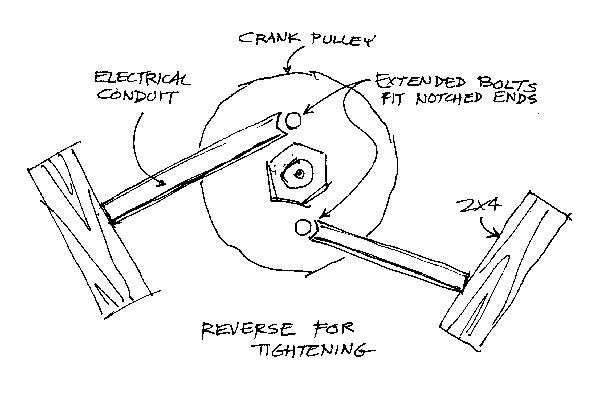

Here's a drawing of a cranknut unlocker/locker brace I built from a couple of bolts, pieces of electrical conduit (EMT) and pieces of 2x4s. It braces the crank enough to lever the nut undone with a big long cheater handle.
