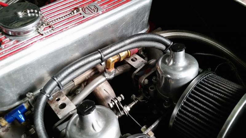

My Elva Courier (race car) has an MGA engine which is configured like a Healey with the intake and exhaust manifolds on the same side of the head. In really hot weather, or when countdown to starts have been interrupted, on several occasions I had to turn the engine off to prevent overheating and often had a very hard time getting restarted because the fuel would boil, etc. etc.
The solution I came up with--it works every time--was to drill and tap the intake manifold, insert a 90 degree elbow and run AN10 hose from it through the firewall to a ball valve that terminates just under the dash alongside the steering column. Whenever I have difficulty restarting the engine due to high temps under the hood I simply open the valve while cranking. Engine vacuum draws a slug of fresh air into the manifold, allowing the engine to start instantly, and I quickly close the valve as otherwise the engine wants to go to redline, etc.
I have attached a photo of my present intake manifold and the air hose--it's the one with the red end. This manifold is an aftermarket one made by Maniflow which required brazing on the elbow but when I first came up with this concept I was using the stock cast MGA manifold which was much bigger and allowed for drilling and tapping--my point being that you can easily do this to a stock Healey manifold. Of course, you might have esthetic considerations and perhaps it is easier to wait 10-15 minutes for the engine to cool down but this is not an option on the starting grid!

I don't think a fuel return line alone will help. The problem is not with fuel supply to the float bowl but with the proper air/fuel mixture getting into the combustion chamber. Merely allowing fuel to circle through the bowls and back to the tank via what is normally an overflow line will not solve the problem.
My momentarily opening ball valve to the air line plumbed to the intake manifold downstream of the carbs brings in relatively cool air which more readily mixes with the fuel vapor producing--voila--combustion!

The problem is not in the "pipe" but in the intake manifold/combustion chamber. Running a return line to draw away heat from the fuel system might produce some relief--so would pouring ice water on the lines--but let's remember that the object of the exercise is to get the engine restarted.
When the carb bodies and/or the intake manifold get overheated due to high engine temperature and heat coming off the exhaust manifold the engine gets "heat soaked", the fuel turns to vapor and the mixture becomes too rich and will not ignite. The air inlet corrects the situation and once the engine has fired it can draw fuel past the needles/jets and into the combustion chamber in a burnable fuel/air ratio.
I don't suggest that the modification is for everyone--I'll repeat that I did this to one of my race cars where originality is not an issue. But it works and if anyone will be in the Pittsburgh area next weekend I'll be racing the Courier at Schenley Park and I will be happy to give you a demonstration.
