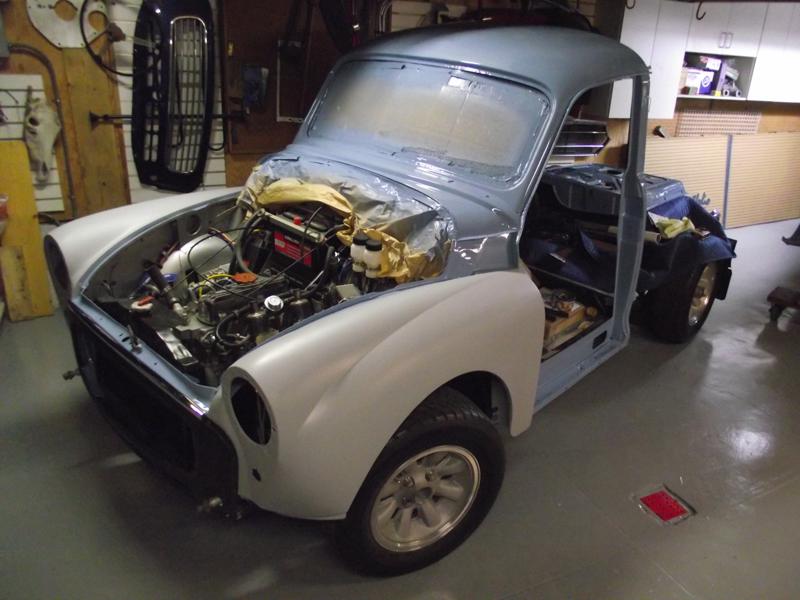

It IS a problem! I can get 6 small cars in my garage, but currently have only 4 (...and a half--- sorta... pickup bed for the Morris pickup is off and occupying a space where I could normally have another car.) I have 4 other garage spaces I have to borrow or rent. One lives under a car cover... :(

Well, not ready for the driveway yet...
