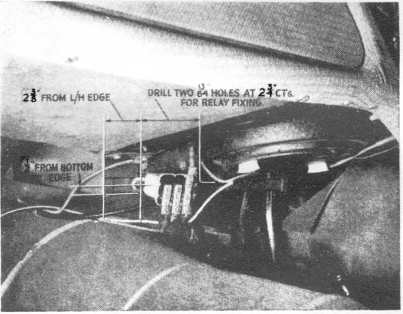

Can anyone advise me where the overdrive relay is mounted on an early 3a?
I inherited my car with a box of parts so I am flying blind on some of these things. Without the luxury of having taken the car apart myself I can only go by pictures I've seen - I do have one showing it mounted to the battery box, but its a 66000 car - not sure if it's correct for an early 31000 car - mine doesn't seem to have a screw hole here.
Photo appreciated. Thanks in advance,
