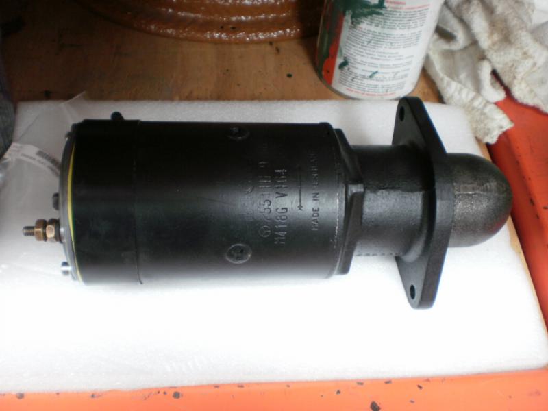

Gentlemen,
I think the pictured starter is the "Bullnose" or "Bomb" type used on pre-TS50000 cars. Is that correct? From what I have read, supposedly this will work fine with post TS50000 cars (with the transmission bulge) as long as there is a press-on flywheel ring, but one should not try to use it with a bolt-on ring. Your verification would be appreciated. Believe I just restored the wrong starter (even if it was on my car before).....
