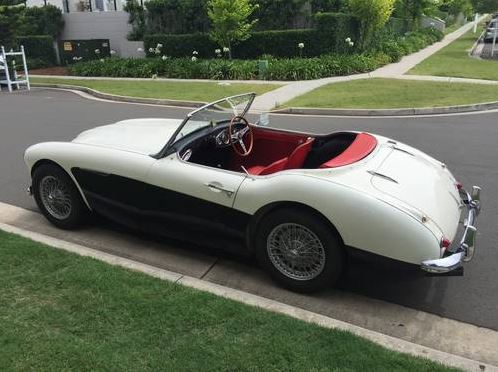

Does anyone have, or have knowledge of a locking door handle for the early 100-Six on the right side of the car as in the first picture below?

The lock might have to do with the driver's side door, since that car looks to be right hand drive.
Bob
The red Healey is the only early 100-Six car I've ever seen with a lock on the right side. All the RHD cars I've seen look like the one below, with the lock on the left side!
red57
Duane, I agree - all I have seen are on the left side. I think the red car photo may be a mirror image. There is something below the sill that looks like an exhaust? and something below the bumper that could be an exhaust? On top of that, I can't see the gas tank fill? So I held a mirror up to the monitor and it looks like a normal left hand drive 100-6, as seen from the left side. Anybody else see what I'm seeing?
Dave
terp83
Dave,
I would agree that the photo of the red car might be a mirror image. The steering wheel appears to be on the near (right) side of the image, as the positioning of the outside mirror would render it pretty much useless if the steering wheel was on the far (left) side of the image.
Jerry
pan

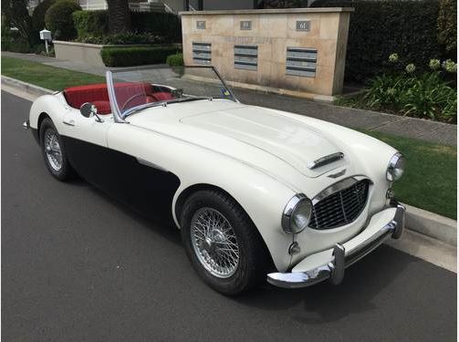

Duane_Rhynard, did you find those pictures of the OEW/black 100-6 on a car sales website? You might be interested to know that that very car was the first BN4 to be supplied new in Queensland!
Yes, very interesting, thanks!

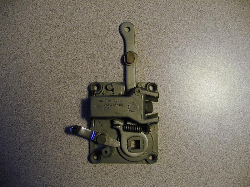

Will someone be so kind as to contribute to my Healey education? Why would only one door lock? Does the other door have a way to lock it, otherwise a thief could just enter through that side?
Internal Locking Mechanism for the early 100-Sixes

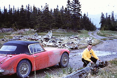

Here's another photo (from a slide) of the same car, being sold now on eBay(photo, not car). Right side door without lock, so original shot was reversed. Good detective work whoever spotted the reversal!image.jpeg
