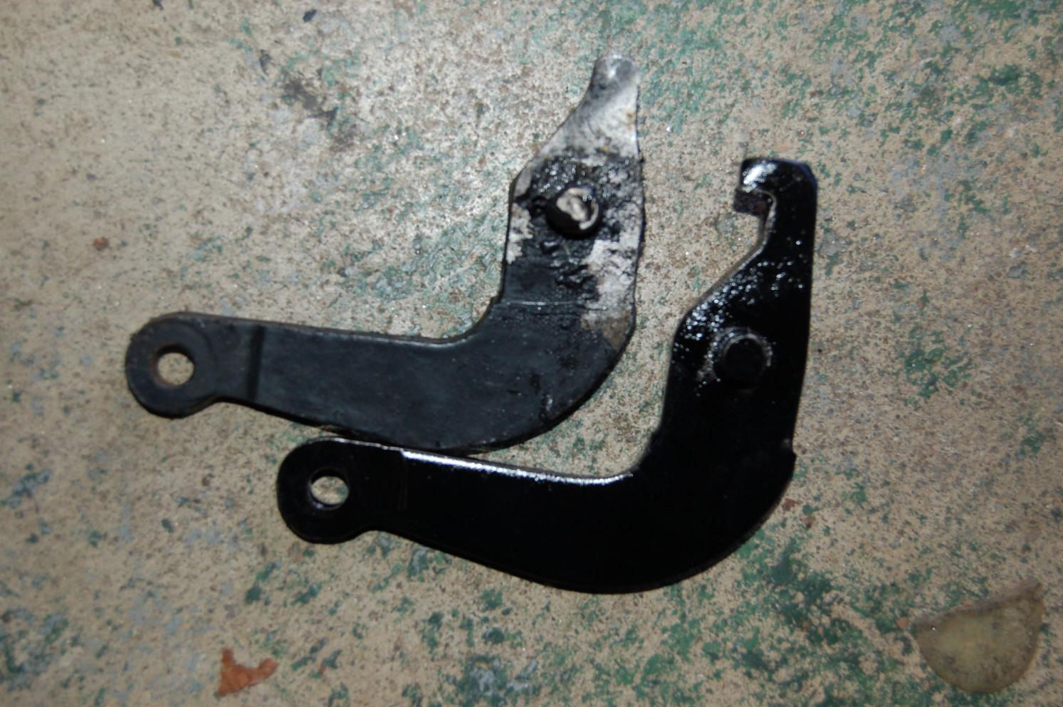

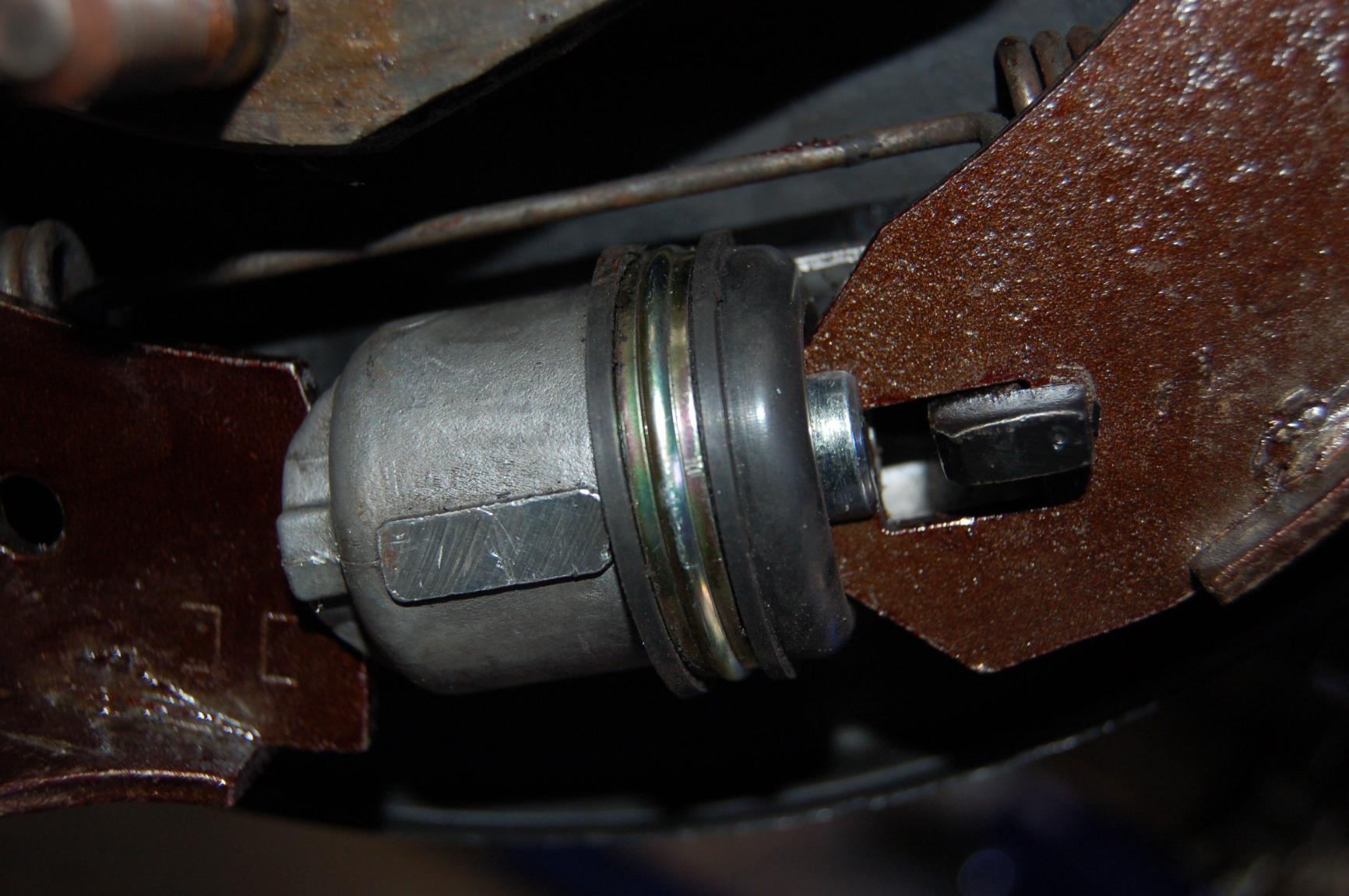

Rich, Can you take some pics of both levers that go to the rectangular holes in the shoes and post them? Also, can you remove both pistons from each of the adjusters easily or do they bind?
Yes, no binding.
Here's the one with the L-end

Are both "L" the same on both sides? Was the E-Brake working before you took the car apart?

1)No, only right side has the L, the side that popped out is just straight on the end.

My assessment is that Andy is right, the lining are too thin on an oversized drum causing the shoes to have to move further than specs. to engage the drums. That explains why the adjusters need to be tightened so much and why the straight ended e-lever pops out and why I had a tough time with e-brake cable adjustment. I'm working on replacing the shoes with thicker lined shoes and as a safety, replacing the straight lever with the one shown above.

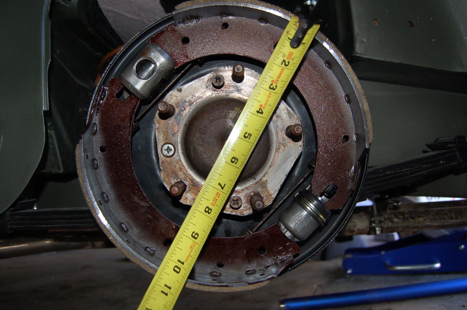

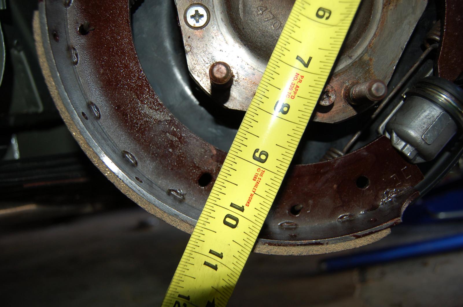

Drums are exactly 11 inches I.D. but repro linings are only slightly greater than 1/8 inch thick. Plan:replace e-brake lever with correct L-shaped one and replace shoes with ones which are 1/4 inch thick linings, back off e-brake cable to clevis pins are passive when off. readjust everything and re-bleed.

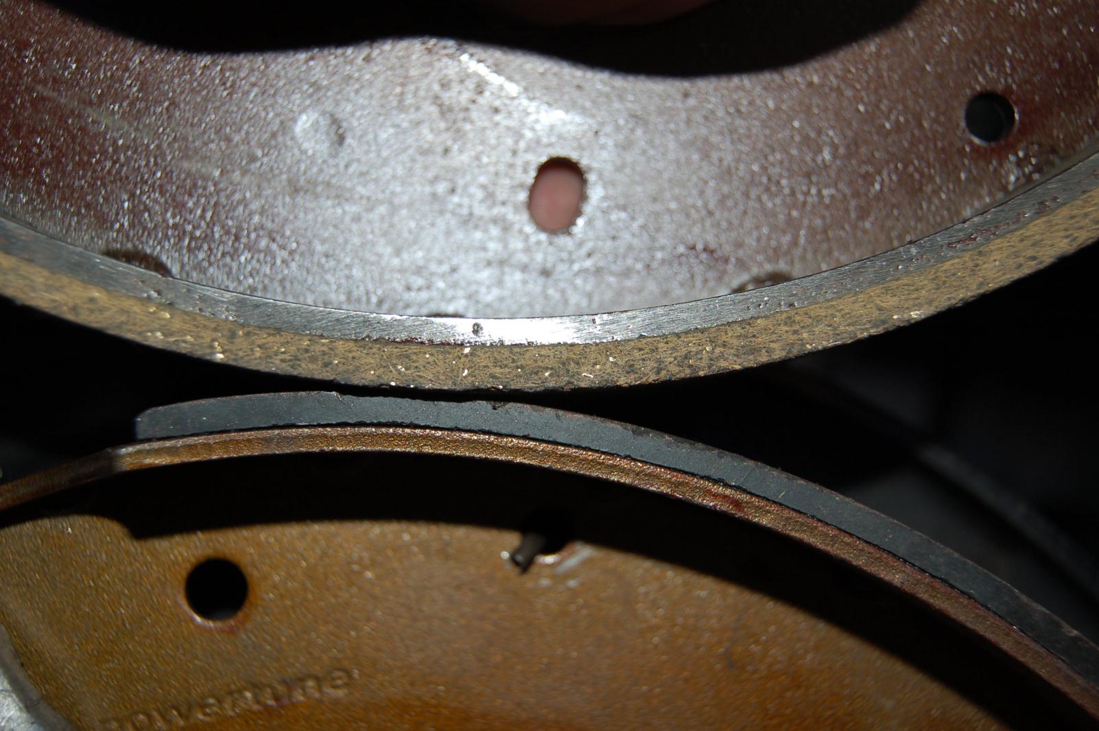

When your new shoes arrive, could you please line up the new and old shoes next to each other, standing upright with the lining facing up? I'd be interested to see how much smaller the first set of shoes is.
Andy.

The new ones just arrived and the linings are 3/16" vs. 1/8th for the repro ones I purchased from a reputable UK supplier. I think the real problem was the non-L-shaped e-brake lever that was with my car, locking the brake on. It will be interesting to see how many turns it takes to bind the new shoes "on". When you said, "no more than 4-5 flats" was that to just making a scraping sound or flat out binding tight? If I still have too many turns my next approach will be to assess the adjuster tappets for wear.

Ok, I got the new L-lever and new brake shoes installed. It only takes 10 flats now to completely binding (instead of 32). The new shoes are a full 1/8" thicker. So now my question has to do with setting the e-brake tension. If I put the e-brake handle all the way down (dis-engaged) and I set the rear adjustment so that the clevis pins fit almost tension free, in order the get the brakes to engage fully I need to pull the handle almost totally up. If I thread the rear adjustment tighter then the clevis pins are no longer easy to place as I need to pull on the rear mechanism to get the holes to line up. Then the brakes are slightly engaged and I need to relax the shoe adjusters a flat or two to have the wheels spin freely again. What's the correct setting?

You may a little too much slack on your brake adjustment. Check that first and thenadjusta little more if needed. Drive the car to help bed in the brakes and then readjust them. After that go back to the E-brake handle again and set the clevis pin adjsutement again. The brake adjusters have full and half adjustments turn adjustments so go for as snug as you can get them with just a little drag. Glad to see installing the correct 'L" shaped lever helped.
