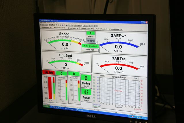

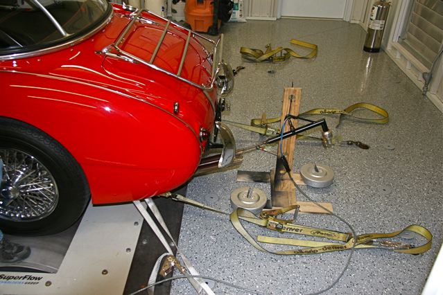

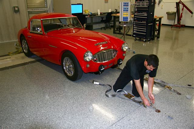

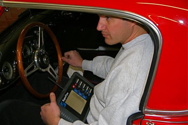

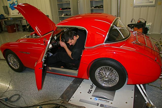

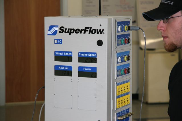

Hi Guys:
Just returned from the Virginia Institute for Performance Engineering and Research at Virginia International Raceway (VIR). I had a fun and informative day. VIPER is a joint venture involving Virgina Tech, Old Dominion University, VIR and Institute for Advanced Learning and Research. Victor Seaber was the engineer with whom I worked. He was assisted by Corey.
My goals for the exercise were to get some baseline data on my car's performance and to tune the car for best behavior at highway speed - the 60 to 70 mph range. I am making a 7,000 mile cross-country (and back) trip in May hence my desire for smooth running and as efficient operation as is possible with these motors. We are avoiding interstates on the trip so 60 to 70 is about right. It isn't a race car so peak power and maximum performance weren't too important to me. I told Victor to only push it to 4,500 rpm.
I have a BT7 block with pistons 40 over, BJ8 cam grind, Denis Welch Aluminum Head, 1-2-3 electronic distributor, Phoenix headers with 2" exhaust, lightened flywheel.
Rear wheel HP was 113.2. So is that 130.18 HP at the crank?
Rear wheel torque 146.8
<span style="font-weight: bold">Disappointment of the day</span> - there was no instrumentation (digital or analog) that could measure the smile on my face from driving the Bloody Beast the three hours from my home to the lab!
Most satisfying experience of the day</span> - We changed almost nothing about the setup of the car. We experimented with timing (but returned to original setting) and did enrich the mixture at high speed ever so slightly. So, I was happy to have my previous work validated rather than disappointed with how out of tune the car might have been.
Here are a few photos taken at the lab:

That's a beautiful facitlity!!...and your car looks super! The way I was taught to calculate it was 113.2 divided by .85(the 15% drivetrain loss on a solid axle car)giving 133.2 at the crank. What was your rpm at that reading? Did you get a graph of the hp/tq curves? I wonder how much more there was if you ran it up to 5,200 redline?...you might get a sense of that from the graphs...i.e. had the curve rolled over and was headed down or was it still climbing.
Thanks for sharing! Sounds like a fun day all around (trip there and the experience).
Cheers,
Steve
Those numbers were at slightly over 4500. The torque curve was VERY flat but was starting to drop off at about 4200. The Rear Wheel Horse Power was still on the rise, but beginning to flatten (not as steep a rise) so there were still a few more horses to coax out of the Bloody Beast.
Their facility is immaculate. There were two race cars out of view in the garage for suspension tuning.
Lin
Well, it sounds like your engine is a real torque monster...and all things considered torque is what really gives you the punch in the back when you step on it. So it's not unreasonable to project a few more HP but the TQ had peaked...which is what you would expect.
Cheers,
Steve
