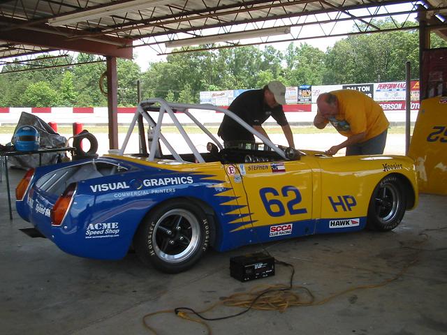

Hey Scott, where did you get the front air dam? Is it glass or urethane? I'd like to fit one under my RB.

Spridgetech, it is designed t work with their front fenders, it is fiberglass flared fenders. The may make a air dam to use with stock fender, but I don't know for sure. I use the same bodywork as Scott's on a customer's racing Midget

Last I checked Spridgetech does make an air dam like mine for use with stock fenders. Very low. Mine scrapes everytime I pull it out of the driveway without angling the car all the way to one side. But Im a bit lower than stock in the front too.
