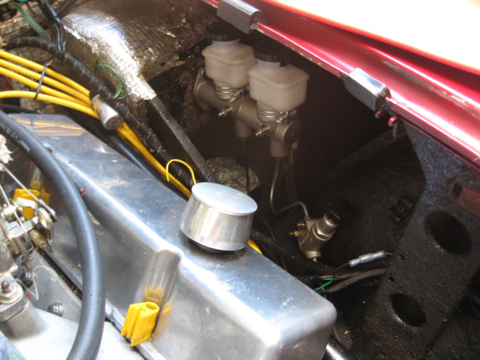

steve, i have purchased a proper union locally...but...it does not have a deep enough threaded area to properly engage the male end...the healey male end is not threaded all the way and there is probably almost 3/16 inch of inverted flare and the unthreaded portion of the nut. so i cant get enough thread engagement for my liking...i need an extra long female inverted flare union. and, i have not been able to locate one.
well i just went ahead and used a 3/16 compression nut union ro joint the two lines. seems to be okay. i have never used one of these...called a gator union...and sold in the brake parts section at the local auto supply store. any comments regarding the use of this type fitting??? thanks for all the suggestions and ideas.. cheers
