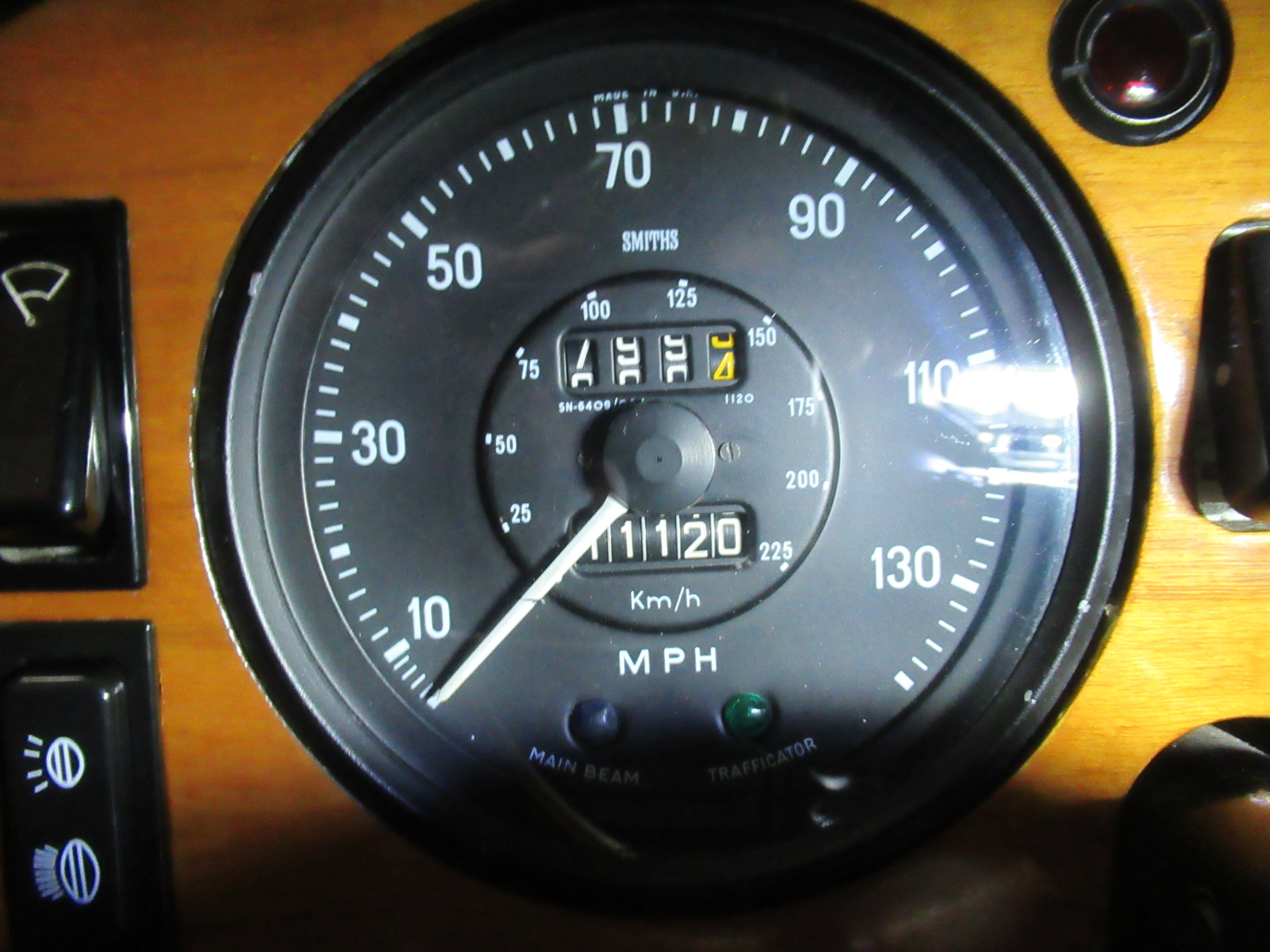

TR6 Driving not dreaming gets you to 411,120 miles

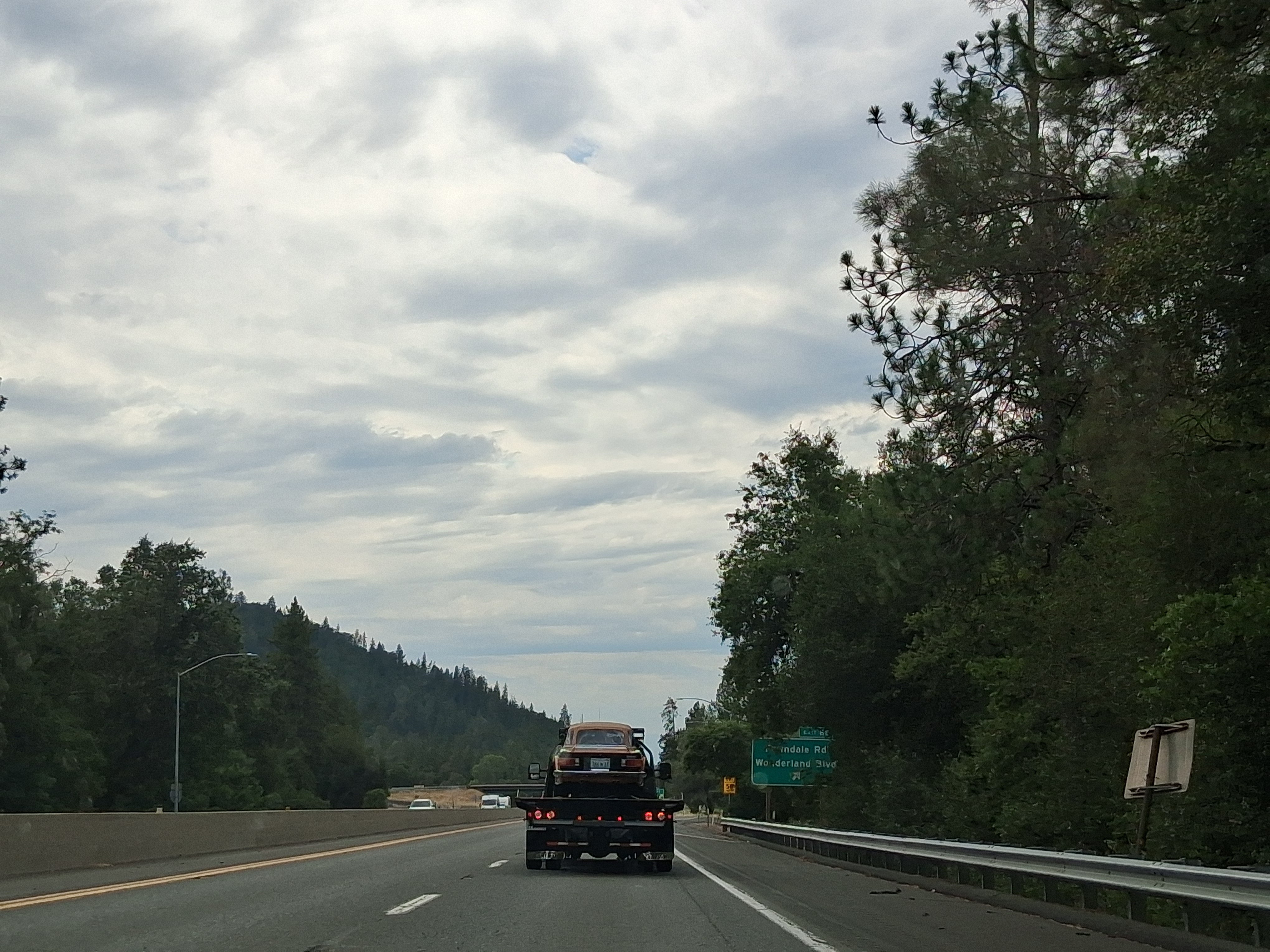

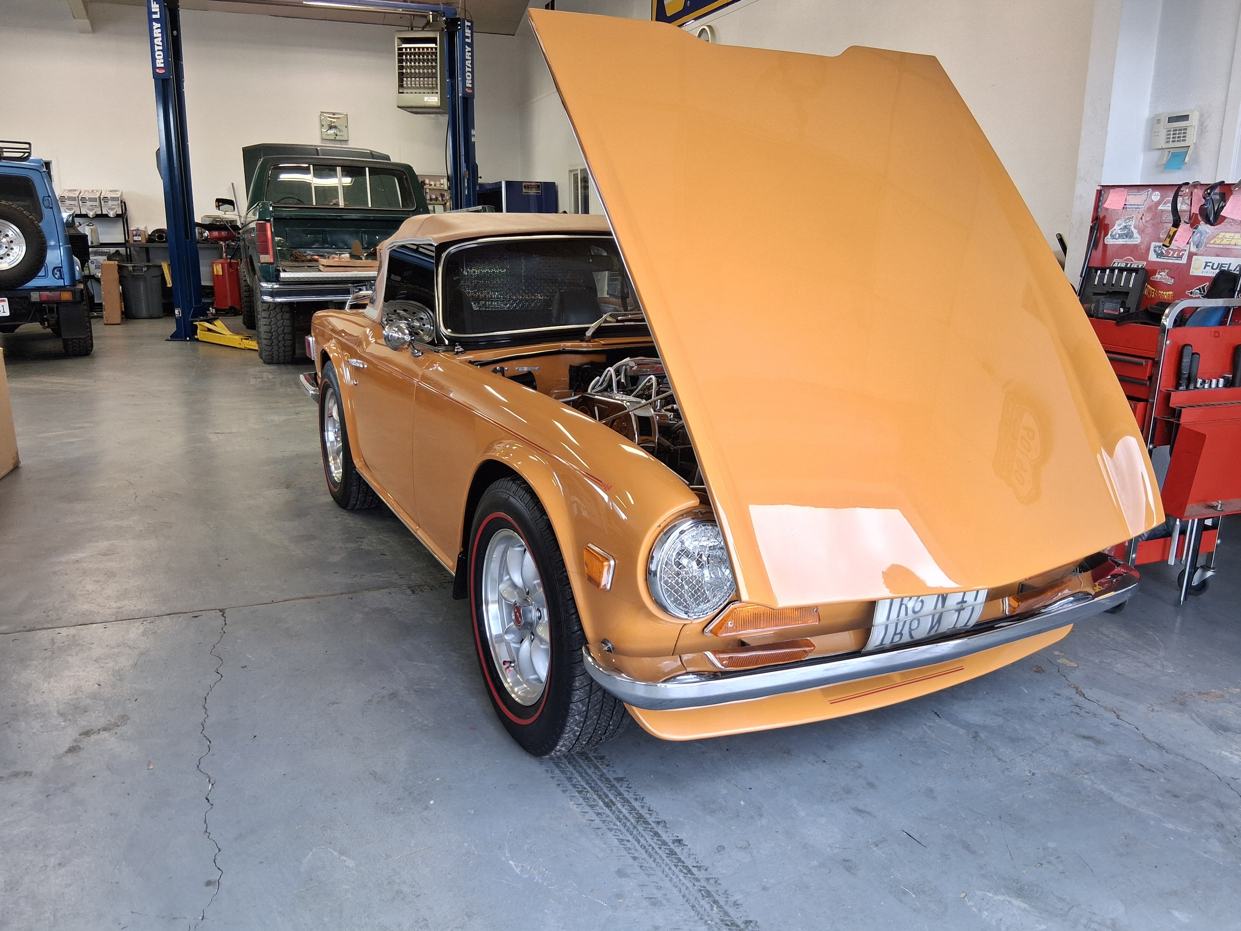

aaa came 45 min into the schedule 1 hr arrival time (try to get that with any other tow service big box or collector would've been 2 hrs+) Got there around 2:30pm instead of a 1/2 mile down a dirt road in an old barn, a clean shop '57 chevy in the corner. They had fabricator, using my chrome alt to match/shave/fab new 51 amp to fit
Once fitted check charging system 880 CCA battery showed 178 CCA, they called orielly's for replacement none in stock, shop had aaa batteries (napa premium 800 CCA) checked napa site same battery priced $259.95
3hrs @$100 per + fab/shaved to fit new alt & battery total was fair vs took to the cleaners. TR6 done it's job could feel something wasn't right slight missing @70 mph before Weed, Ca could've happened on desolate hwy 97 no cell service
