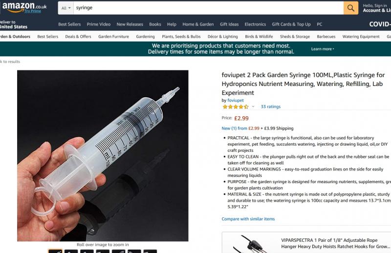

I like to use plastic syringes for both removal from reservoir, and for pulling fluid out through the system.

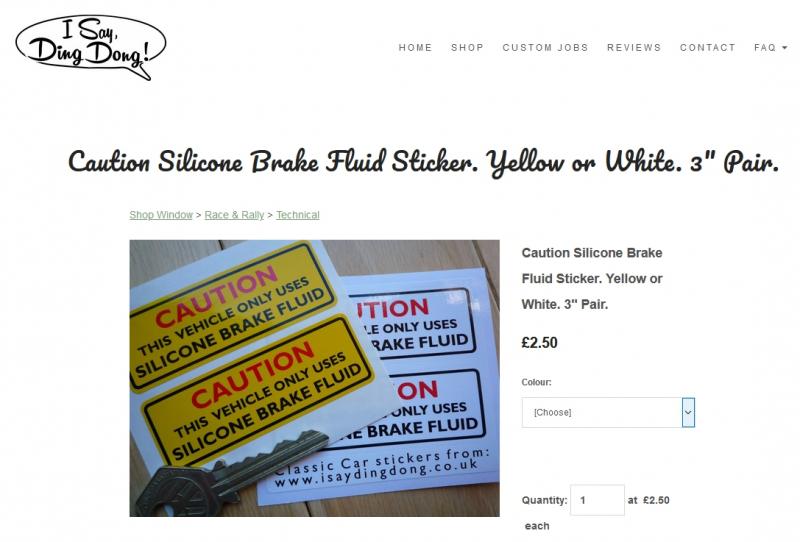

Conor, I am sorry to say that your issue has flagged a potential issue I must address ... just in case. With the virus attacking many by surprise, I to indicate my use of Silicone brake fluid with an appropriate period label on the brake reservoir of my Healey or TR7. I am interested to know what type of label others have used?

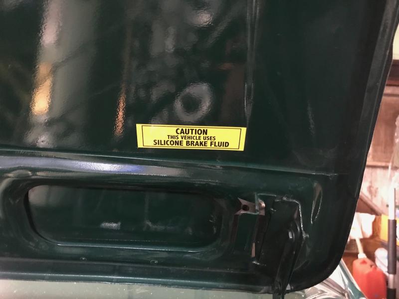

I bought this label from Moss years ago and placed it inside the hood. It stands out well against the dark background.

Thanks John/Steve, I ordered 2 pairs, one for the Healey and one for the TR7. I was intending to apply them on the reservoirs but I am wondering if they will adhere as I must have spilled some DOT 5 on the sides and if paint wouldn't adhere to the cover, the sticker glue may not.
