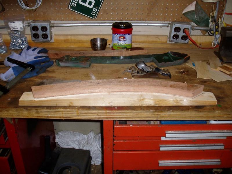

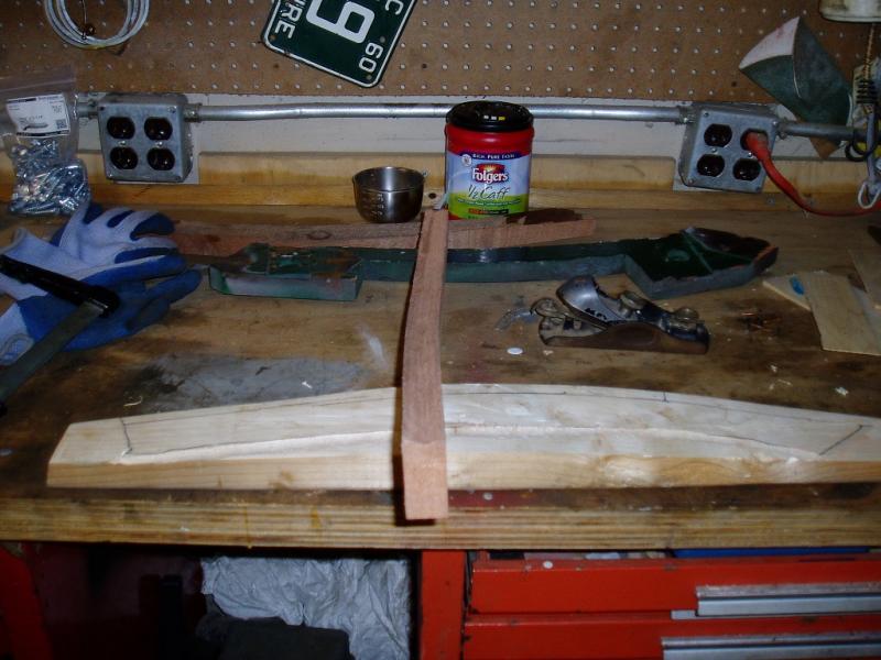

Sorry for the delay but about par for me. Here's what I did. I first bandsawed, carved and whittled a form on which to bend the piece. mould cut carved and sanded to shape..jpg

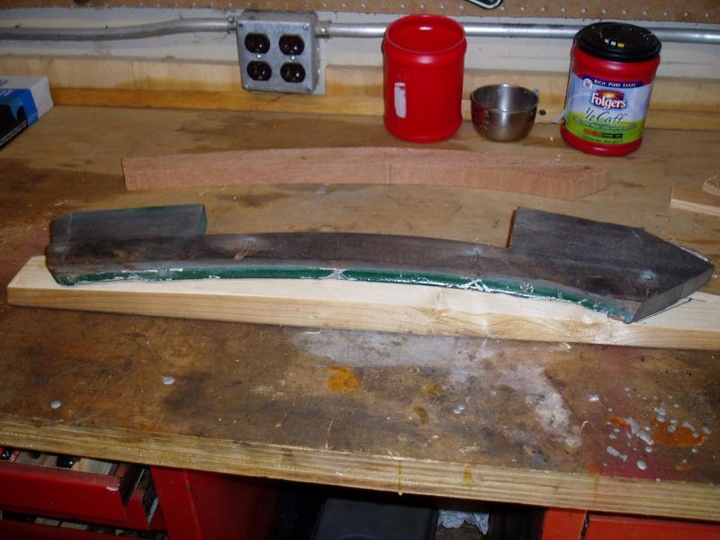

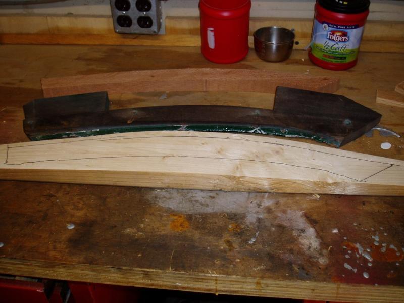

The old piece sits flat on the form.

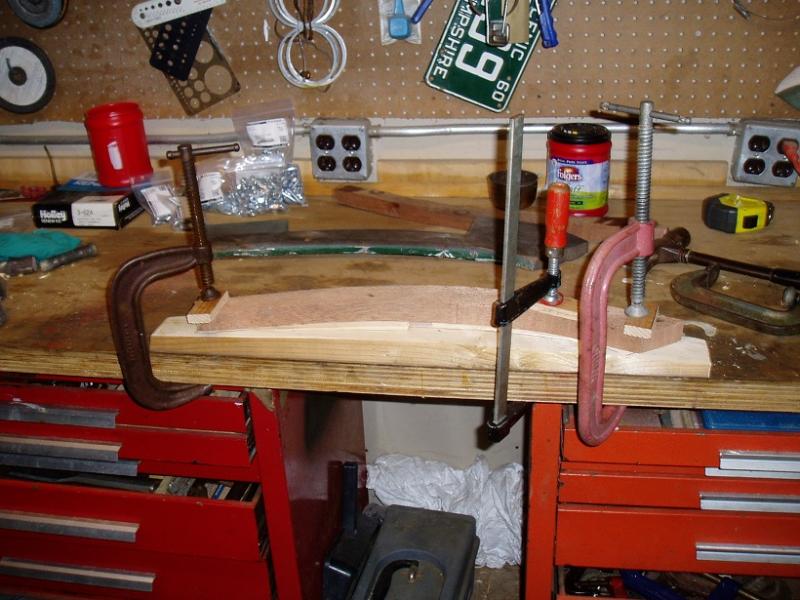

I then steamed the new piece cut to shape but still flat. Here is where you should shape the cove on the top edge. I did it after I bent it and it would have been easier when still flay. I used a 1/2 inch radius gouge and the sandpaper. I have lost the pictures of steaming. I did it on the kitchen stove when my wife was out of town. The apparatus consisted of teapot, a length of hose, and a piece of 4 inch PVC pipe which is not ideal but handy. I blocked one end with a cap and stuffed a rag in the other, around the hose. I steamed it for 30 minutes and then clamped it to the form.
If you look closely you will see two tapered shims (shingles) under the middle. I did that to "over bend" allow for "spring back" when I relieved the clamps. It turned out that two shims were not enough and I did the same piece again with two thicknesses of shims, overbending by about 1/2 inch.
The new piece conforms to the mold unclamped. I had it clamped for a couple of days and then clamped it up again until I got back to the project.
