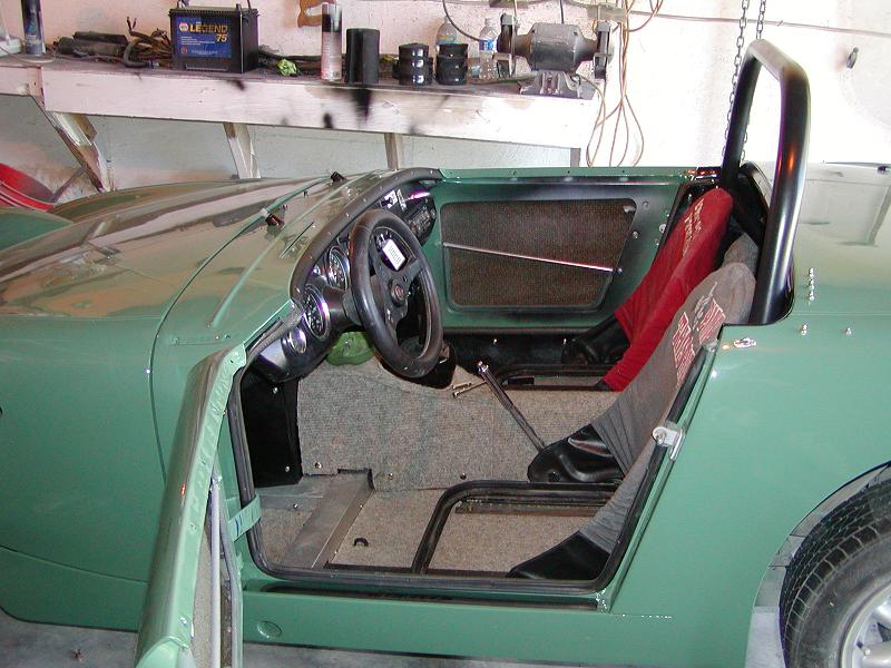

I put these on with RTV. Thin line down the middle. Can be removed with a fine wire cutting the RTV.
