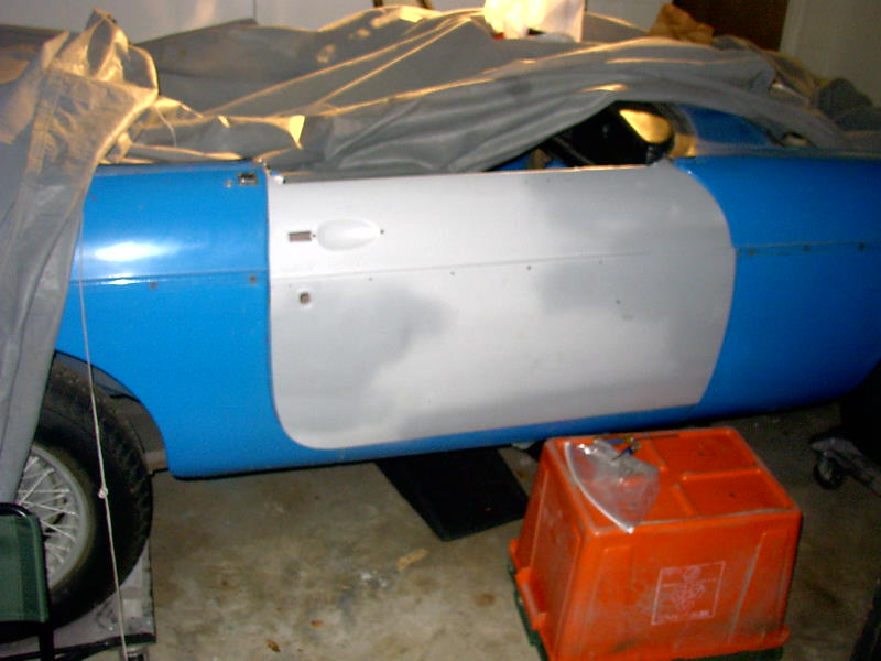

Giving the door a test fit before doing anymore work on it. How do I adjust forward/back and up/down. The rear of the door needs to come up 1/4" and forward about 1/2". It is a 78 B.
Thanks
Rick
See attached (taken in the dark hope it turn out)

Some adjustments are made using the 6 posi-screws on the hinges (3 on each hinge); other adjustments are made at the striker.
Tony nailed it (no surprise). It is a fiddly job. When I put a new door on the BGT it was a HUGE help to have a friend hold the door at the right location while I made adjustments and tightened everything up.
And yet more adjustments are made at the hinges themselves on the B-pillar. I have spent endless hours aligning MGB doors, it is frustrating, time cousuming experience.
1. The hinge adjustment (4 Pozi screws each) moves the door in and out of the aperture; the top and bottom adjust seperately. (i.e. looking down the door to the headlight)
2. Same deal for the striker, but for the final adjustment at the back.
3. The hinge fingers adjust the door "within" the opening frame. (i.e. looking at the door straight on).
The doors have three dimensions and getting them all correct takes lots of time. You'll get there, just be patient. If you do not have a helper to hold, use old towels as shims.
Yup. everyons got it. Those posi screws are pretty big, and are hiding behind the door panal at the front of the door (obvously)
I used some wooden shims, like the ones used for framing windows and house doors, to help keep things in align while i have the screws loose.
