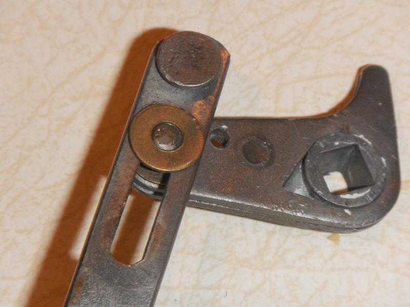

I am referring to the small round pin that secures the arm on the door latch (that mounts in the edge of the door) to the arm of the release lever (that is controlled by either the outside door lever or the interior cord).
Hello Ron
My one is peened over. The washer is free to rotate on the pin and it moves up and down the pin a bit. Not sure if that is correct. Just the way mine came to me.Door latch.jpg
David
I would use a fine file to just remove as little as possible to get the washer off. That way you could reuse the pin.
David
The new latches come with a new pin and spacer washer, so I just ground the end of the old pin off.
However, I think I will use a bolt and lock nut with the new spacer washer instead of the new pin. That way, if anyone else in the next 56 years needs to replace the latches again, it will be easier for them.
