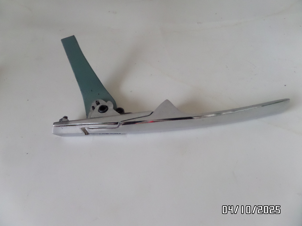

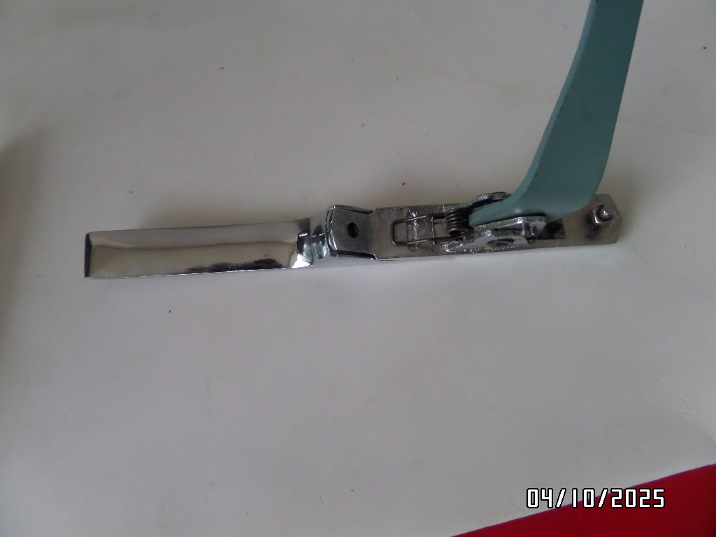

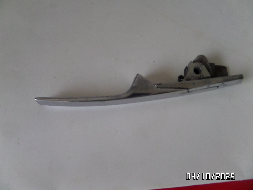

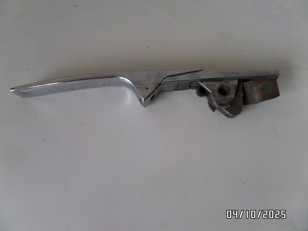

I am trying to put my BJ7 back together and going through the difficult task of identifying the parts that were removed from the car for a paint job. I found this door handle with the parts I have, but cannot identify if this is from a big Healey or another car, although it looks very similar to the Healey 3000 door handle from my BJ7.
I have posted photos of both handles and appreciate it if one of the experts in the forum would shed some light on this part and its application. The question is about the door handle in the first 2 photos. The other 2 photos are from the door handle from my car.

Door handles on my BJ 7 look like the ones from your last two pics. Consider trail fitting the handle to the door to see if the studs line up. However, that long actuator hints that handle could be from a different car and modification may be necessary.
The first two pics are the same as the handles on my BT7 .
AH Spares and Ahead4Healeys have good pics of most of the actual parts so a simple search on their sites usually finds the information needed .
Trying to see if anyone is interested in exchanging my BT 7 door handle with 2 used ones that will fit my BJ 7. The BT 7 handle is new first 2 photos and the BJ 7 handles are the last 2 in the photos.
