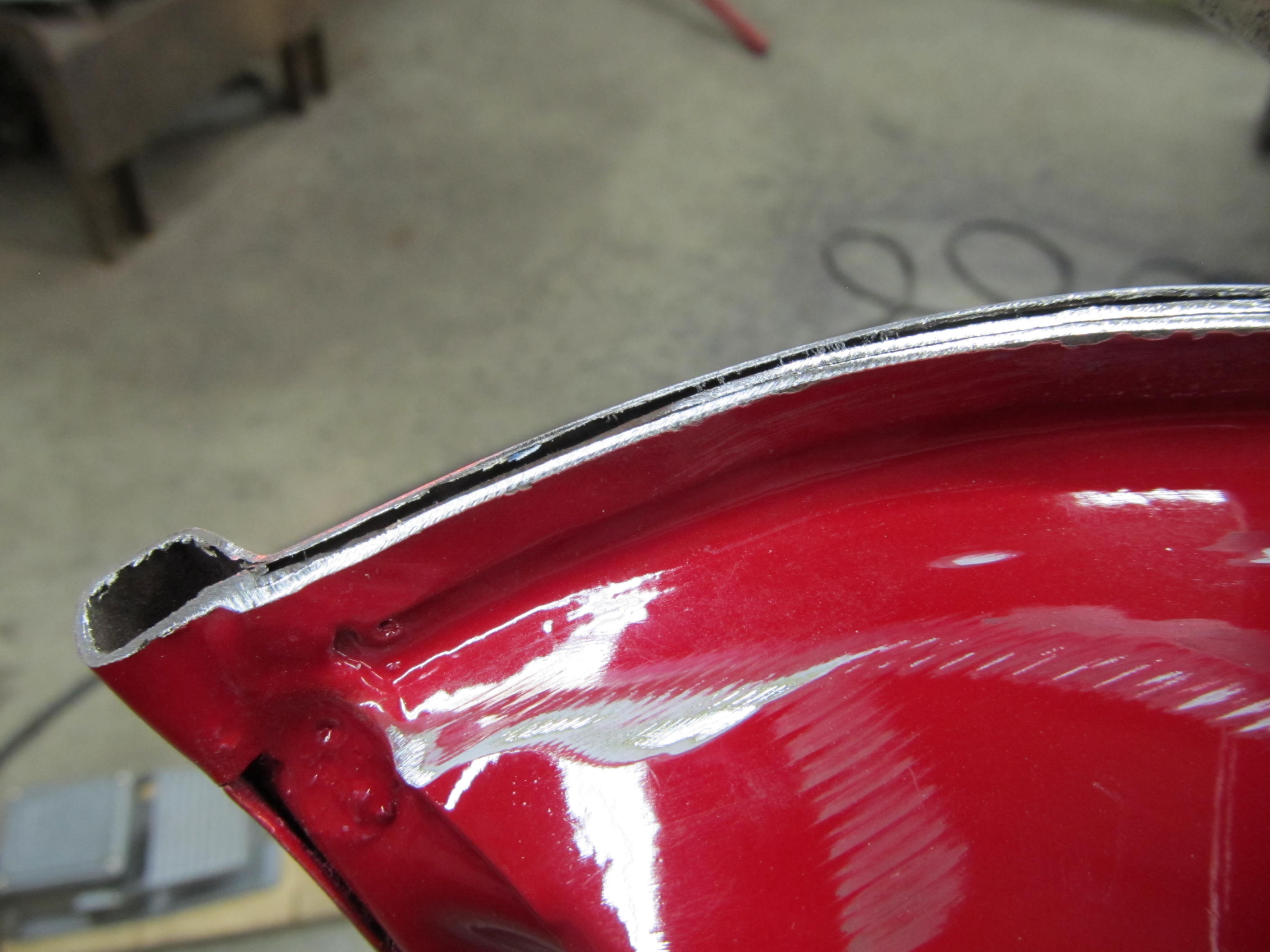

Yes, photos would help. The edges of the doors are the door skins folded over the inner door framework so if you remove 1/16" or more you are cutting the hemmed over door skin and will have to reweld in order to have a hemmed edge. I had to do a bit of that on mine but only and 1/8" or so
