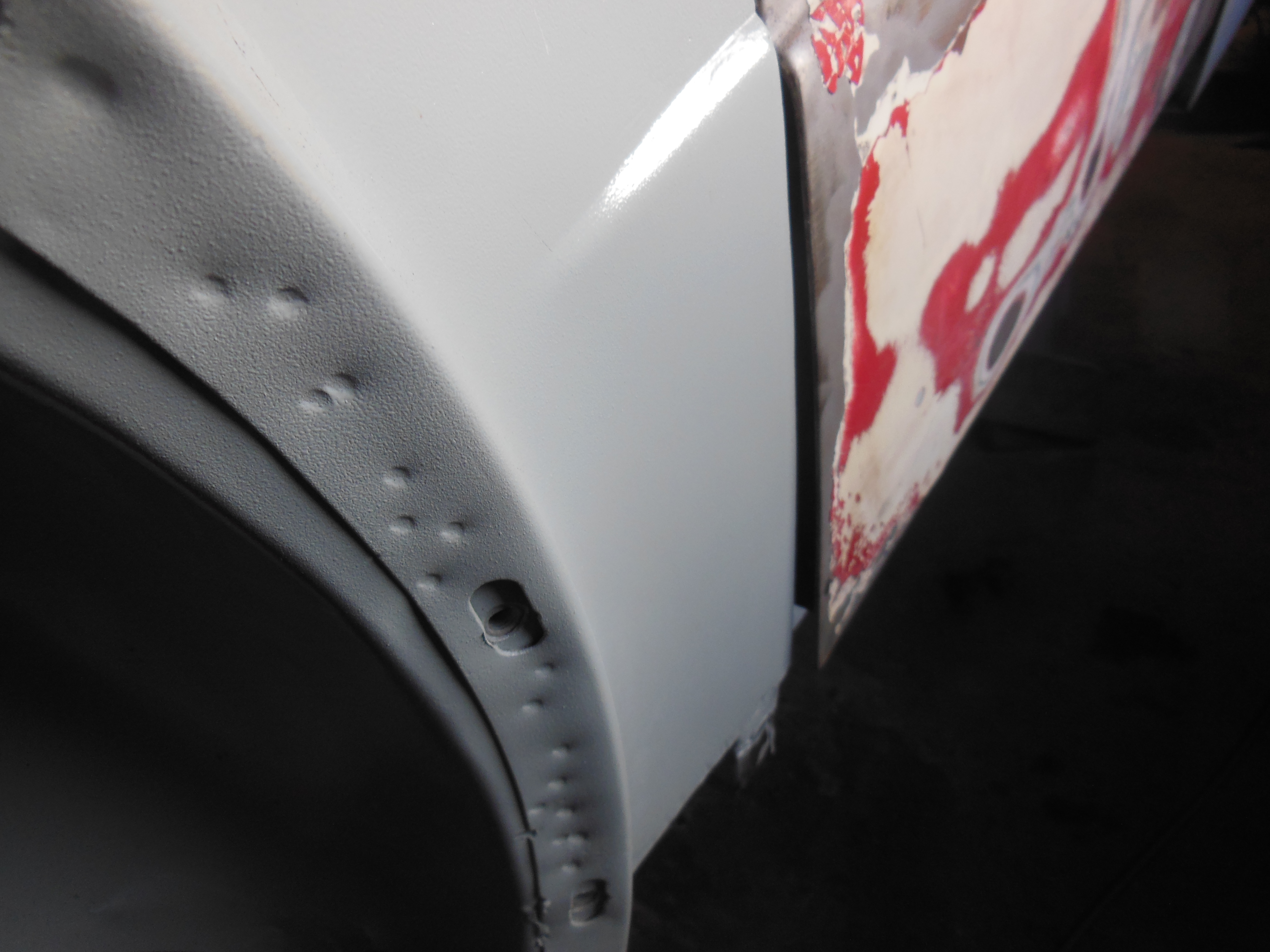

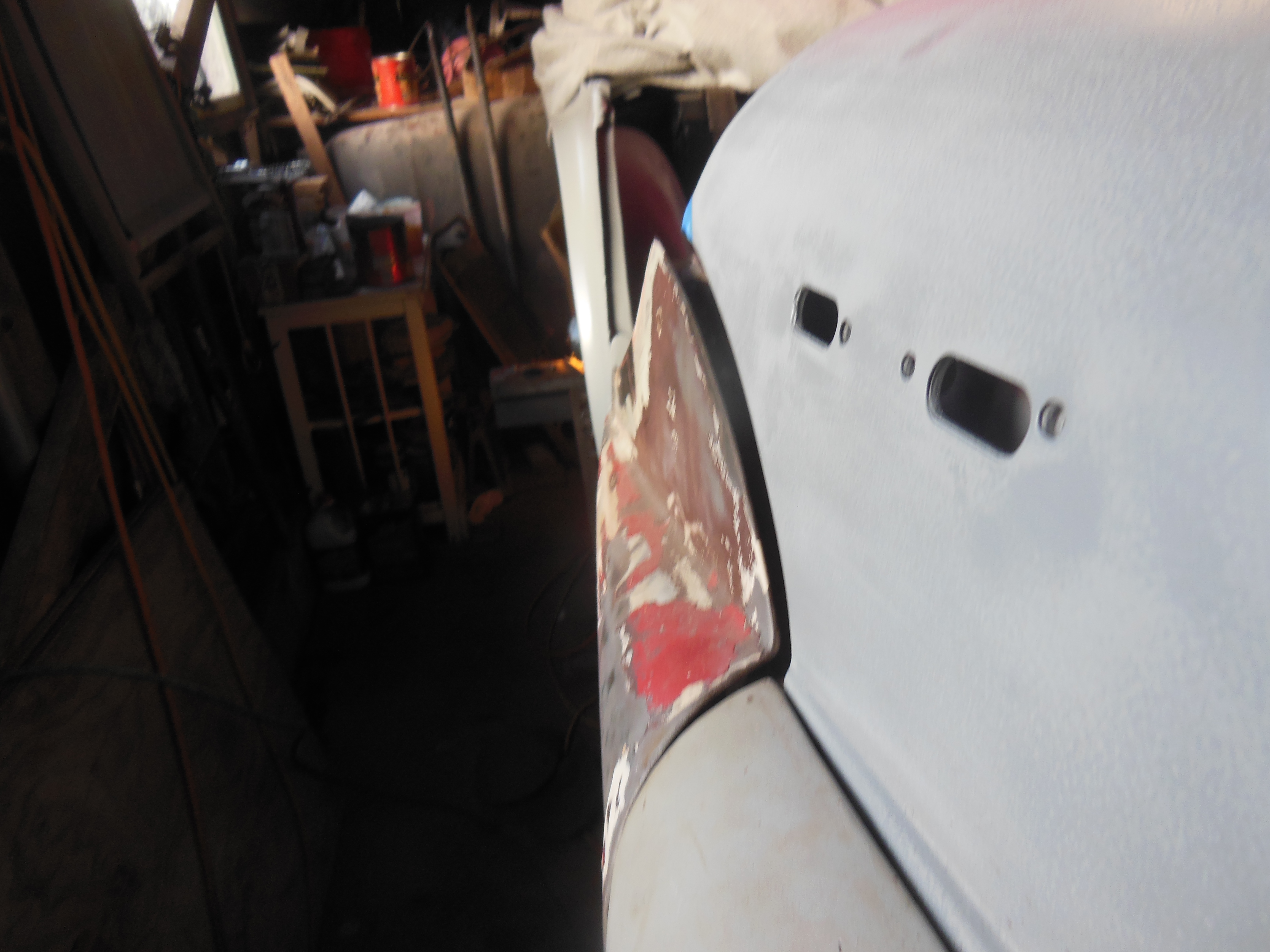

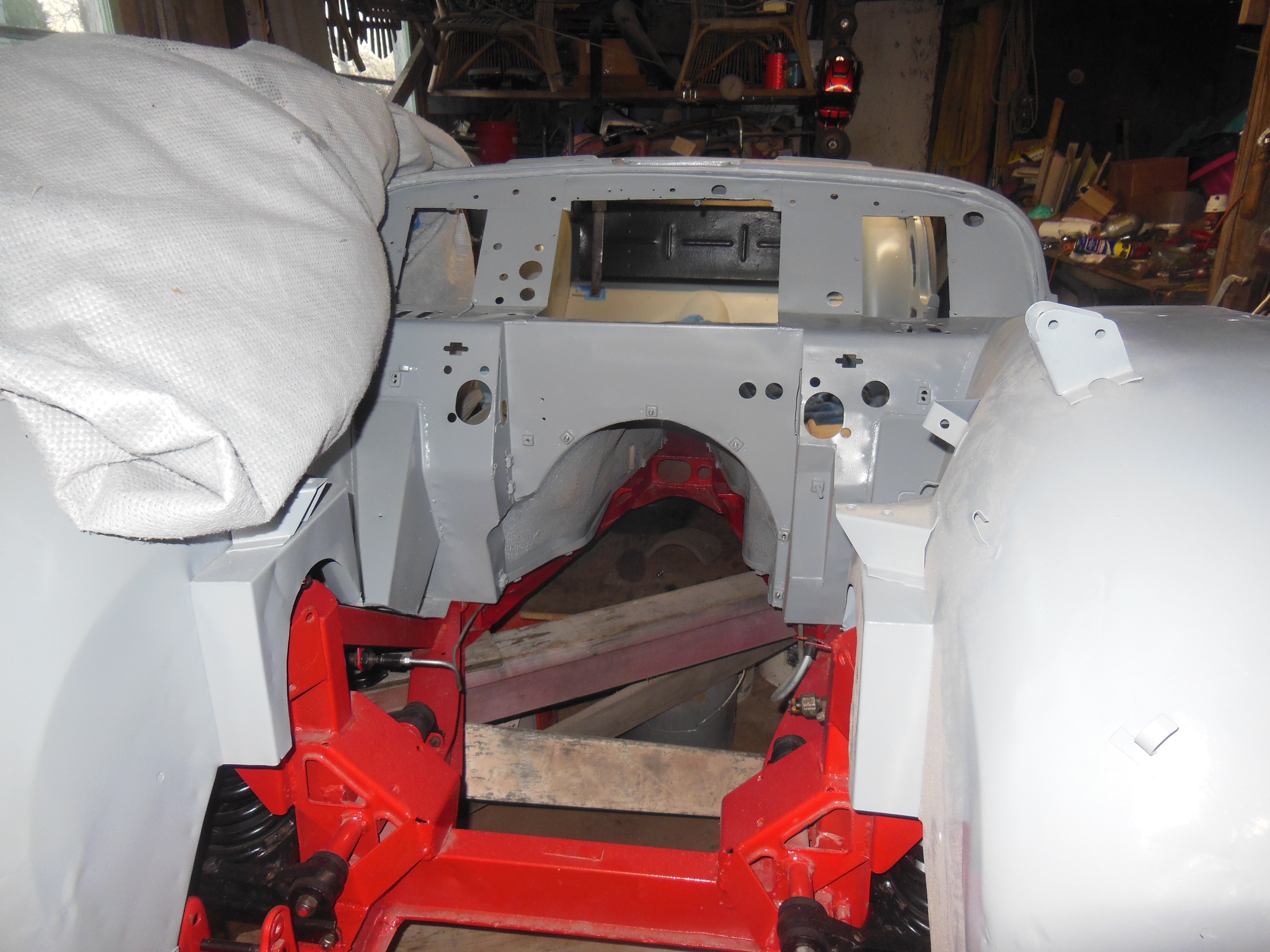

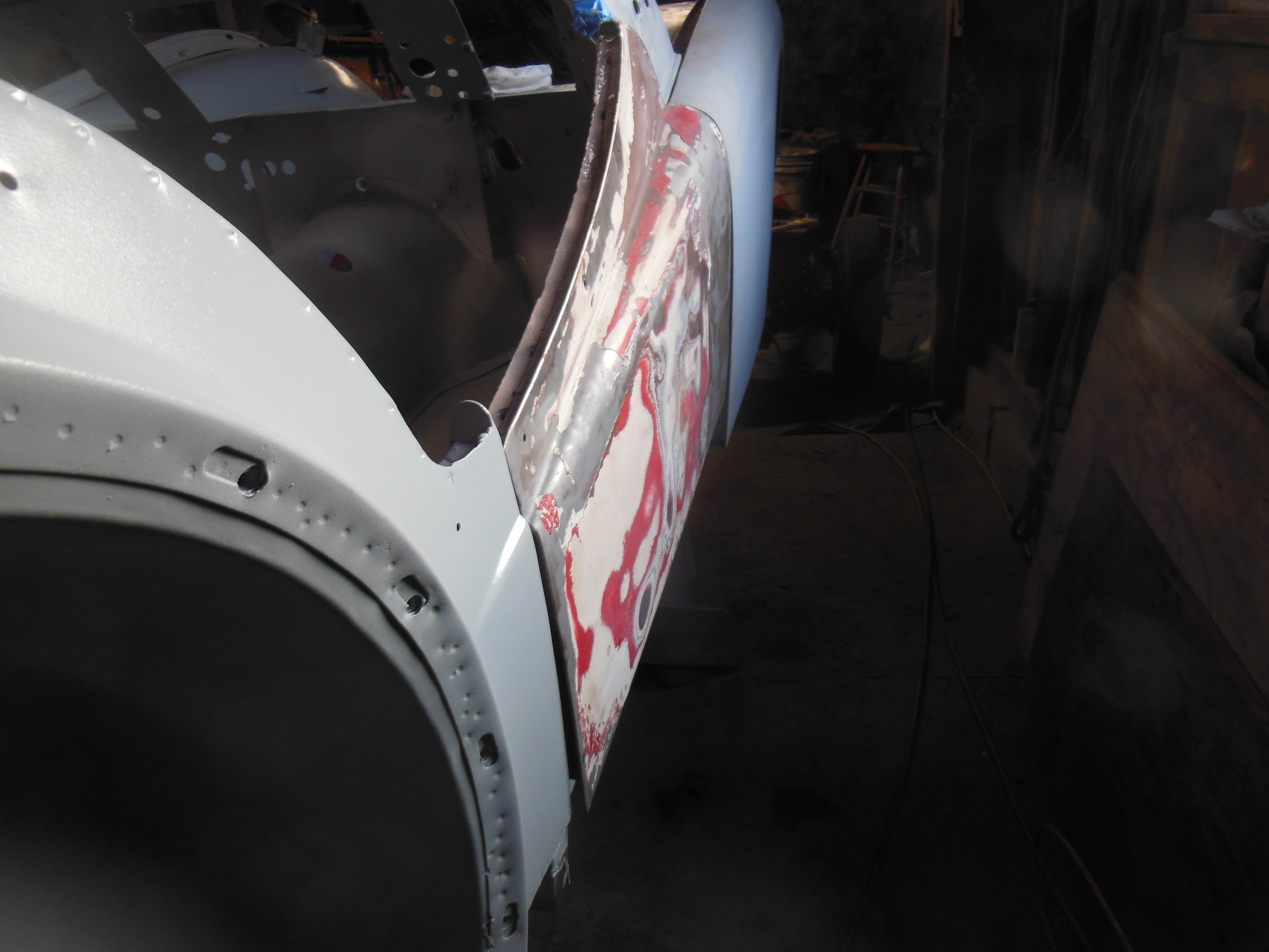

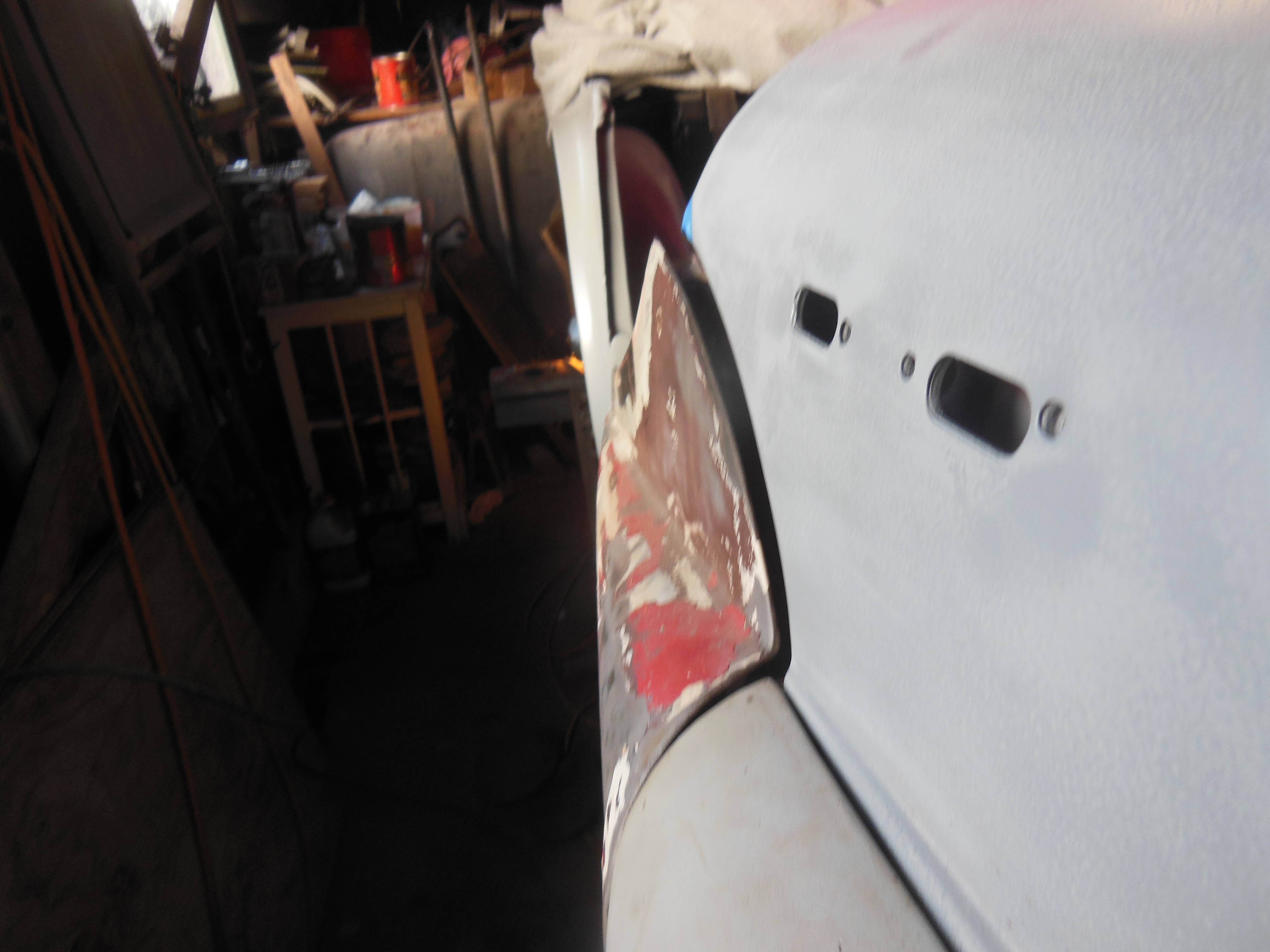

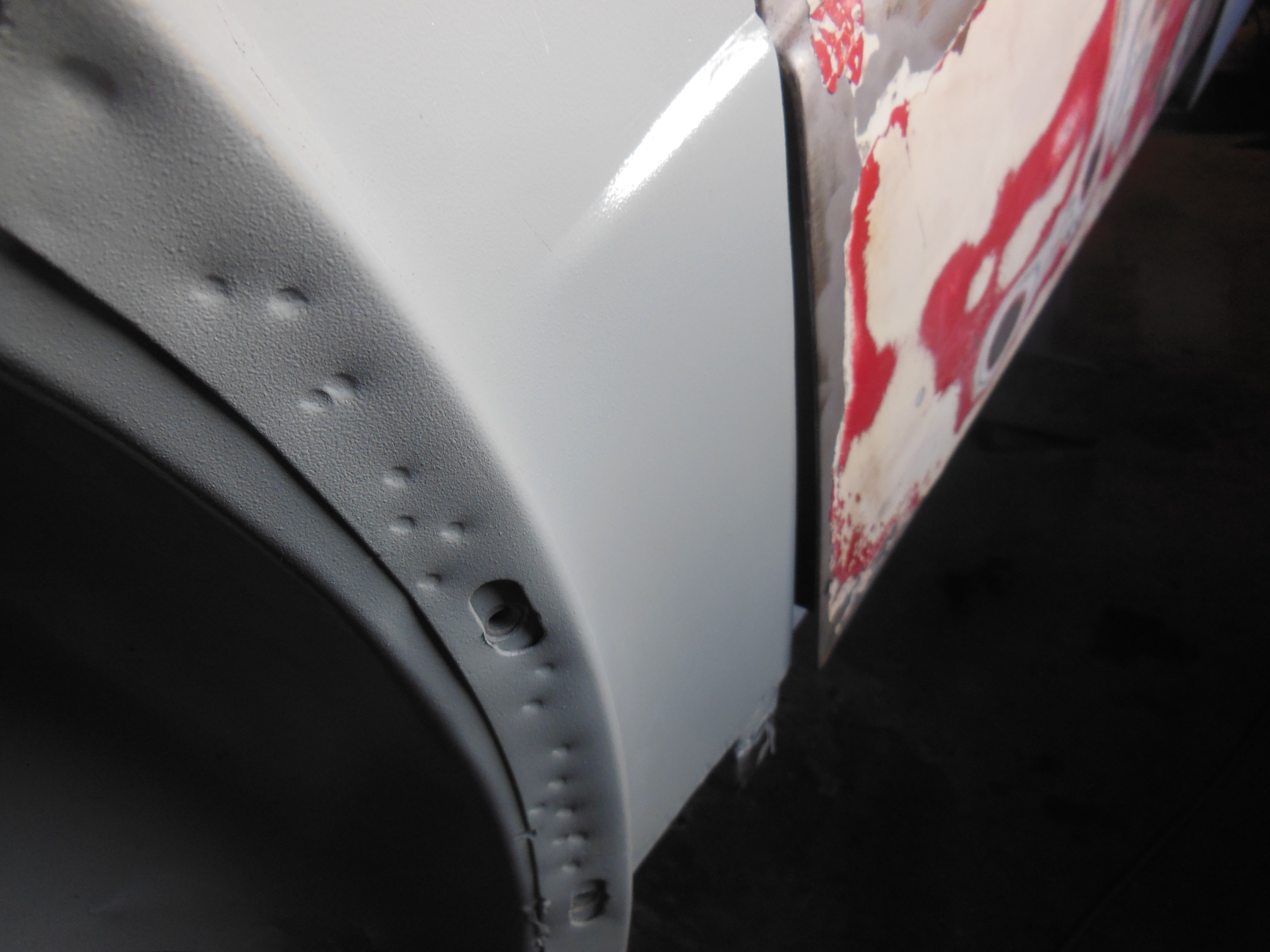

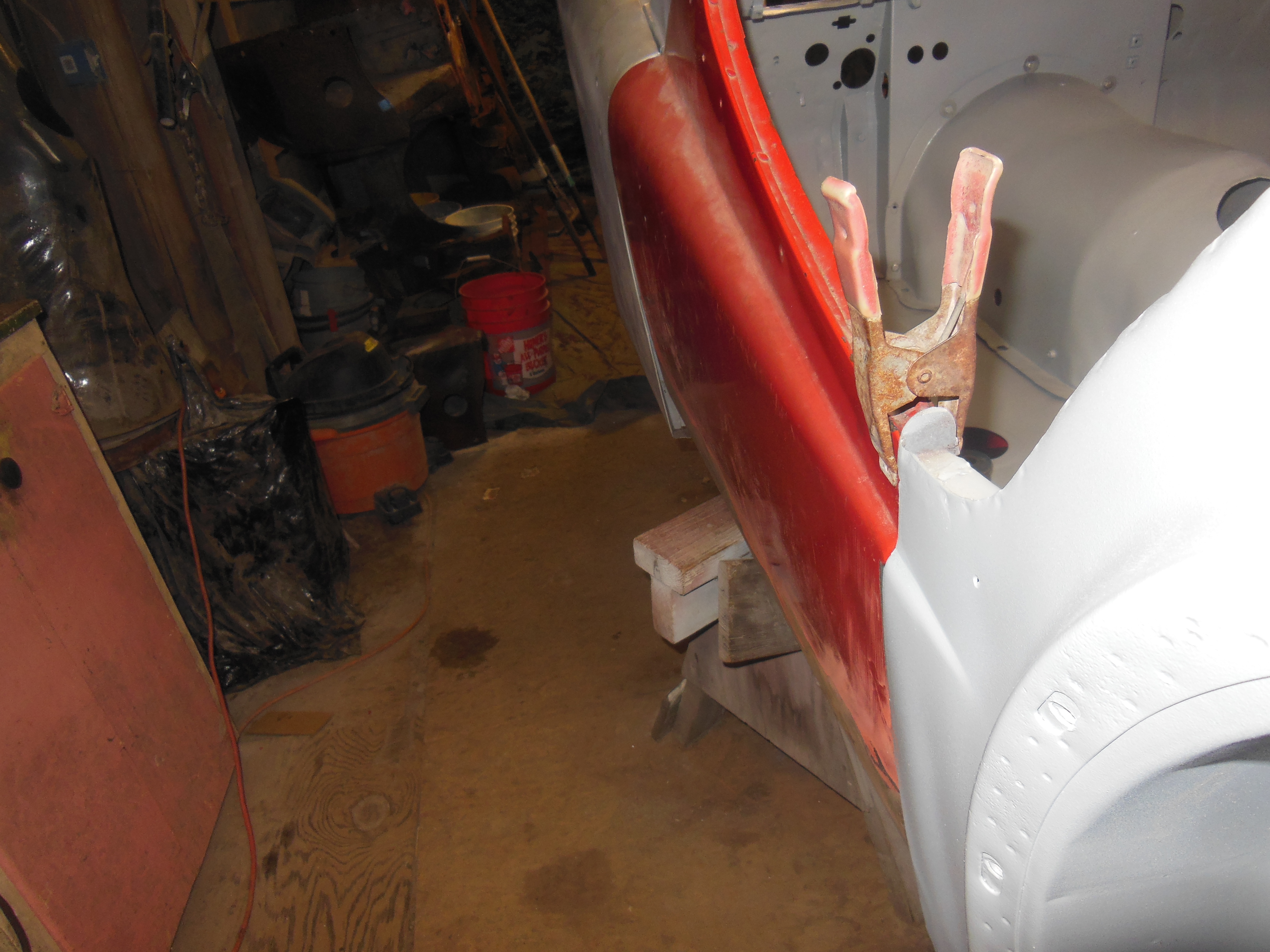

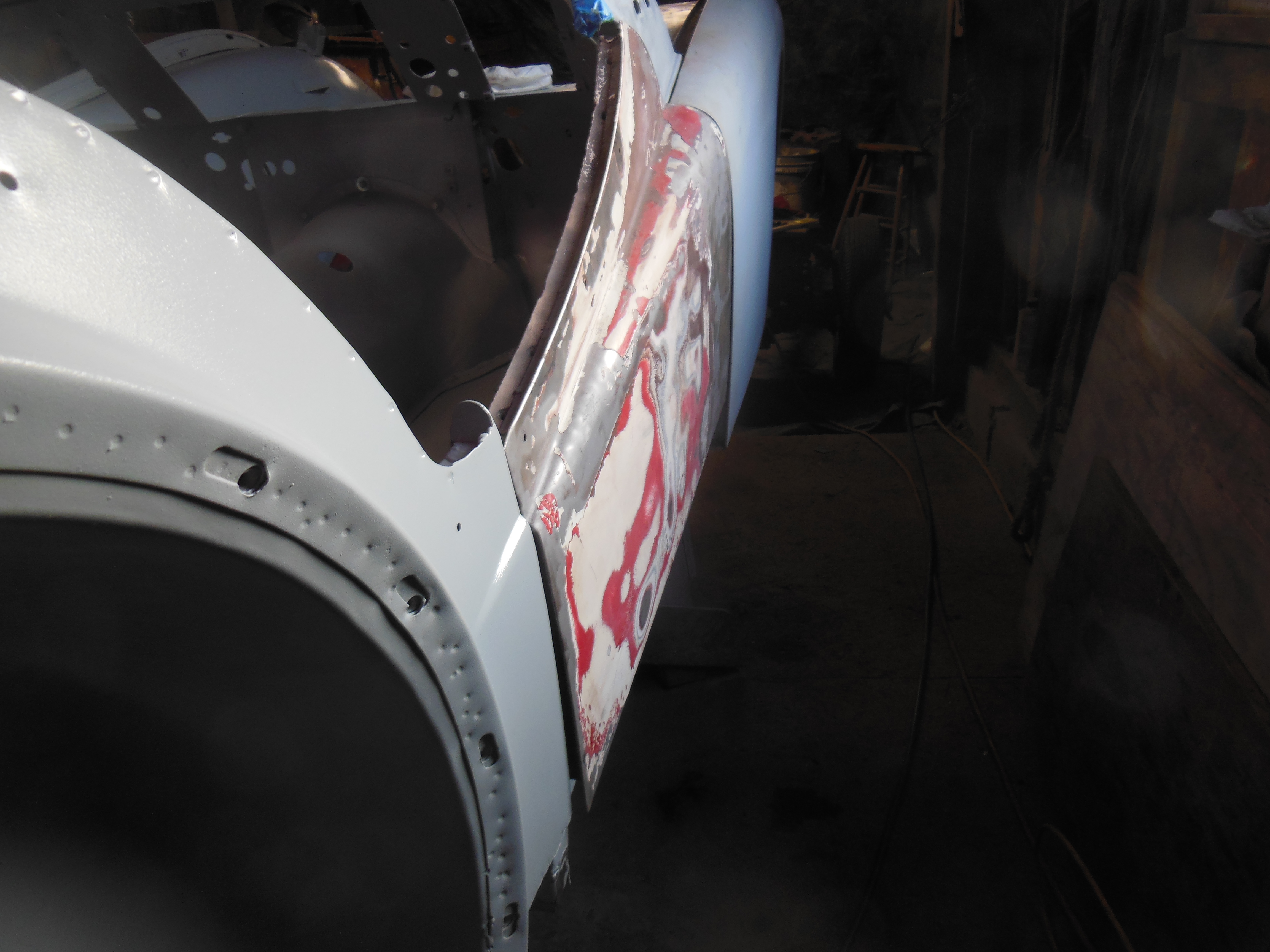

Here are some shots of my tr2 project. The pictures of the passenger door show how the door does not come in enough at the bottom and does come in at the top. The revel gaps are good enough for me, and they can be fine-tuned, but I need the door to come in some
What I am trying to do is bend and twist the door so as to make it huge the jam better. I have put some tr3A doors on and they fit very nice, so the problem is in the door.
I could plug the door handle hole and use a tr3A door, but I would rather not. So anyone have any ideas on how to get the door to fit better.

I'm afraid it's not an easy fix...sorry?!?
It's best to not attach any sheet metal to the body until you get a pre-fit of the doors. The rear quarter has some adjustment, but I see it is already tack welded. The scuttle has almost no adjustability. So...
The easiest fix I see is to pop the door skin away where it folds over the inner door frame. This breaks the box of the door that gives it stiffness. You can then work the frame to the required curvature, and then capture it by locking the skin back down to it. It sounds severe, but I never had any luck trying to bend a finished door...they are amazingly stiff.
John, to my eyes it looks like the door frame is twisted as if holding it by the A-pilar side in right hand and B-Pilar in left hand, and rotating right hand back toward you and left hand away.
I know the TR2 and early 3 doors have basically no stucture at the top compared to the later all metal TR3A doors. A block of wood a the top of the B-Pilar between the door and the post, and a good push at the bottom of the door at the B-pilar woudn't move that TR2 door twist a enough?
When I started working on my TR3A the passenger side door looked very much like yours. I tried bending the door with no avail. So I looked at the inner structure of the door and realized that the inner structure would not allow the reshaping of the outer door. At least in its existing configuration. But I did identify a spot in the inner structure where I could make a cut to remove material to allow the outer shell to bend. That is what I did, I removed/ cut a wedge of material until I could bend the outer door to match the adjacent body. Then I welded the inner structure in that position.

You would think the door would twist...but that is not the case. The inner door frame alone, and the door skin alone, are very flexible and can be easily twisted any way you need them to twist. But, once they are joined, it becomes a reinforced "box" structure. I'm not saying it can't be twisted...just that it takes a LOT of force to do it. I chickened out before achieving any more than about 1/8" of twist. As Charley pointed out, you must "break" the box to make an adjustment. He figured out a place to make a cut to break it. I preferred to part the skin. Once the skin is off, the frame will easily bend to conform to the scuttle, front wing, and quarter panels. You must leave about 1/8" space to allow for the skin addition. Once the Frame is good, then the skin can be easily tacked back on while maintaining the door's shape. Once it is fully tacked, then you can reweld...or re-crimp the skin, locking the shape forever.
