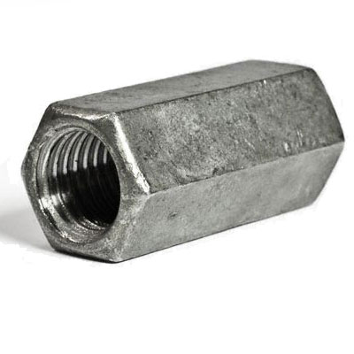

After years of tightening the nut on the door check, the threads on both sides wore out. I replaced the worn bolts with both a standard thread for the left door and a left hand thread for the right door. Rather than use the standard height nuts, I purchased coupling nuts (both left and right hand threads) and use those. My thought was that the coupling nuts had more threads which would spread the load over a larger part of the bolts and lessen the chance the bolt would strip. I made the change about ten years ago and they still work well.
Here's a photo of a coupling nut.

Steve, My Healey is presently in 14 boxes in the rafters of my garage. The only difference between the standard door check and what I did was the substitution of the coupling nut. Like I said, I made the bolts a little longer that standard, but I think you could replace the standard nuts with the coupling nuts on an OEM door check and get the benefit of having more threads.

I can see how the threads would wear with cycles, and the friction device also. The longer coupling nuts would share the load better and increase thread life.
