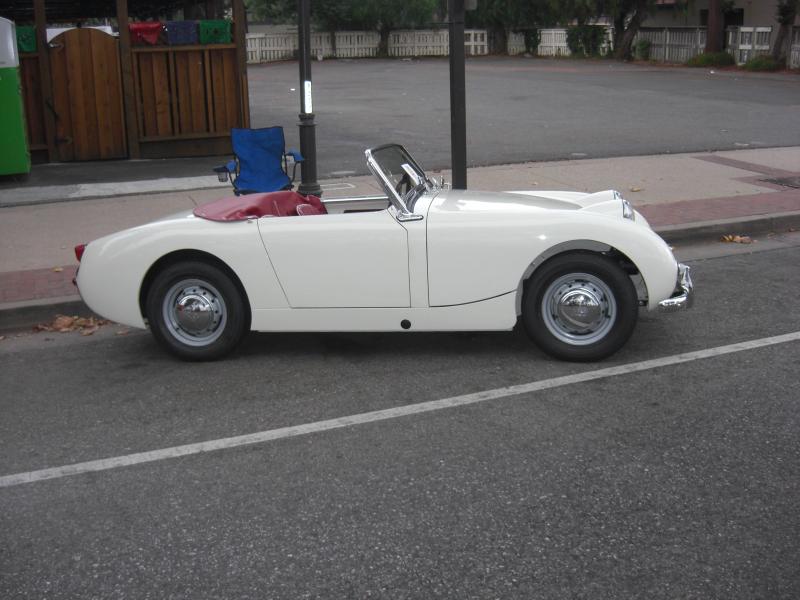

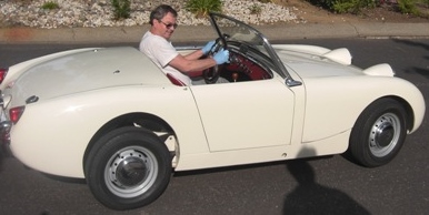

Don't even think about a set of "new" springs for the back.......They jack the car up to the sky. I had a set that was provided when I bought my 60Frog. Put them in once...too high....took them out....took some of the leaves out.....too high....took then out....put the original ones in.....binko....just right. Do U know what a pain it is to remove the rear springs....I was so glad I found something that worked and I didn't have to buy anything.
Cheers, Scott in CA
