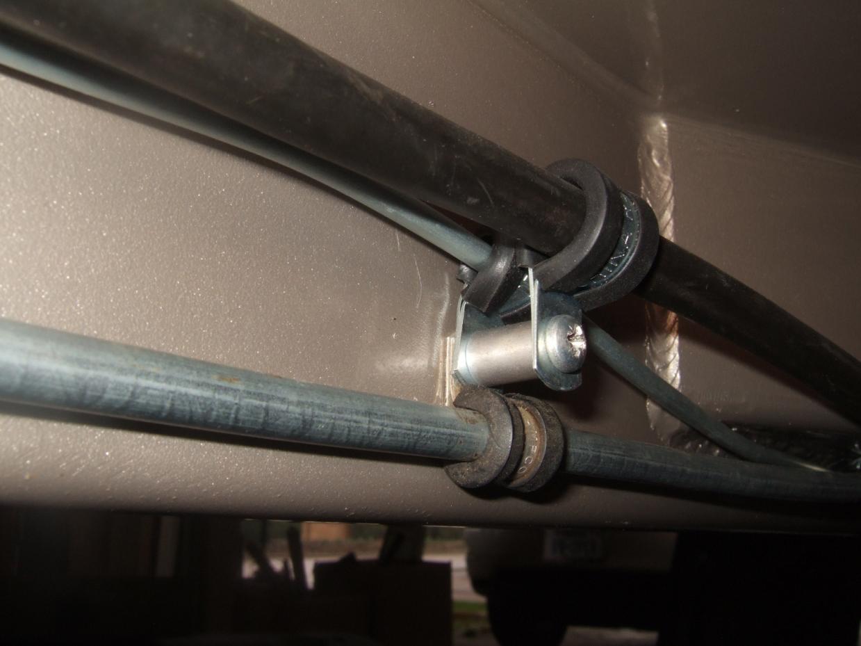

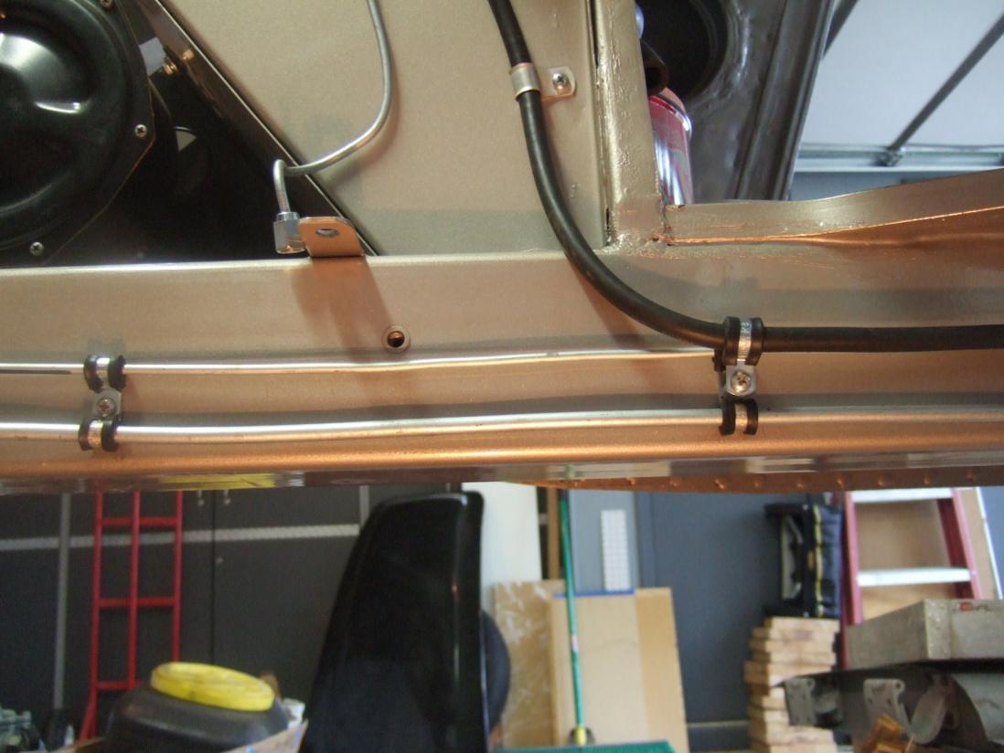

While doing my frame-up I decided to install "aircraft style Adel clamps" to insulate brake, fuel and battery cable better than the original metal P-clamps. I noticed during the dismantle that a few of the P-clamps had really rubbed the metal brake lines in a couple of places. I believe the Adel style clamps will best help protect against line and cable failure in the long run.
