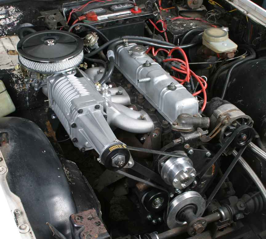

A couple of other points 4U - as you know the diff is going to be marginal at (say) 200hp. You might want to consider strengthening the mounts when you pull it if you do the LSD. I put (or actually paid to have put) a ton of extra metal in there.
Also think about con-rods if you start an upgrade for that sort of power (and nitriding/cryoing the crank and and and).
A couple of alternative suggestions I'd offer would be to consider either a supercharger conversion or go to tbi.
Both are going to be around the price of the PRI offering, and offer some flexibility for extra oomph.
You could even (if you are feeling adventurous) combine the two, but you'll have some work to do on the fuel delivery system. You do have the potential for really big power then, while still keeping a "stock" TR6 engine.
I'm not trying to talk you out of carbs by any means - I meant it when I said I wanted to see dyno #s for them, I'm just trying to give you a couple of other considerations.
