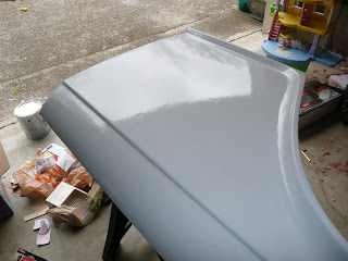

Here is the TEST fender with two coats of primer and one coat of Rustoleum Pro Gloss White. I started with a mix of 8oz paint, 4oz Penetrol and 4oz thinner. I ended up adding more penetrol. I had alot of bubbles and was afraid to wait for them to "pop" so I took a foam brush and lightly "tipped" teh surface. I am happy with it considering its my very first coat.

i managed to get a second coat on late last night. i'll do some sanding today (Sat) and maybe a 3rd coat tonight or in the AM. I can say that prep will be everything when I get to the car itself. you need a smooth even surface of since the paint is so thin it doesn't "build up" or fill in small imperfections as much as I had hoped.

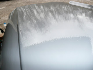

i sanded with 600 wet paper after the second top coat cured. i may have gotten to aggressive along the ridge/flare above the wheel well and got thru the paint back to bare metal in a small spot. after cleaning evrything off and wiping down with the tack cloth i applied the third coat. i'm not sure what changed since i was using the same bacth of paint as before but this time the bubbles were EVERYWHERE and they wern't going away. i took my 2" foam brush, got some penetrol on it and tipped the whole surface...it was SMOOTH AS GLASS! i was so excited that i went over everything a second time with the penetrol...too much of a good thing as they say. the penetrol began to pool along the fender contours. i had to use a clean nearly dry foam brush to pull the penetrol out and off. it still is smoother than the first coats although its taking longer to cure.
lesson learned - i am going to reduce the paint thinner in my original mix and increase the penetrol. i am thinking 50% paint, 35% penetrol and 15% thinner and only if needed tipping with the penetrol dampened foam brush ONCE if needed.
