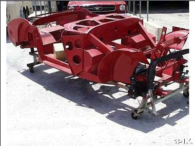

The Healey with it's semi uni-body construction is considerably more rigid than separate frame-body designs. Some of the other un-named brands with separate frame-body construction are notorious for chassis flexing. When one end is jacked up the doors will bind so that they can't even be opened.

If a car passes the corner jacking test it is unlikely to have serious underbody-frame weakening. The only "real" cure for flexing is to remove the body panels & most everything else & replace the structural members with new metal.

ATTACHED is a pic of a Healey chassis. All of the parts shown are welded into one piece. The body panels are mostly just hung on this structure & don't contribute much to overall rigidity.
