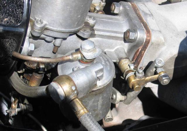

So, it's running nice and smooooooth now. What's with the high idle situation??
IT'S ___ THE ___ LINKAGE !!!!!!
So I've got the timing set to 4BTDC. Idle was back to 1200rpm when throttle screw was full out.
Punched the throttle and opened up to around 2500. Let it drop - back to 1500, then slowly to 1200.
As many of you suggested long ago - Tom - check the throttle linkage.
So I watched the tach as I pulled *up* on the pedal.
Idle dropped to 600 and stayed there. STAYED THERE!
The problem is somewhere in the linkage. I've wiggled all the joints and sprayed silicone lube. Much better, dropping now back to around 800, but there's some bindup somewhere in that box over the tranny hump where the gas pedal horizontal link (at the pedal) goes into. Still another slight rpm drop when I pull that pedal up.

I probably should have mentioned this before ... Don't crank down too hard on the pinch bolt ! The dizzy casting is fragile and it's easy for the clamp to crush it.
Just a thought about your linkage binding; on mine the little round pivots were worn so egg-shaped that they would bind.
Re: IT'S ___ THE ___ LINKAGE !!!!!!
Randall - thanks for the pinch bolt warning. I went right to the garage and loosened the bolt one turn (man, talk about paranoid ...).
I'd bet the round pivots on my linkage are really worn. Is pulling the linkage assembly one of those "you should only do it as a last resort" things? Or is it relatively straightforward without risking destruction of things? I'm thinking primarily of the "pedal through the firewall" part, as well as that vertical linkrod.
Thanks.
Tom
Leave the ones that are on the car and order some new ones. Most suppliers have the full rods and end bits. Then when you get the new ones, change them. No point pulling them apart now and not having any driving fun for two weeks.
It's been a long time, but I don't recall any drama with the linkage pivots. There should be a piece of lockwire through the slot on the end that you'll have to remove, then unscrew the slot a few turns so you can pull the rod end off the ball and see what it looks like. It's best if you don't undo the screw all the way, but if you do, be sure to hunt down the spring and distance piece that will fall out (as well as the screw itself).
Don't recall for sure now, but the flats on the balls might be a Whitworth size. I just used a small Crescent wrench on mine.
I've never done the "pedal through the firewall" bit myself; but from what I've heard, it's significantly more difficult. Honestly, I don't see how it could bind either, unless the rod is so badly bent that it hits the body when it turns.

Tom, I think you're probably on the right path; but wanted to mention another possible bind to watch for. At one time, my carb bushings were so worn that the throttle plates would bind on the bores. The front bushing of the front carb was the worst offender, but they were all pretty bad.
You may be able to restore smooth linkage action by rotating the 'ball' of the linkage 90 degrees. I did this by introducing a thin washer under the ball's hex end. In my case the linkage would sometimes pop out under full throttle... not any more.
