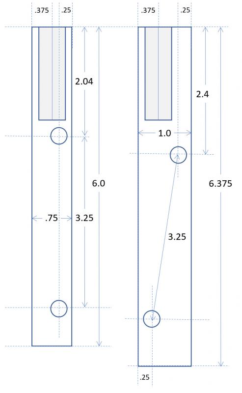

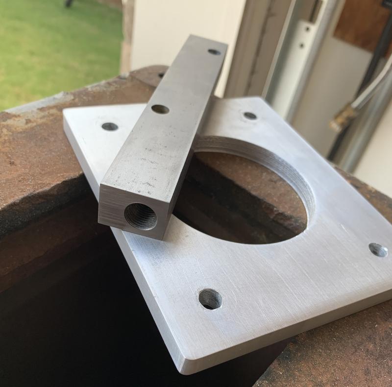

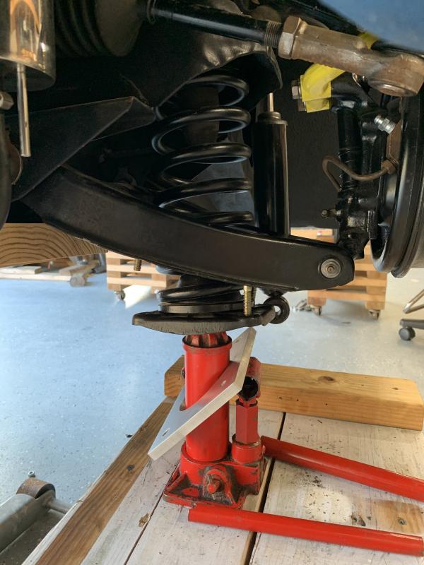

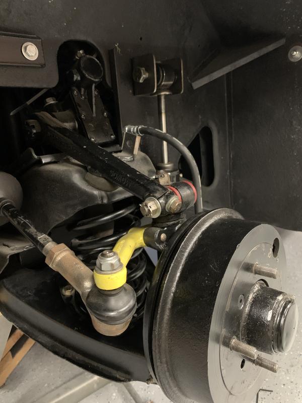

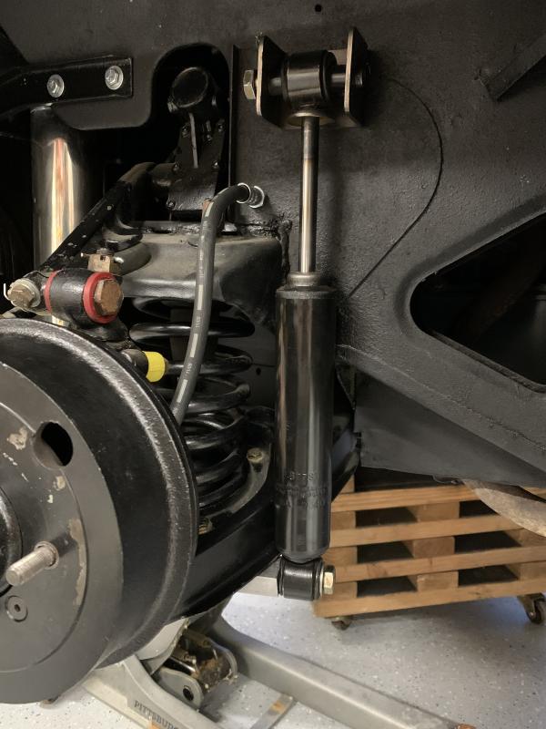

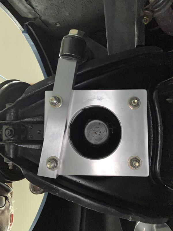

Very belated update. I finally got around to implementing Nial's tube shock conversion a couple years ago. It worked great but the shocks rubbed on the tires at about a 1/4 turn of the steering wheel before the end of the rack travel. I finally addressed that this week.
My car has the original 13" steel wheels with 155/80 tires. I think Nial's car had 14" alloy wheels. I had to move the shock about 1/4" closer to the car to get clearance. His shock mount was made out of 3/4" x 3/4" steel bar. I could only find 1" x 3/4" steel bar. I offset the mounting holes to pivot the shock away from the tire. See drawings and pics attached.
front-shock-mouint.jpg IMG_0480.jpg IMG_0482.jpg IMG_0483.jpg IMG_0484.jpg IMG_0485.jpg
With the 1" bar, that's the most offset I could get. At full lock on the steering rack it still slightly rubs, but it is much better than before.
