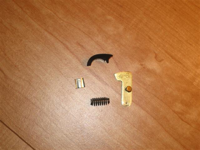

Here's a photo of the loose parts that I found inside. Notice how little of the bakelite rotor body is present--does this stuff spontaneously combust?

HI Michael, I can't imagine where that extra spring came from.Regarding the Vac/Advance unit there is someone here in the US rebuilding them for about $100.00 I looked in my file but could not locate who or where they are. Maybe some of the usual suspects know who is doing them.---Fwiw---Keoke
[ QUOTE ]
HI Michael, I can't imagine where that extra spring came from.Keoke
[/ QUOTE ]
Someone has suggested that it goes under the lube knob.
