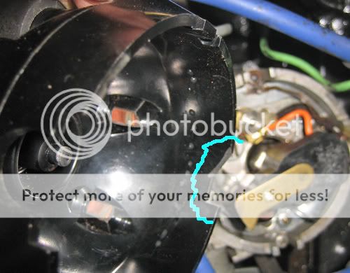

My new distributor cap has 183 miles on it. It arrived from
the vendor broken as shown but seems to work OK.

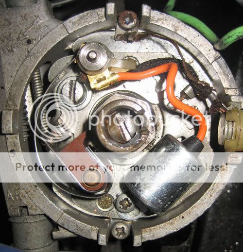

My advanced Distributors dizzy has about 1700 miles, the points
have about 1500 miles and the condensor can has 74 miles on it.

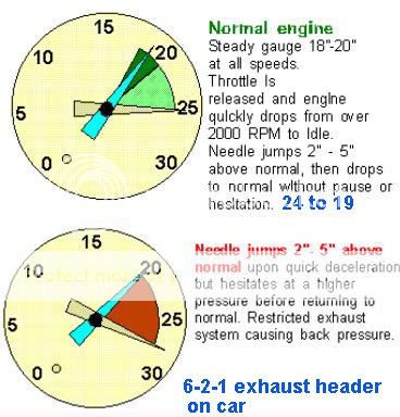

I also performed intake manifold vacuum testing today.
Here are my results: My carbs and manifold have 1700 miles.
Jeff Palya's all components.
A warm idle, steady as a rock at 19 inches- no flicker at all.
A rise to 24" at 2000 rpm and then a uniform downward flow to 19 inches but NOT instantly back to 19". I have a 6-3-1 header.
This is ALL good news, Dale. All 'cept th' broken cap bit. Non-critical, tho. Jus' don't go charging thru any standing water at speed. :wink:

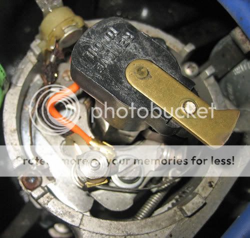

From the dizzy photo I may make one eensie suggestion: see if you can coax the bare ground wire away from proximity to the lead goin' to th' points from the white connector. It makes me nervous.
Thanks.
I noticed the ground wire too. Do I detect a bit of rust, er, I mean corrosion at the screw and possibly along the wire in addition to what you saw, Doc? Other threads have mentioned this ground wire as a potential cause of woes. I am not trying to fix something that's not broken, just making an observation.
WOO HOO!!! Dale, I am sending an email to Mayor Daley to see if we can get you a parade!! :laugh:
Surface rust on that screw, naught to worry over. More concerning is the ground's proximity to that points trigger wire.

<span style="color: #006600">Bloody Ground Wires!
They have been a curse on this car since day one!
I use this green goo stuff on all the electrical connections of
my boat and wiring of my trailer. The green goo dries into a water
tight plastic.
Should I green goo the ground wire and points trigger wire?
It would be easy.
d</span>

It has made it 38 years without the green goop. Just clean it up and don't start putting stuff in there.
Also, add two drops of 3 in 1 oil down inside the distributor shaft, on the screw under the rotor, if you haven't already done so lately.

Dale, I wouldn't apply any insulating coating to any of the components in the dizzy. What all of us seemed to notice was the bare wire from the dizzy housing to the breaker plate runs very close to the end of the points trigger wire where it passes out of the distributor. Just re-route the breaker plate ground wire a little to avoid the trigger wire. As for the screw corrosion, a little ScotchBrite and the application of some dielectric grease or Vaseline to the cleaned surfaces will help without locking things permanently together.
