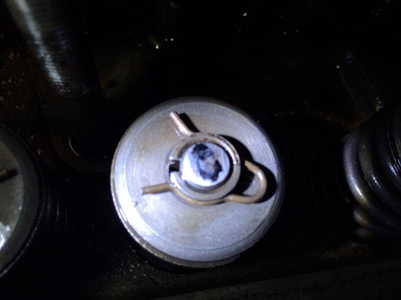

I took off the rocker assembly and some of the rocker pads (at the valve stem) had erosion. I remounted everything and did a valve adjust, and no matter how tight I made those valves, I could not get the noise to change. So while I still think it is valve train related, I cannot figure this one out.

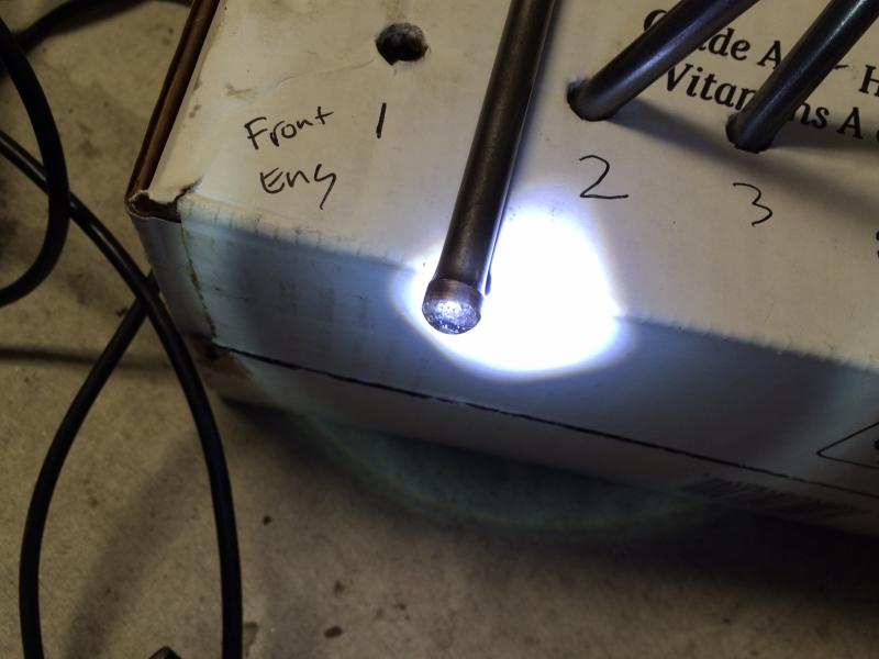

I removed and inspected all the pushrods. They are all straight. None have any damage at the rocker end. All have small amounts of erosion at the cam end.

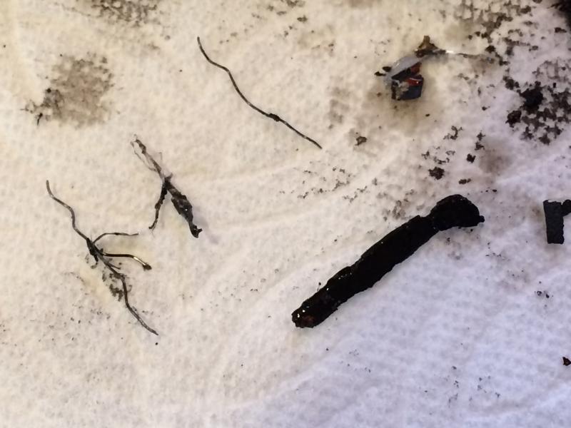

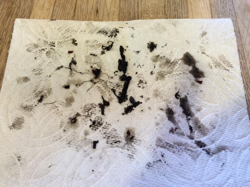

I took off the oil pan. That was fun. There are several small metallic shards/wires in it and a couple larger chunks of black maybe rust-like material. And lots of little silver and/or reddish flakes.

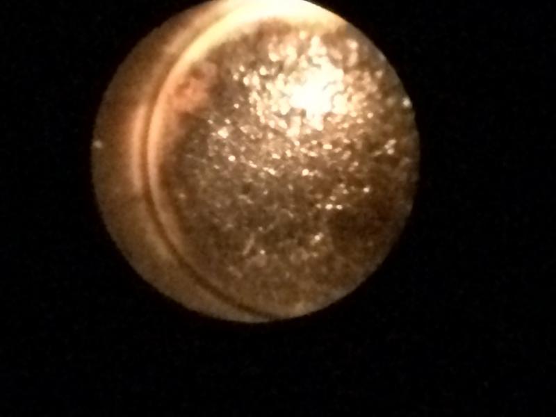

I will post some pictures in case anyone is interested. The piston faces appear really rough, almost like they are rusty, but that makes no sense since I believe they are aluminum.

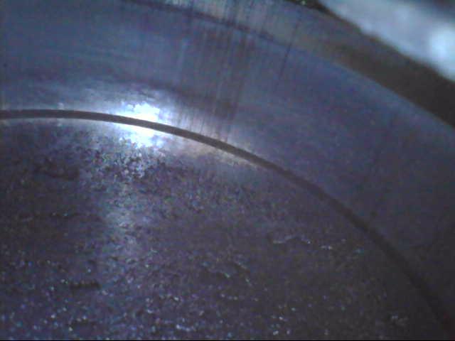

Here is a pic with my cheapo USB borescope. You can see the roughness of the piston face, as well as some scoring on the cylinder walls. Wonder if it is piston slap? The noise is most noticable at idle. I tried to blip the throttle to see if it goes away under load. And it is true that you hear it much less when the engine is above idle, but it may just be other engine noises drown out the knock. I guess my point is, I don't know if the noise goes away when you blip the throttle, or if the other noises just increase in volume and overwhelm the knock.

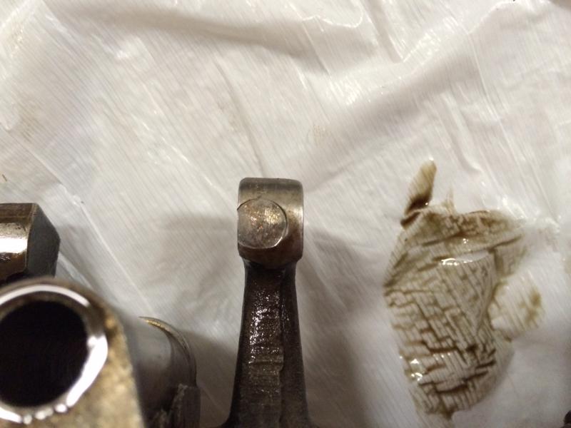

Also, here is the junk from the bottom of the oil pan. It is sitting on a paper towel folded twice. So the largest chunk of material is about in inch long. Much of it is magnetic, including those little wirey strands. Any ideas what that sort of material suggests has happened to the engine?
Those push rods are junk and the cam/tappets are probably damaged to . The wire is probably from a wire wheel used by the so called mechanic who did the botch job . Basically your looking at a full engine overhaul to check everything .
You will be replacing pushrods and grinding the camshaft replacing tappets and more than likely replacing most of the valve train at a minimum . While it's apart you will need to check the crank bearings Pistons rings etc and decide if they are useable or not . And don't forget to either overhaul the oil pump or replace it as obviously you had oil pressure problems that started the downward spiral in the first place .
First, I have never seen anything like those metal pieces in your oil pan. It looks like scrap that came from some place other than from engine internals. Secondly, the rusty looking stuff on the tops of your pistons looks like carbon buildup. And that rocker is ........seriously horribly worn. And is that a photo of a pushrod tip? ... OMG. No way was this a rebuilt motor with only 200 miles on it.

Thanks everyone for your amazing help. I didn't expect so many answers so quickly. I checked the appearance of those wire strands from the oil sump and they are not the same as the strainer. But they are clearly man-made as their bend pattern is repetitive. I think the wire wheel hypothesis is dead on.

Though the junk in the sump is somewhat disconcerting I would not attach any particular significance to any of the detritus. Without knowing the engine's history many things are possible including someone's having tapped some threaded holes with parts in situ resulting in the metallic shards making their way into the oil pan. Or just plain sloppiness on someone's part.
Finding such metallic junk in the oil filter would be much more of a concern and I would recommend that you get into the habit of cutting apart your oil filter on each change and examining the filter medium for shiny flakes (bearing material) and small bits which could be anything from broken piston rings to parts of the valve train, etc.
