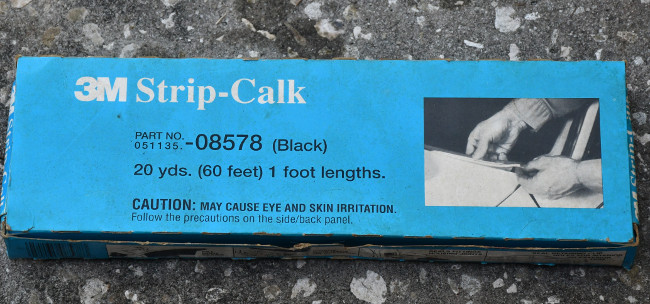

Was shown this decades ago by the parts manager at the Alfa-Lotus dealership. He'd been a Marine who survived Inchon.
A small piece in a socket or the end of a screwdriver. He called it his "Aluminum Magnet."
A lifetime supply:
