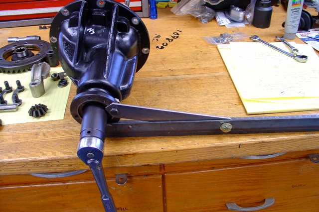

You need a long steel bar that you can secure to two of the bolt holes. It needs to be long enough to be braced against your floor. It can be braced against the chassis, but I prefer to use the ground. A long piece of Superstrut/Unistrut works well, but some flat bar stock or angle iron will work too.
Even using a single hole with the bar leveraged against your socket will work.
Here's another approach - pic from the MGE library.
