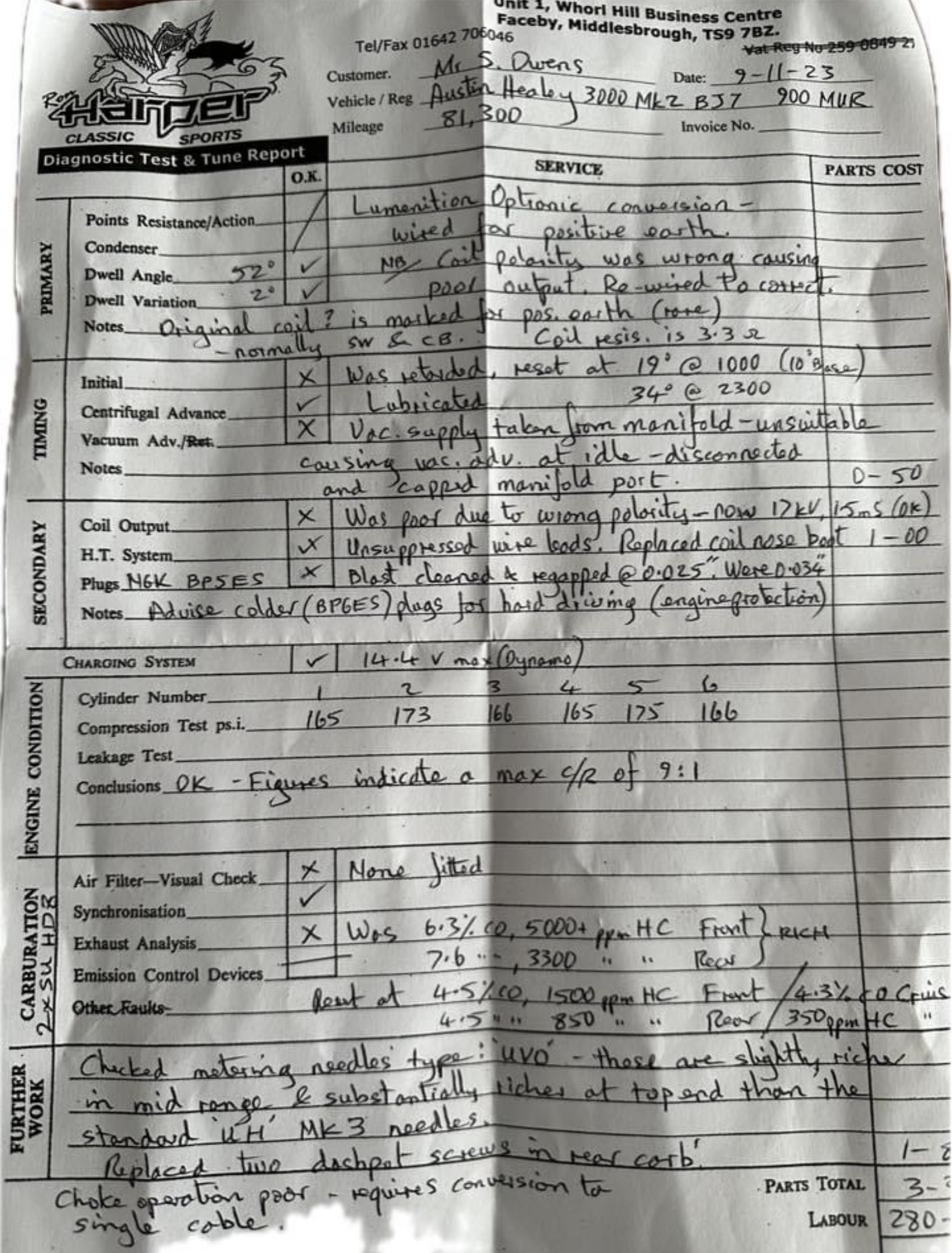

I found this on a FB forum that a Healey owner posted for everyone to see the details and what was done to his car. He was happy with how much better his car ran after this mechanic worked on it. What are your thoughts on what he found and his corrections?

I'm used to seeing,and in fact writing summaries like this but I was a helicopter mechanic and they were work orders for the airframes and engines. Everyone who farms out their maintenance should be so lucky to find people who are that detail oriented and knowledgeable. It also makes it much easier to pay the bill when folks are providing service like that.

I agree with you on work orders like this!
I was an Navy Aircraft Electrician and we occasional had do full write ups.
